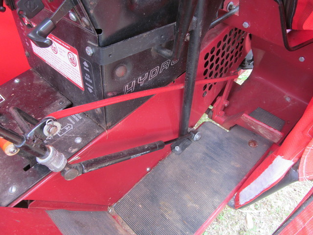

Phatboy 566 #1 Posted March 22, 2016 (edited) Can anyone tell me if by taking off the black plactic belt cover help with rear cylinder cooling on the 20 hp onan ? Or not i wanna know , cause if it helps im gonna take off if not im gonna leave it on,, i cant bring myself to drill holes in the red metal belt guard so i wanna do what i can to help cool rear cylinder if removing that definatly helps cooling rear cylinder off it comes !! Edited March 22, 2016 by Phatboy Share this post Link to post Share on other sites
N3PUY 1,031 #2 Posted March 22, 2016 It's the belt guard that stops the air flow. Drill some nice holes. 1 Share this post Link to post Share on other sites
Ed Kennell 47,820 #3 Posted March 23, 2016 (edited) Pick up another belt guard at the show and drill it. Edited March 23, 2016 by Ed Kennell 2 1 Share this post Link to post Share on other sites

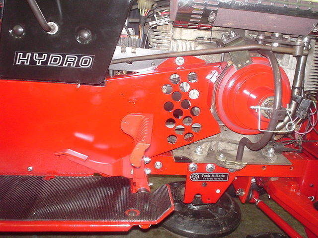

cleat 9,405 #7 Posted March 23, 2016 (edited) I would think an air cooled engine could overheat in way under an hour if worked hard in hot weather with inadequate cooling. That said, I got all of my Onans well used with all the factory covers in place (mine did not ever have the plastic cover) and all run well so they lived for years that way with no ill effects. I have drilled the belt covers on all of them just for my peace of mind but may not really be required. Likely more important to keep the inlet screen over the flywheel clean. That seems to be more of a problem with smaller decks. My 42" deck is terrible and I need to clear that screen very often, the 48" deck seldom clogs it and the 60" deck on a 520 does not seem to put any grass whatsoever on the screen. Edited March 23, 2016 by cleat 5 Share this post Link to post Share on other sites

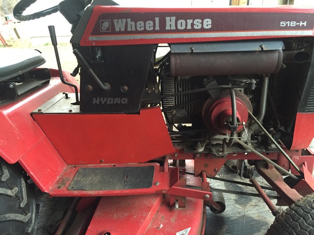

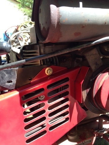

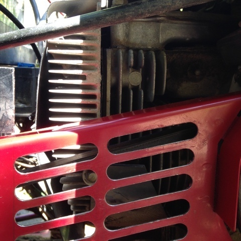

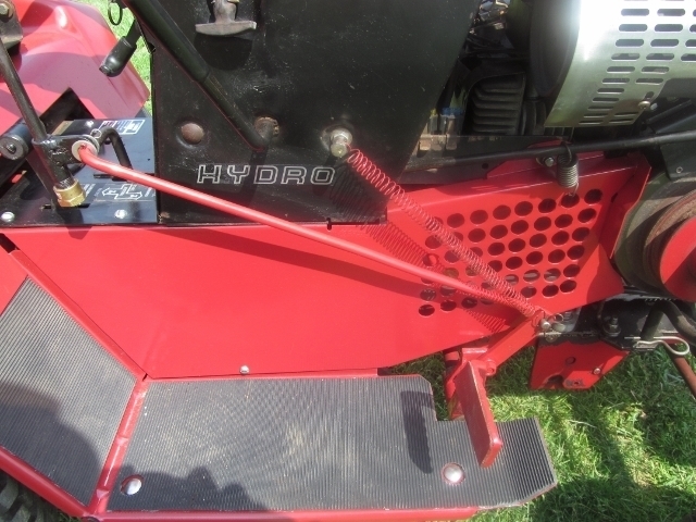

JAinVA 4,638 #8 Posted March 23, 2016 Drilling holes in the belts guard definitely improves airflow, but if you want to maximize airflow remove the front portion of the belt guard brace & attachment ear. As you can see from the photographs, once these parts are removed how easily it is to see any stoppages in the cooling fins. Luck, JAinVA JimAnderson Gloucester, VA 4 Share this post Link to post Share on other sites
Phatboy 566 #9 Posted March 23, 2016 17 minutes ago, JAinVA said: Drilling holes in the belts guard definitely improves airflow, but if you want to maximize airflow remove the front portion of the belt guard brace & attachment ear. As you can see from the photographs, once these parts are removed how easily it is to see any stoppages in the cooling fins. Luck, JAinVA JimAnderson Gloucester, VA I like the way you cut yours janiva now all i have to do is find someone to do that for me haha... I dont know what you mean by ears and front part of attachment tho ,, ya mean the black brace behind belt guard ? Im going oit to the garage now to see if i cam figure out what ya mean.. Share this post Link to post Share on other sites
wrightorchid 261 #10 Posted March 23, 2016 Great mods. Looks like they came that way from the factory! Share this post Link to post Share on other sites

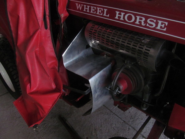

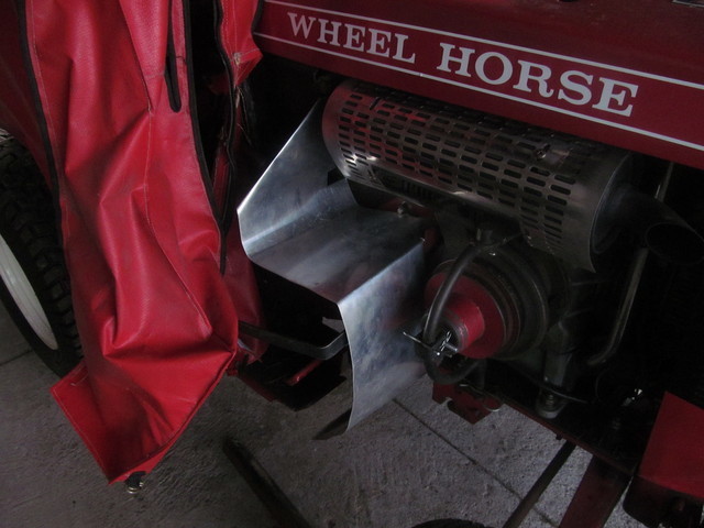

Bert 805 #11 Posted March 23, 2016 (edited) 1 hour ago, JAinVA said: Drilling holes in the belts guard definitely improves airflow, but if you want to maximize airflow remove the front portion of the belt guard brace & attachment ear. As you can see from the photographs, once these parts are removed how easily it is to see any stoppages in the cooling fins. Luck, JAinVA JimAnderson Gloucester, VA The guard brace is something worth removing in my opinion. It blocks a lot of air flow. I did a little more cutting on mine and have run a 60 inch deck for over four hours in the blistering southern heat without the engine showing any signs of being overly hot Edited March 23, 2016 by Bert 2 Share this post Link to post Share on other sites
JAinVA 4,638 #12 Posted March 23, 2016 Phatboy, In the second photo the guard brace and guard ear are visible.The guard is held in place by the shiny nut and washer.In the first picture these parts are missing.The guard brace still has an elongated slot where an angle clip can be installed to secure the upper part of the belt guard if needed.JAinVA JimAnderson Gloucester,Va Share this post Link to post Share on other sites
Phatboy 566 #13 Posted March 23, 2016 4 hours ago, JAinVA said: Phatboy, In the second photo the guard brace and guard ear are visible.The guard is held in place by the shiny nut and washer.In the first picture these parts are missing.The guard brace still has an elongated slot where an angle clip can be installed to secure the upper part of the belt guard if needed.JAinVA JimAnderson Gloucester,Va Aahhh i see what ya mean JAinVA,,, yea that black brace alone would create a bunch more air flow if removed ,,, heck if i at least do that that would definatly cut down on alot of heat all by itself ,, thanks for the pics buddy and explanation ,, it really helped alot !!! Share this post Link to post Share on other sites
JAinVA 4,638 #14 Posted March 23, 2016 (edited) Phatboy, Glad to help out.If you look closely at the picture Bert posted you will notice that the lower shroud actually routes the cooling air up wards.I believe that removing the brace front and belt guard ear do more to increase airflow than all the holes in the belt guard.I didn't realize this until I had milled the slots in the guard.Berts mod definitely gives max airflow.JAinVA JimAnderson Gloucester,Va Edited March 24, 2016 by JAinVA 2 Share this post Link to post Share on other sites

cleat 9,405 #16 Posted March 24, 2016 9 hours ago, Bert said: The guard brace is something worth removing in my opinion. It blocks a lot of air flow. I did a little more cutting on mine and have run a 60 inch deck for over four hours in the blistering southern heat without the engine showing any signs of being overly hot Wow, nothing blocking the air here. Does the guard seem solid still at the top front ? 1 Share this post Link to post Share on other sites
JAinVA 4,638 #17 Posted March 24, 2016 Bert, I don't mean to hi-jack the thread but does your 518 have the gear reduction steering? I see it has the swept forward axle but I thought 518s had straight front axles so I'm curious.JAinVA 1 Share this post Link to post Share on other sites
Bert 805 #18 Posted March 24, 2016 18 hours ago, JAinVA said: 8 hours ago, cleat said: Wow, nothing blocking the air here. Does the guard seem solid still at the top front ? Yes very solid. I was wondering the same thing about JAinVA's mod? I'm thinking of using his idea on my 520 8 hours ago, JAinVA said: Bert, I don't mean to hi-jack the thread but does your 518 have the gear reduction steering? I see it has the swept forward axle but I thought 518s had straight front axles so I'm curious.JAinVA This is not a stock 518, it's got a 520 HC rear, lift, and front axle. I added gear reduction steering as well. It was while putting it all together that I realized that brace had to go Share this post Link to post Share on other sites
