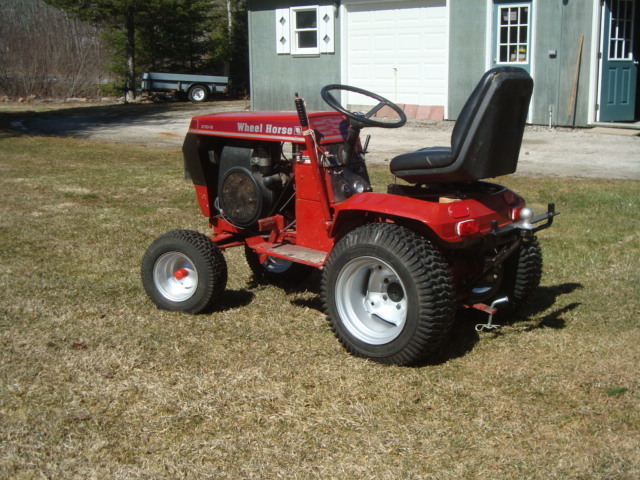

Furious 23 #1 Posted April 1, 2016 I have a 1967 1277 that's in pretty decent shape. Does anyone know if the transaxle is a limited-slip (posi) type, or just a standard differential. I was pushing some dirt the other day and found that one of the tires started to spin while the other wasn't moving. I hope I didn't break something. If it is a standard diff, any way to "lock" it? Thanks. Joel Share this post Link to post Share on other sites
stevasaurus 23,763 #2 Posted April 1, 2016 Your 1277 Automatic uses a Wheel Horse #5054 transmission. It is not a 10 pinion, limited slip differential...in fact it appears to be a bevel gear differential. That means it does not have any spider gears. I think it also means that you can not lock it. The good news is, I don't think you broke anything and your transmission acted correctly. Here is the manual... Share this post Link to post Share on other sites

Furious 23 #7 Posted April 7, 2016 So the tranny is fairly jerky when moving the control lever to forward or reverse. Once I'm moving it's smooth though. Also, it's advertised as infinite forward/reverse, but it does not like to go slow, again, it's kind of jerky. Is this normal for the old hydros or do I need to make some adjustments. I admit, I'm used to the newer hydros or manual speed transmissions in older tractors. Thanks. Share this post Link to post Share on other sites
Retired Sparky 526 #8 Posted April 7, 2016 If you can break the tire down put tubes in and get them loaded. I weighted mine the other day. 76lbs. each on the bathroom scales. You can get them loaded cheaper then you can buy bolt on weights. It keeps a clean look on the outside. Those tires are 30 years old. 1 Share this post Link to post Share on other sites
stevasaurus 23,763 #9 Posted April 7, 2016 I think I would take a look at your drive belt and drive pulleys for wear and grease and dirt. That is the 1st thing to do. Use mineral spirits to wipe the belt and clean the pulleys...DO NOT use any belt grip. The next thing is to download the manual for your tractor from the "Manuals" section and check on doing the adjustments it talks about. Also, changing the trans oil and filter may help. It is probably the belt. 2 Share this post Link to post Share on other sites
prondzy 3,889 #10 Posted April 14, 2016 If you ate having a jerky starts with you hydro this can be considered "normal" for an old tractor like yours. You may want to look at lubricating the motion lever and cam block with some silicone paste or something of that nature. It will smooth out some but unless you want to rebuild and reset up your motion control I wouldn't expect a flawless engagement. 1 Share this post Link to post Share on other sites
