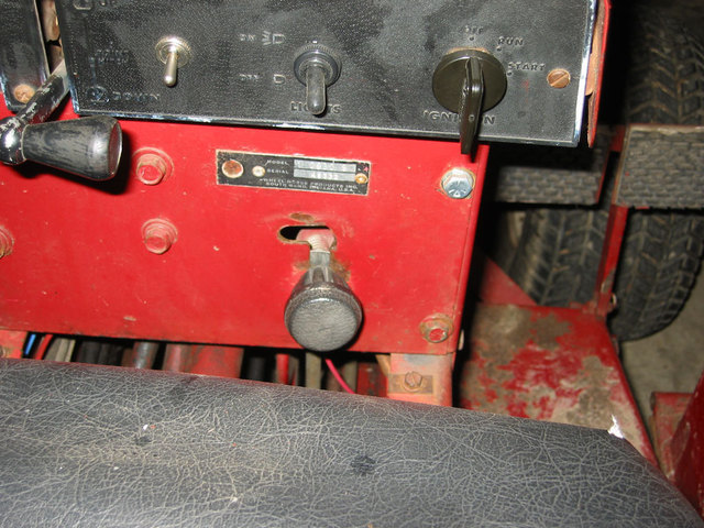

pfrederi 20,269 #2 Posted February 3, 2016 (edited) 1974 models had a different motion control linkage and no parking brake knob on the hood stand below the instrument panel. Pulling the motion control lever into the lower (i believe) slot engaged the parking pawl. 1975 and newer used the knob below the IP...however WH had left over hood stands that had the forked slot and used them. Some dealers blocked off the lower slot but no all did. mine has the slot but moving the control lever there doesn't do anything. a 1974 would not have had this knob Edited February 3, 2016 by pfrederi 1 Share this post Link to post Share on other sites

KC9KAS 4,746 #4 Posted February 3, 2016 @tractorhogg @pfrederi was saying that his picture shows the parking brake on the dash, whereas your picture shows the parking brake on the F/R motion controller. I have a 1974 D-200 and it has the parking brake on the F/R motion control lever. 1 Share this post Link to post Share on other sites
tractorhogg 652 #5 Posted February 3, 2016 I reread his post and realize what he was trying to say. Lack of accurate nomenclature, or the knowledge of said nomenclature, sometimes reduces us to using descriptive words (thig-a-ma-jig) that may mean different things to different people. However I just don't see well and I think I read things right, when I actually do not. Thanks for helping affirm what he was trying to tell me 1 Share this post Link to post Share on other sites
pfrederi 20,269 #6 Posted February 4, 2016 (edited) It would have been clearer if I also put in a picture of the motion control lever. Went through my pics and I didn't have one. My D200 is parked down in the barn for the winter and with my ruptured achilles tendon it is too far to hobble... Edited February 4, 2016 by pfrederi 1 Share this post Link to post Share on other sites
