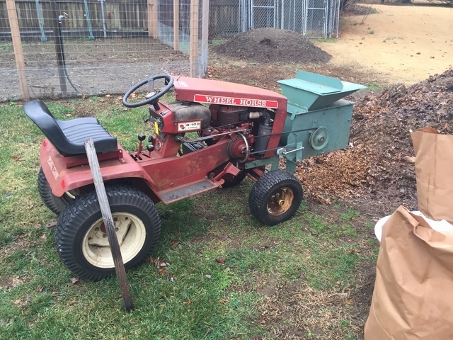

Gernzz8 38 #1 Posted January 1, 2016 Happy New Year!......I picked up my first Wheel Horse 3 Weeks ago......I Love It!! I have a 1976 B100 (61-10K802) with a a 5091 8 Speed Transmission. I have been gathering as much information as I can pertaining to my "Horse". I am having difficulty finding parts for an "Overhaul/Reseal Kit" for my Trans/Diff. No issues other than having a little water mixed in with the gear oil, due to a dry rotted/split shifter boot. I flushed it once with ATF and drained. I filled it up again with ATF and have added some Seafoam to clean and absorb water. I plan on running it a little with the ATF & Seafoam before teardown.Any help would be appreciated. All the Best, Danny Share this post Link to post Share on other sites

Gernzz8 38 #6 Posted January 2, 2016 Ya know, I was thinking the same thing. I want to "work it" for a season and see if she needs anything else before I do a once over (clean, paint, new decals, etc..) next winter. Right after picking up my Horse I found this Amerind-MacKissic 9-WH Shredder on Craigslist. What a Beast (Dangerous) They Honestly don't make machines or tools like they used to. Thank You people for all your help. Danny 2 Share this post Link to post Share on other sites
