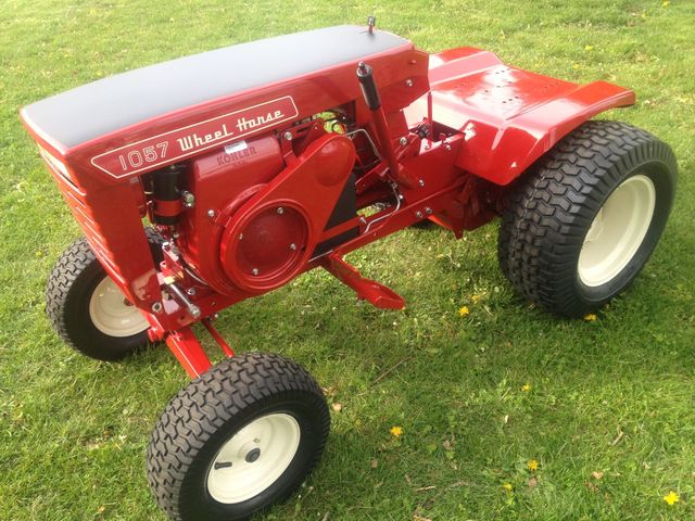

i have done this in the past but i only use brake line. The 1057 rebuild was probably the most hard line i have used on a tractor.
Just remember to use just a little rubber hose somewhere in the line or the vibration of the engine could eventually cause issues with the hard line. (I used rubber with a filter just before the pump on the engine)
The pics start about here......
http://www.wheelhorseforum.com/topic/30753-here-we-go-again-1057s-turn-now/?do=findComment&comment=279658
making the lines up isn't that difficult and they look so much neater and cleaner than rubber line.......

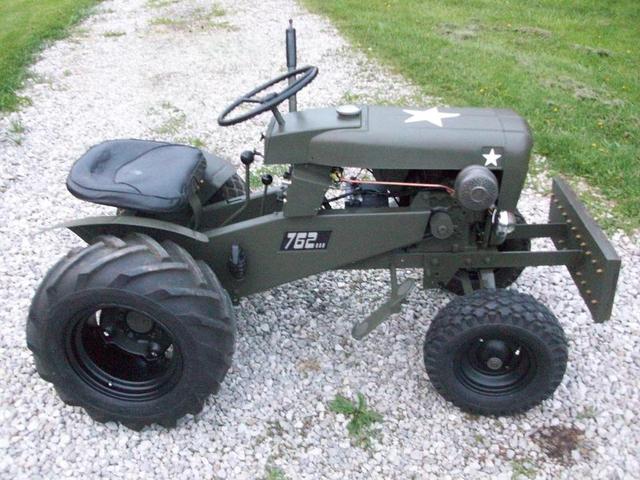

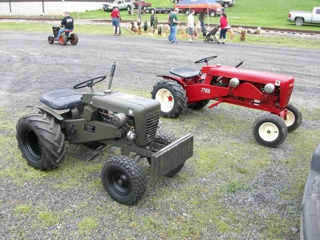

A member here name Hammerhead has this awesome army horse and he used copper hard line for the fuel if you want he has a thread about it just search army horse. I've been wanting to add hard line to my lawn ranger i think it will hold up better to the junk gas we have these days. I put all new rubber line on my sons lawn ranger last year and its already very hard and i used the good stuff and my suburban got all new line after i restored it a few years back and the line is toast on it too.

Thanks a lot Slammer for adding my Army Horse to this thread! I have the correct fuel bowl/filter set up on here too, it works great. I did away with the fuel pump on this unit since I couldn't locate a rebuild kit at the time. The copper looks great and works way better than rubber hose. You will need some copper fittings with o rings to seal it all up nicely. I used some more copper on the front bumper bolts, well they are brass with copper lock washers and brass nuts, hard to tell unless you see it in person. I put brass bolts with brass crown head nuts on the rear fenders where they bolt to the tool box too. I figured the Government would have built it that way, heavy duty! Plus it looks killer up close! I like to call it The War Horse! I have since added the
official Army Numbers to it.  Thanks again....KJ
