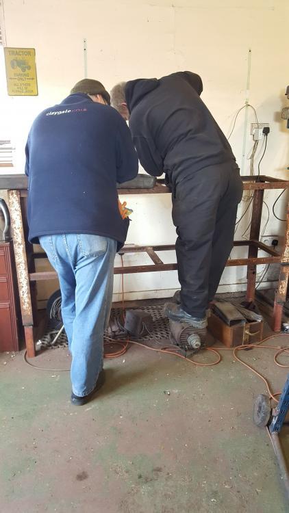

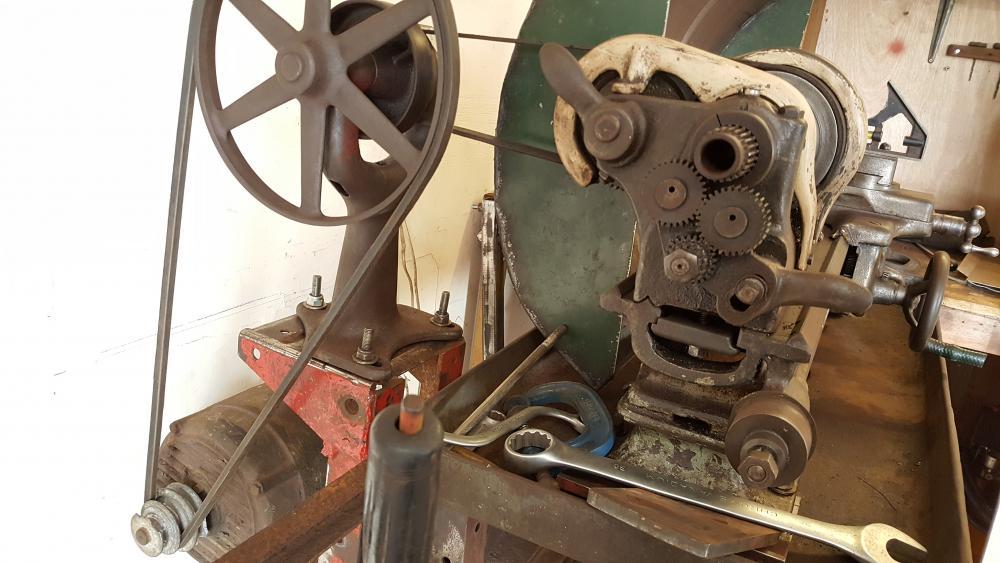

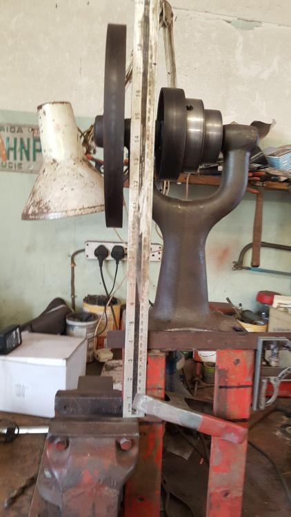

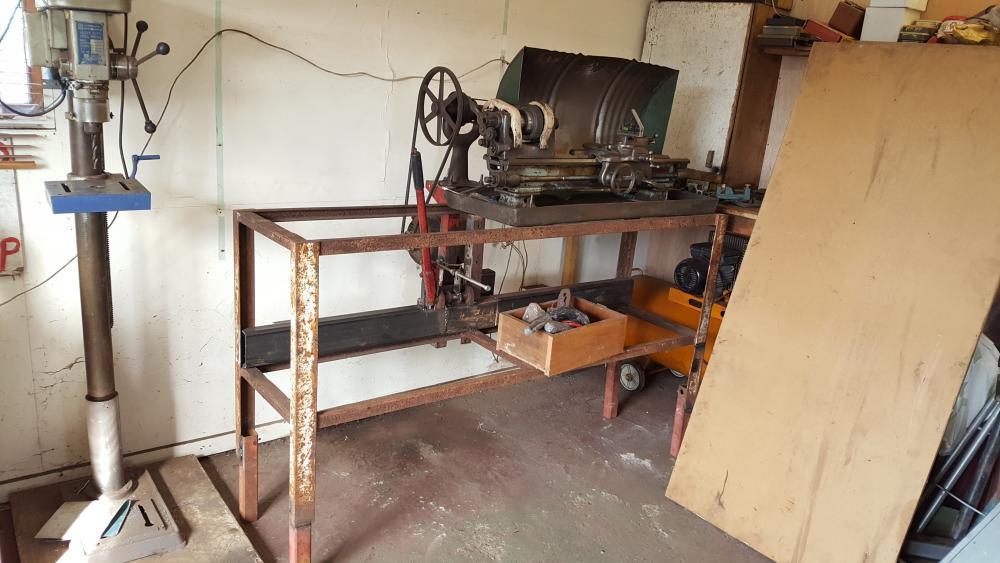

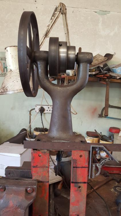

Stigian 1,235 #1 Posted December 2, 2015 Nope, not a "making something on a lathe" thread, but a "using the best bits from two lathes" sort of thing My 80+ year old Southbend lathe has served me well for many a year and all sorts of things have been made on it, but lately it has been suffering with belt slip problems and as you can see from the photo the bench it is on is starting to bend! My other lathe is/was a TW Monoturn which to put it politely is very worn! The base is good (apart from a crack in it) and the motor is very strong.. The rest is scrap really! Strip down of the Southbend to make it lighter to move about.. A chance to give it a good clean as well.. The TW Monoturn soon looked like this.. And eventually it was reduced to a pile of parts. Rather than use the lathe base/tray legs I will be using just the tray. The bench will be strengthened a huge amount to take the extra weight of the tray and bigger motor. This is only a mock-up so the big bits of box will go and the tray mounted level on the bench once I have cut a hole for the drain bit on the tray which is lower than the rest of the tray.. The lathe and tray look good together, a good time worn match 9 Share this post Link to post Share on other sites

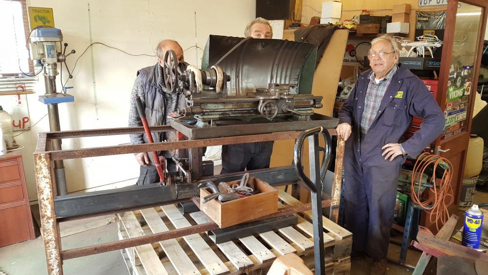

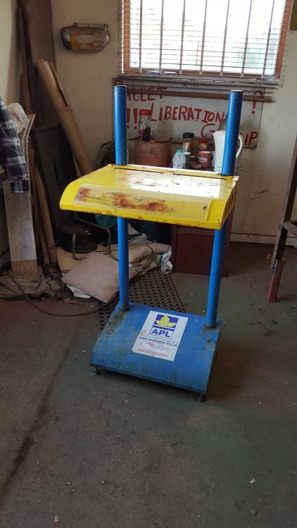

Stigian 1,235 #5 Posted March 29, 2017 Time to bring this lathe thread back from the dead.... Yes it really has taken me this long to get on with it!! On 02/12/2015 at 8:26 PM, 953 nut said: Should be around for another eight decades. Thanks Richard, I expect the lathe and bench to out last me On 02/12/2015 at 8:49 PM, AMC RULES said: New machine looks great Ian. Thanks Craig, if your referring to the Monoturn, it would of been great if it hadn't been so worn! On 02/12/2015 at 11:11 PM, DougC said: They made things to last more than one lifetime back then. Superior quality and workmanship and all the pride of a job well done at the end of the day. Hi Doug, yeah they sure did build em to last, for a 80+ year old lathe my Southbend has hardly any wear Soooo... Fast forward almost 16 months with this lathe project and this is where were at The poor Southbend lathe hasn't moved, it just got buried! The idea is I dig this steel framed bench out from it's hiding place and use this as the basis on the new lathe bench.. To use the new-ish bigger electric motor I need something strong to mount it on.... I just don't trust the workshop walls!! Speaking of electric motors, here's the old one on the left next to the new one.. You can see the sort of weight I need to safely position now! Interestingly the new motor is a 1/4 of a hp less than the old one, but it has a huge amount of torque Looks like a re-wire is needed too... Something has leaked onto the cable while it's been stored under a bench and has turned the plastic into a sticky stretchy mess! A big thank you to Rob at this point for your help in this huge rearrange of the workshop.. Thanks mate Lathe, be gone... As luck would have it the wooden bench and the steel framed bench were both near enough the same length, which made swapping them around easy This bench and I have a long history, I remember collecting it as a bare frame from a friend's yard on a trailer behind my old WH 312-8.. A pleasant 15mins drive across (well around) fields... The holes on the right are where I had a 9 inch cutter mounted, all the sparks, dust etc would shoot down the hole, through a funnel thingy made from old computer cases into a collection box.. The said funnel thingy.. Off comes the top, two MDF boards bolted through the frame skinned with stainless which was stuck down with "No more nails" back in the day when it first came out and was dirt cheap! The bare frame.. And the mess the rest of the workshop is now in Leg extensions as modeled by Rob..... The bench that is not Rob A test fit of the catch tray and a bit of a measure.. HHmmm... The results of the measuring.. You might say the bolt hole don't quite line up a lot! The easy way would be to grind the flat plate down so the lathe legs would sit level on the tray, but I'm a bit worried about removing strength from the tray at a stress (bolting down) point.. The other way is to make a couple of rather big shims/plates that would bring the tray base level with the flat bit and bolt the lathe down through that.. It's something to think over.. By that point yesterday I was quite tired so I did a little gentle cleaning instead.. It's nice to see what colour the paint is and some shiny bits In order to bolt the lathe down I needed a couple of big thick steel plates (or so I thought!), but as I didn't have any it was time to slice up some of this nice 1/4" thick angle and do some welding.. You can never have too many clamps Welded.. The almost finished plates.. As somehow the drip tray is a bit warped the lip was left on the plates so it could be carefully ground down to level the plate up.. Can you spot why I just wasted a lot of time? The lathe has small feet thingys where the bolts go through which means I only needed a couple of small plates rather than the full feet length one I had just made!! Oh yes, and there's the small matter of a foot long crack in the tray!! Not much I can do about this other than drilling small holes at each end of the crack to stop it spreading (done) and sealing the crack up with something to stop it leaking.. (Not done yet!) Yes the crack does go right through.. Big electric motors... For those time your legs are just not long enough Lot's and lot's of drilling later (thanks Nigel and Rob ) the lathe and tray was bolted down to the bench and I could think about how to mount the pulleys and motor.. This WH chassis looks like it could come in handy With the chassis flipped around an easy solution presented its self.. The chassis will be hinged where it makes contact with the lower bar on the bench to adjust the tension on the top belt and make it easier to change speeds.. I have the mounting plate for the motor which will be hinged off the chassis to make it easy to tension the main drive belt.. Chop the foot rest rods off, followed by the front of the chassis... Chop the axle pivot mounts off and weld them to a big bit of box. And with one of the sliced off foot rests through the hole it becomes a big arse hinge Checking where to drill hole holes in the trans mount of the top pulleys. Interesting to see the chassis rails did not come level from the factory.. But all the bolt holes did Checking for belt clearance as the motor fill fit behind the chassis belt tensioner thingy.. And that's as far as the new lathe bench has got.. Tune back for more heavy metal work when it happen 3 Share this post Link to post Share on other sites
953 nut 69,906 #6 Posted March 29, 2017 16 minutes ago, Stigian said: This WH chassis looks like it could come in handy to the rescue! I love seeing parts and pieces being re-purposed. Thanks for the shop tour. 1 Share this post Link to post Share on other sites

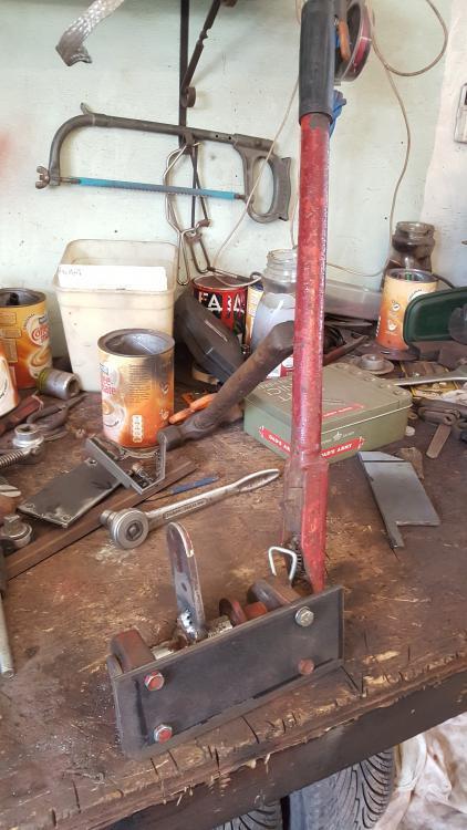

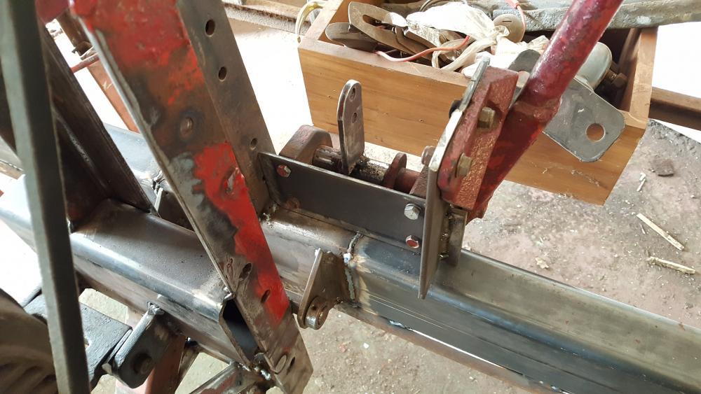

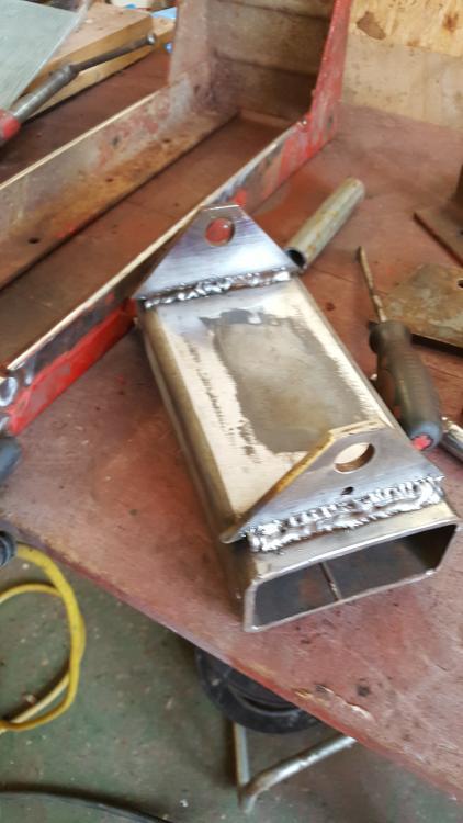

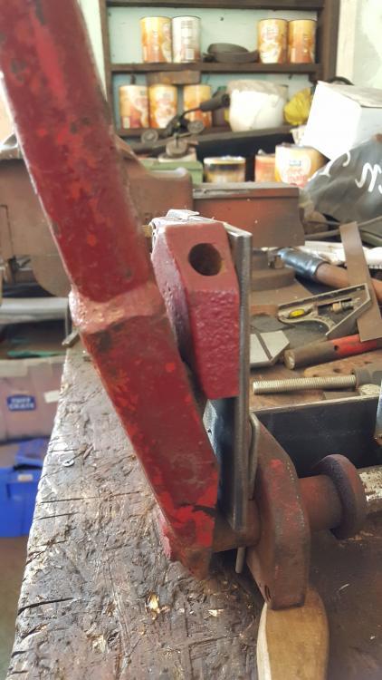

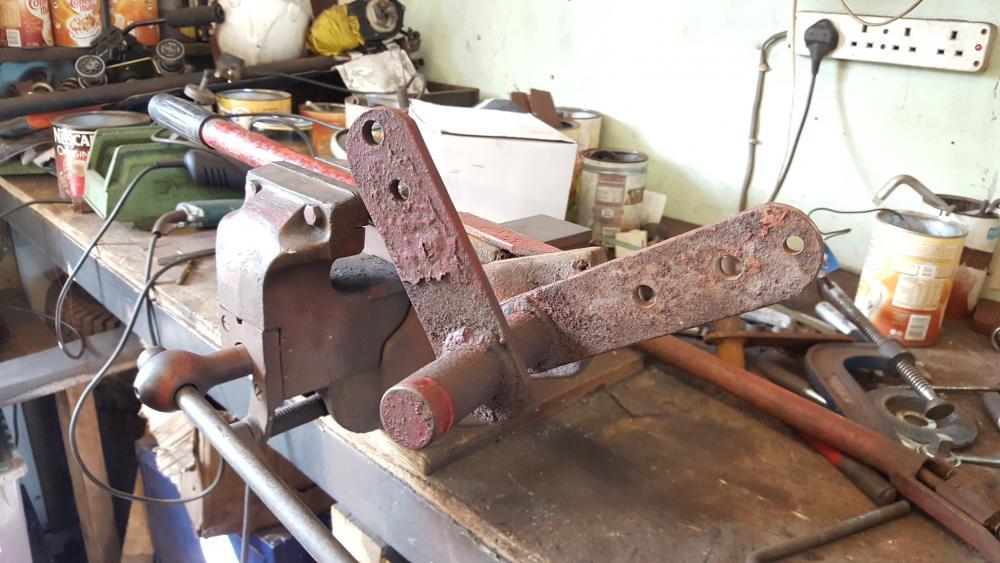

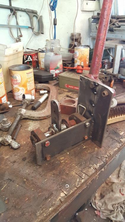

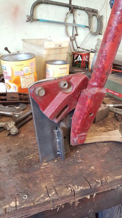

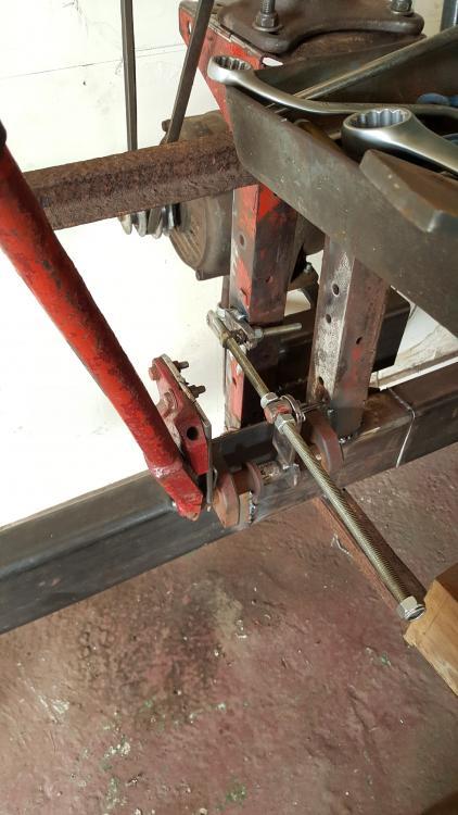

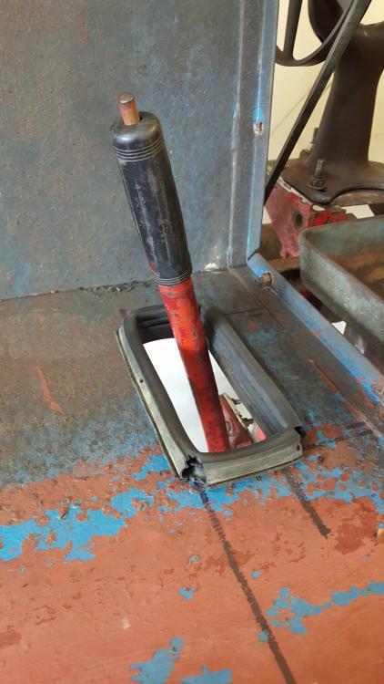

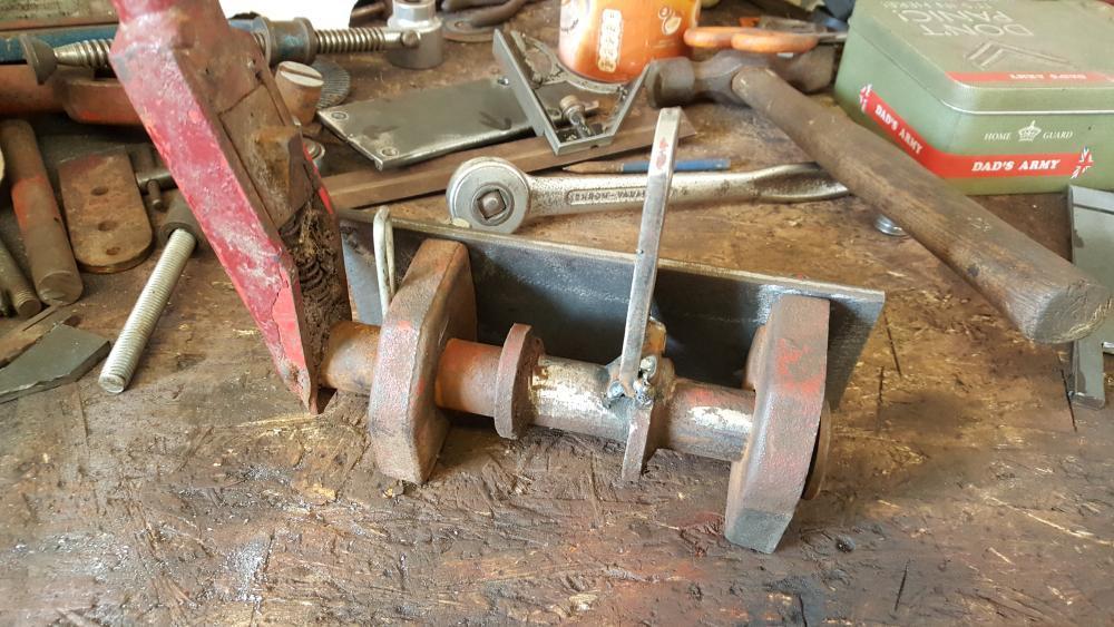

Stigian 1,235 #12 Posted April 10, 2017 Take a couple of Wheel Horse lift handles, here's one of them.. Then totally forget to take and photo's of the next few stages until you get to this point and remember again! The idea of the lever is so I have a quick release way of changing the lathe speeds as it involves moving a belt across flat pulleys. The lever will have two positions, all the way back which will keep the belt nice and tight, and of course pull it towards the front to loosen the belt.. Now, what could I use to lock the lever in the "drive" postion?? Once it's fully welded up then I think it will be strong enough for the job It will be welded to the bench soomewhere about here with an adjustable rod to connect it to the er... tilting Wh chassis/motor/pulleys mount And that be this thread up to date again 5 Share this post Link to post Share on other sites

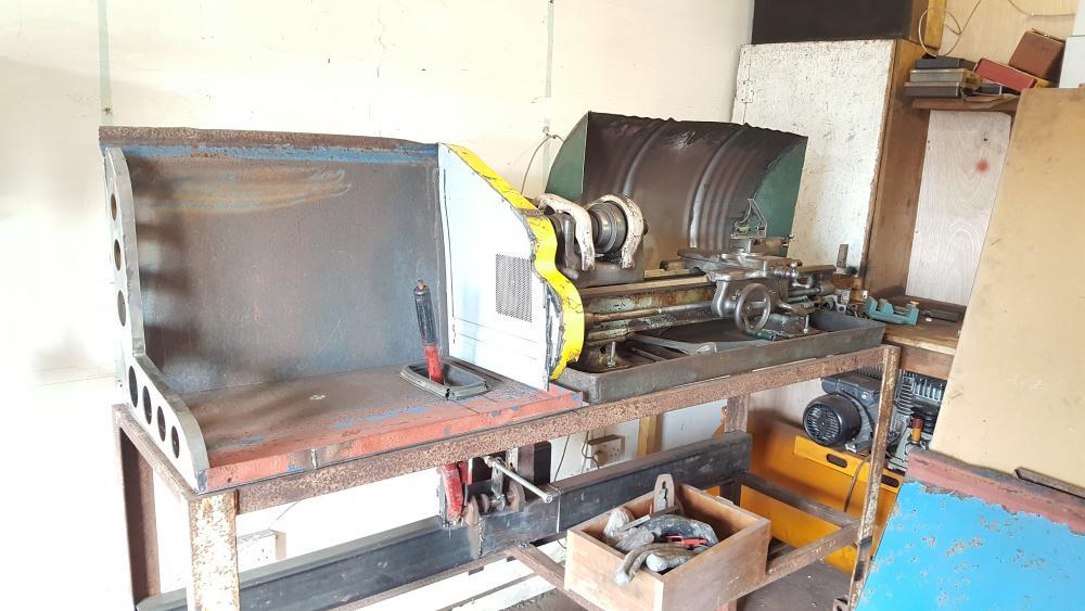

Stigian 1,235 #15 Posted April 12, 2017 (edited) On 10/04/2017 at 8:49 PM, elcamino/wheelhorse said: @StigianAs usual I am in awe of your skills and taking bits and pieces to create something that is need to get the job done. Toby looks right at home in the shop. I see you have soft pillows for him to relax on. Keep up the great work. Waiting for the next installment. Cheers Thanks Jim, the next installment is here for you Toby is right at home in the workshop now, though he doesn't use the pillows much and seem to prefer a cold floor! I plan to put a desk in the corner where the pillows are, so he will end up with a nice comfy bed under it On 10/04/2017 at 10:06 PM, squonk said: Hi Mike, was the motor at a set speed or did the tingling change with motor speed?.. If so what was you favorite speed? Variable frequency drives. About 40 HZ get you a heeby-jeeby! As long as you enjoy the heeby-jeeby's Mike, that's the main thing I did a raid on the scrap heap yesterday looking for extra legs for the bench and come back with this display stand I'm going to have to find a use for these end panels with the holes as I like the look of them.. A big moment came yesterday as "Operation Rotate" commenced.. A big thank you to (from left to right) Rex, Nigel and Dennis for giving me a hand rotating the lathe bench..Thanks Guy's A pump up pallet truck and a few pallet's made the move a painless affair The lathe in it's new postion, the pillar drill was also moved out of it's corner to a spot easier to get to.. A bit of thinking was needed to make the adjustable linkage that er.. links the lift arm to the pivoting pulley bit.. It needs a little refining but it works very well.. It's a bit hard to show with photo's but with the lever locked back the "speeds" belt (the flat one) is tight. Pull the lever forward into the other lock postion and the belt is slack making for easy speed changes. While I was raiding the scrap heap yesterday I also returned with this switch gear which is in much better contion than the switch the came with the bigger motor.. And this big thick steel sheet both of which used to live on a compost mixing machine.... Having a workshop on a nursery does have it's perks As you can see the sheet has been marked out for cutting and bending. Chopped almost in half.. The back bent up.. And a slot cut in it for the belt lever.. A Vauxhall Corsa (or what was left of one!) donated a small bit of a door rubber partly to cover and shap edges, but mostly so I don't knock things down the hole Yes the blue sheet has become a bench top.. and back.. Better photo's of it coming up shortly. Edited April 12, 2017 by Stigian 1 Share this post Link to post Share on other sites

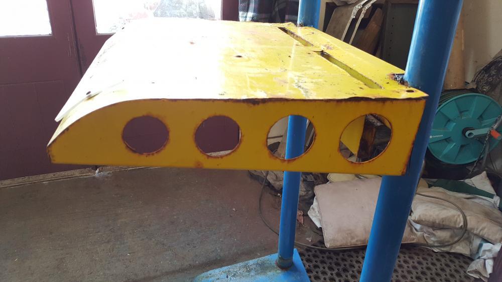

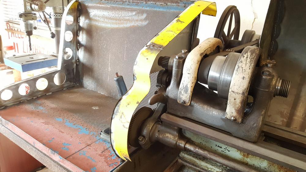

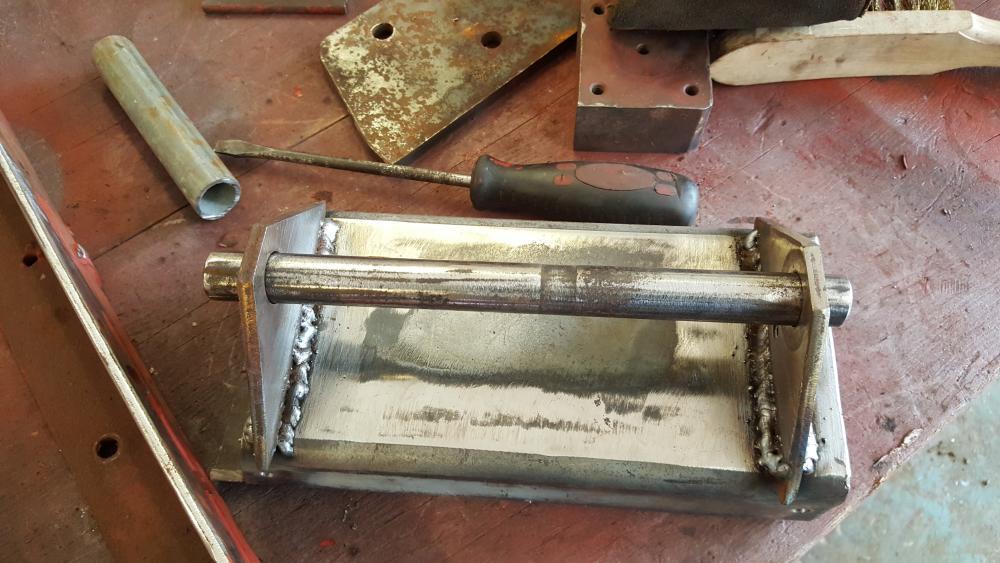

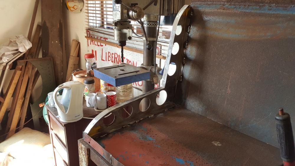

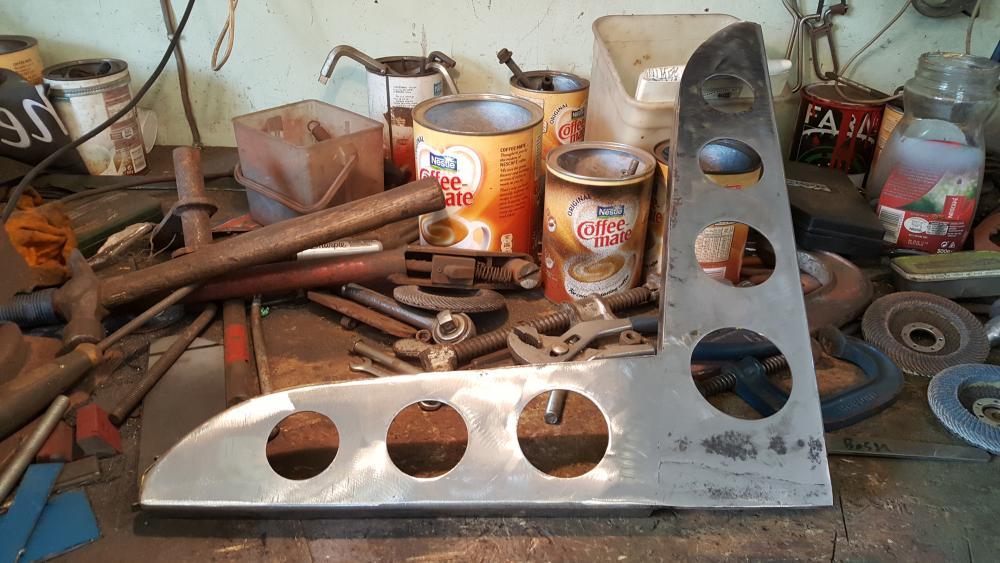

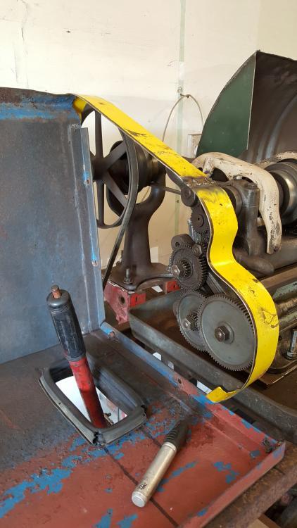

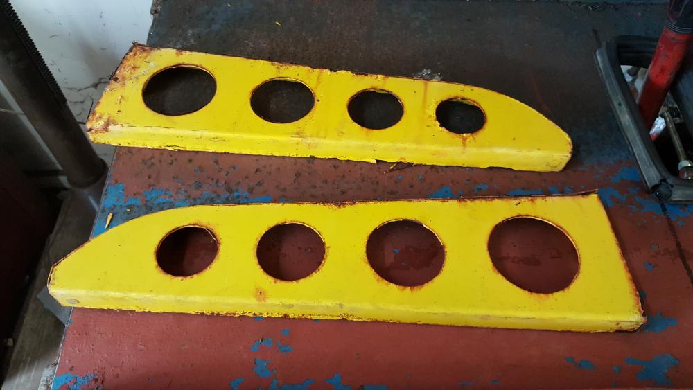

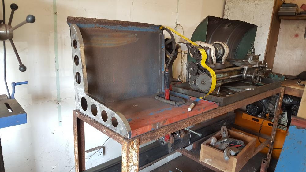

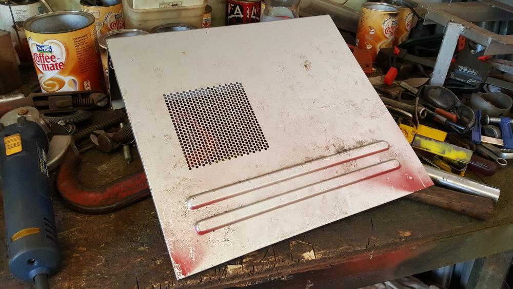

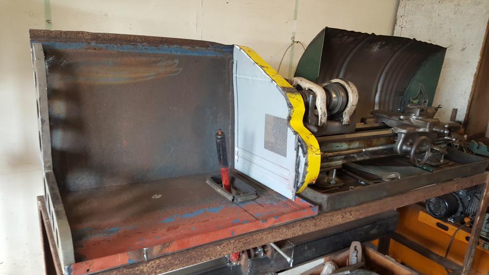

Stigian 1,235 #16 Posted April 12, 2017 (edited) You know those holes I liked? Yep these ones... Well I found a good use for them.. A bit of trimming and welding was needed along with this small plate to fill up a hole. And this is what I have made with the holes.. It fit's on the end of the bench to give it some strength and some style.. OK, I could of come up with a simpler design, but I just couldn't help myself Something was needed to cover the cogs that powers the er.. Auto feed is as good a name as any.. Anyway, a couple of strips of steel welded together and bent in a funky shape. Dig out a bit of computer case.. Chop and weld to shape.. I need to finish the welding and give the edge a little grind down, but I'm happy with the strange shape and look A finishing shot for the day Edited April 12, 2017 by Stigian 4 Share this post Link to post Share on other sites

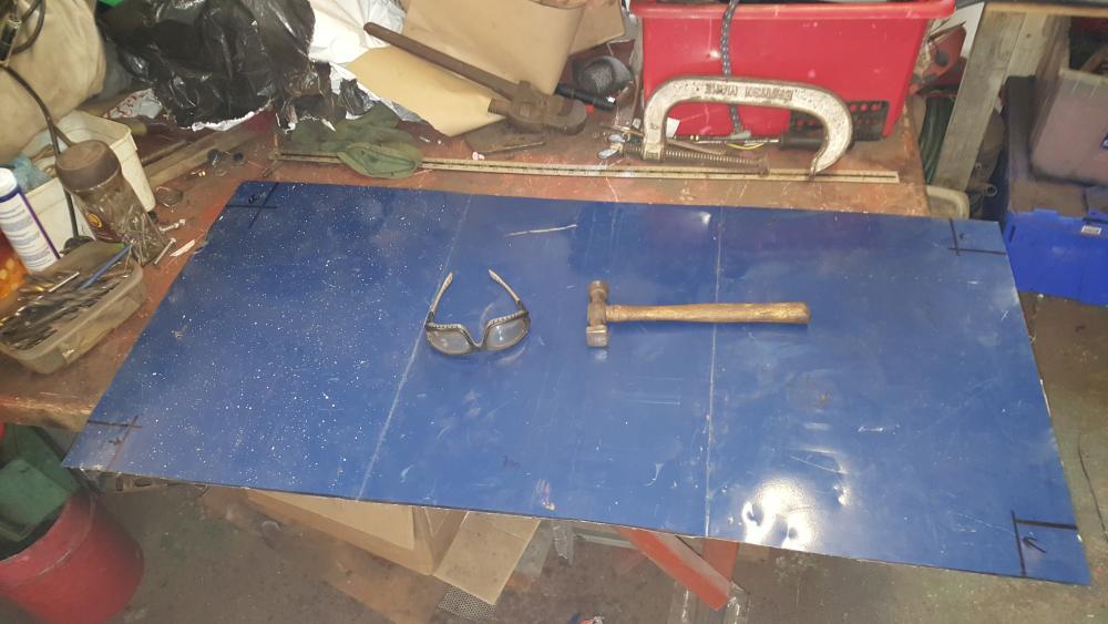

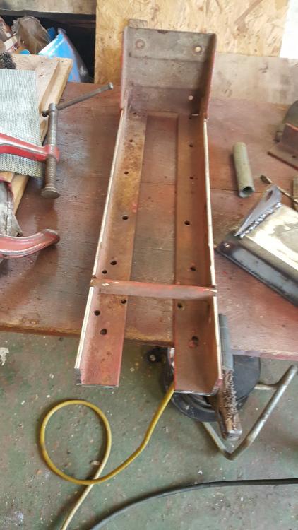

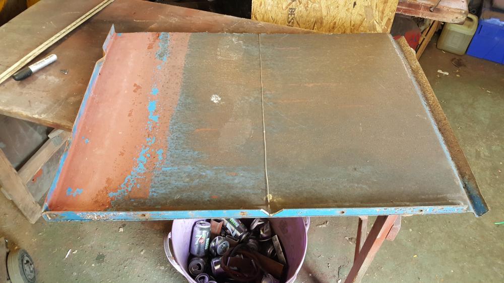

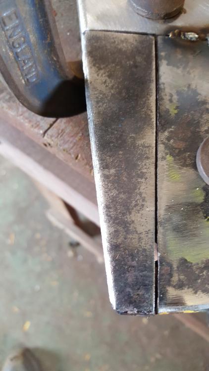

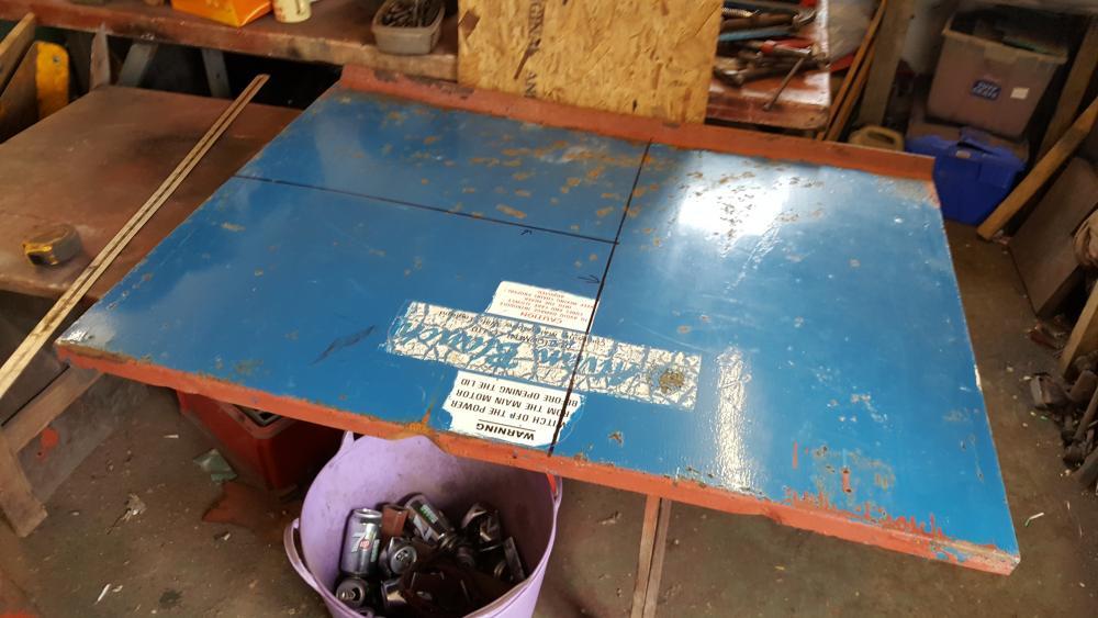

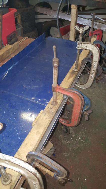

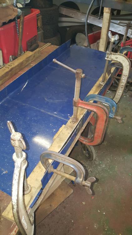

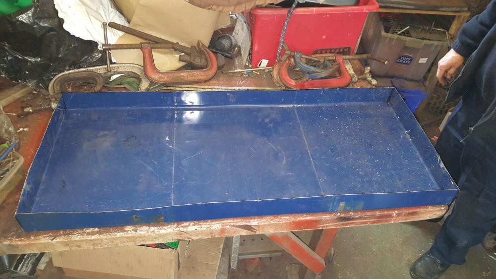

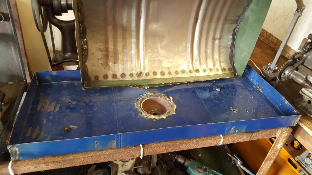

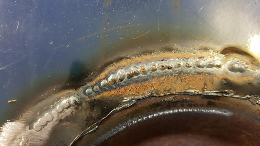

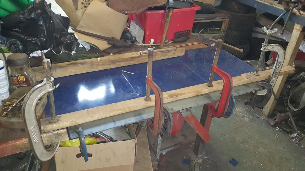

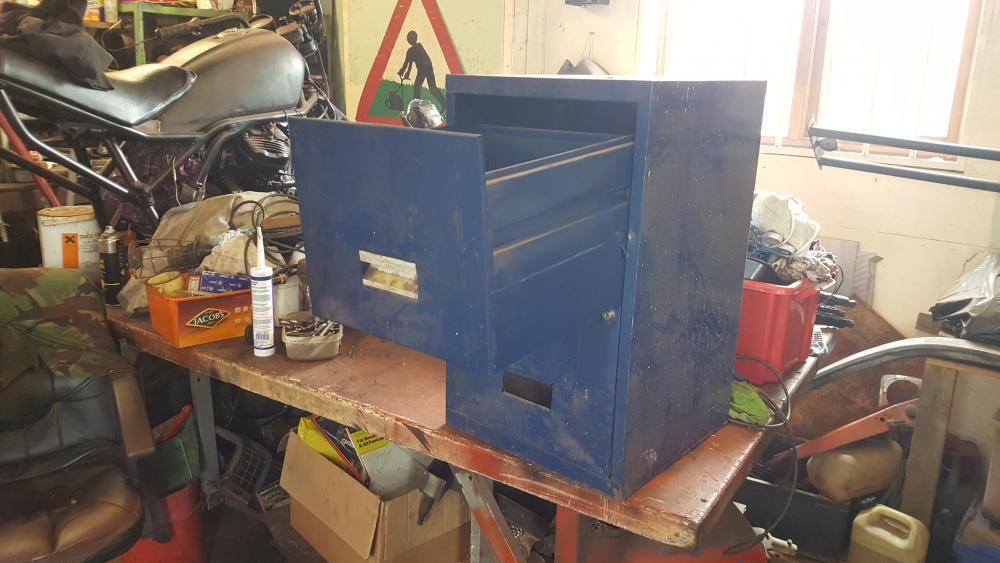

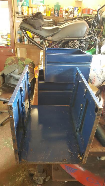

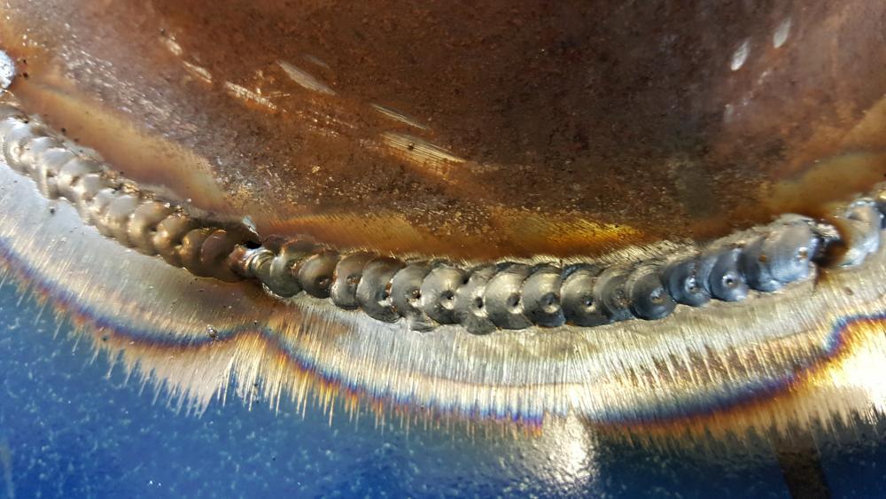

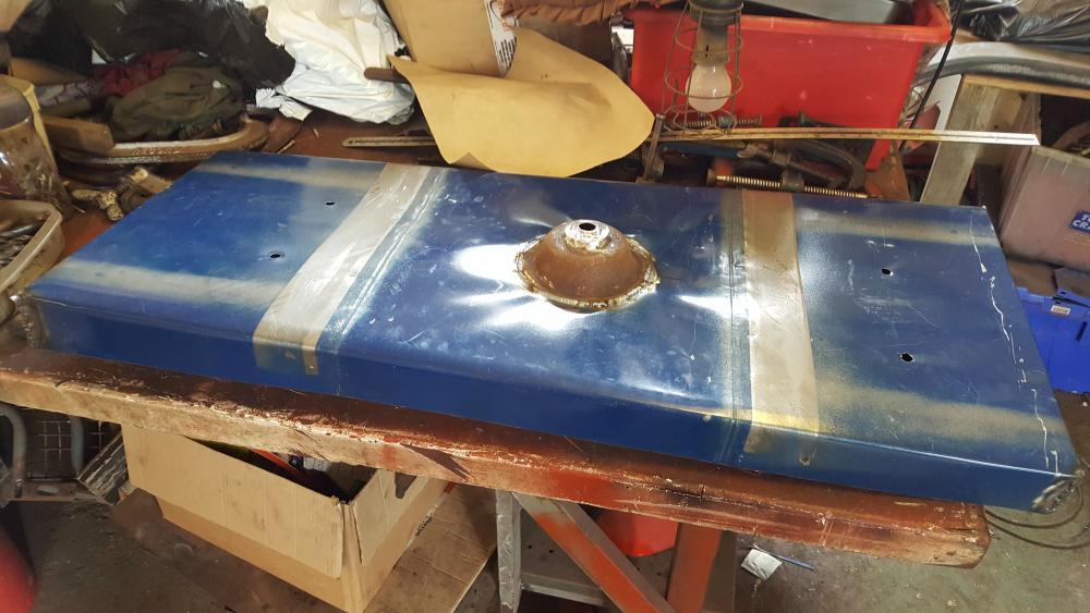

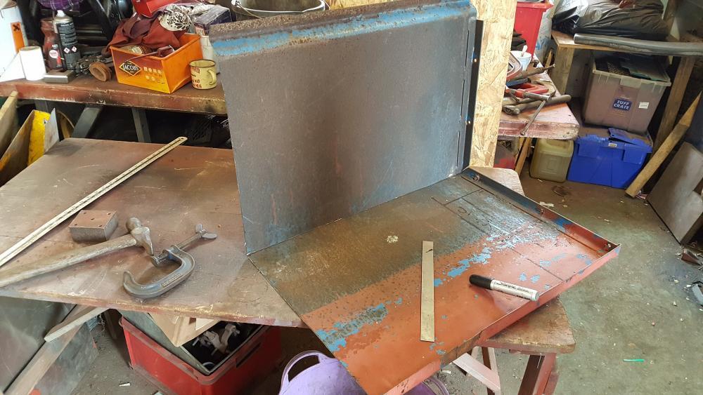

Stigian 1,235 #22 Posted May 17, 2017 Now if something is bugging me I have to sort it out which is why after lot's of measuring this little used filing cabinet was dug out.. Top and tailed, just the strenthening bits and the draw runners to go. . Flattened out with the corners marked to be chopped out. Time to bend the edges up.. First bend, a little at a time. The last bend.. Until..... Mounting holes drilled and a "sump" welded in... Yes the tray has warped a bit, but that was to be expected and will pull down alright once the tray and lathe are bolted down. Some nicely spaced welding, yes I did weld up the hole I had missed Good penetration as well A test fit of the new (hopefully) leak and crack free tray.. I did bolt the lathe back on yesterday but forgot to take any photo's.. Share this post Link to post Share on other sites
