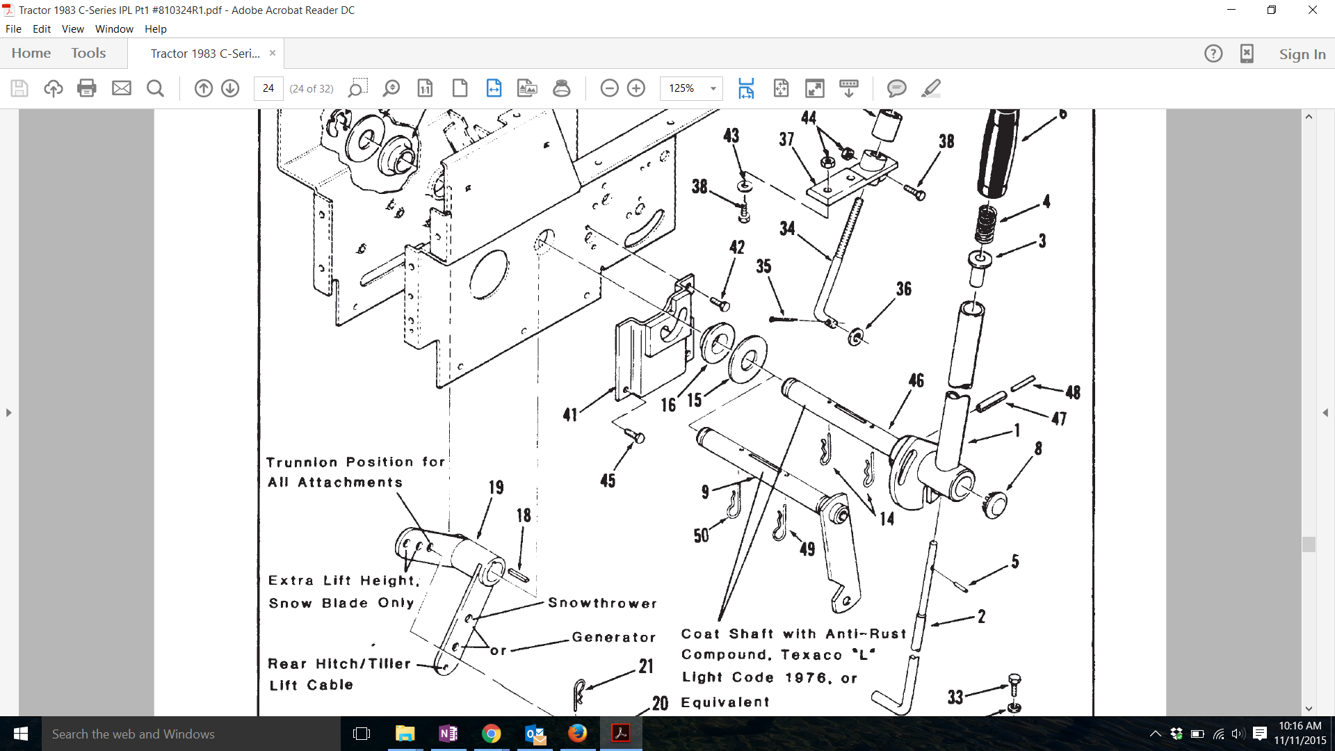

The rock shaft on both Auto and manual wheel horses are the same. The rock shaft on a hydro goes to a flange for the hydraulic cylinder, on the manual tractors it is extended out to the handle.  If all the parts are there for the snowblower, it will fit up with no problem.
There are only two issues you might face:
The lift-assist spring is often optional if mounted on a hydro but an absolute necessity on a manual.
While some people have run a 2 stage on as low as 14hp, you might be a bit disappointed with 16hp. It was designed for the 520. It will work, you might just have to go a bit slower.

Thanks bmsgaffer for the details.  Sounds like worst case is I might need the extension piece that replaces the tie-in to the hydraulic flange and extends to the existing manual lift arm I have.  I assume I can find one, order one from Toro or fabricate one.  You would have a pic of the attachment handy?

No, worst case scenario (if the blower is complete) is you will only need a lift-assist spring.
Here is the IPL for the attachment section. Notice all parts are the same except you use shaft #9 for hydro or #1 for manual. So all attachments are exactly the same no matter hydro or manual with the exception of adding a lift-assist spring. :handgestures-thumbupright:
