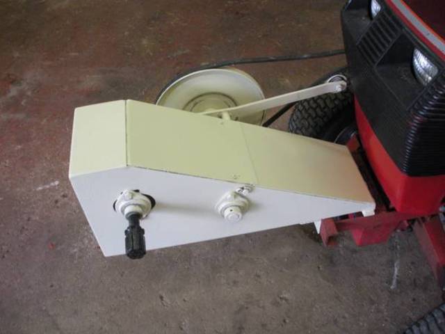

oliver2-44 11,628 #6 Posted October 14, 2015 I came across this picture of a front PTO on a later model Wheelhorse with a attach-a-matic mount when I was looking for ideas to drive an Ice Cream maker!. Can anyone identify if it a true Wheelhorse attachment, or what brand it might be that someone modified to fit?@Super Moderator-(Super Mod) @gwest_ca-(File Mod) Share this post Link to post Share on other sites
CasualObserver 3,416 #7 Posted October 15, 2015 @oliver2-44 Any idea what website that picture was from, or was it just a google image result? I'm thinking it's not a US attachment if it is a mass produced item at all. Seems pretty crude in construction, made using convenient materials.@pstlouis - not at the moment, but I have considered it. Never hurts to ask! Share this post Link to post Share on other sites
oliver2-44 11,628 #8 Posted October 15, 2015 It's actually been for sale on Clist in Des Moines Iowa, seller is in the small town of Newton. I tried to buy it but the seller won't ship. He said his dad past away and originally had 35 WH and he had 2 left for sale, I tried to get a friends relative to ship iy for me, but got a no-go on that avenue last night. Wish I knew someone in that area.@CasualObserver-(Super Mod) @pslouis Share this post Link to post Share on other sites

82Caddy 851 #11 Posted October 19, 2015 (edited) I came across this picture of a front PTO on a later model Wheelhorse with a attach-a-matic mount when I was looking for ideas to drive an Ice Cream maker!. Can anyone identify if it a true Wheelhorse attachment, or what brand it might be that someone modified to fit? @Super Moderator-(Super Mod) @gwest_ca-(File Mod) That is actually for sale on the Des Moines craigslist with a location of Newton Iowa.Posting ID: 5251411361It's not a direct link, so it should be ok to post...Edit: Someone beat me to posting it's on craigslist. Edited October 19, 2015 by 82Caddy Share this post Link to post Share on other sites
