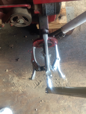

muz123 1,193 #1 Posted July 4, 2015 Need to replace my left rear seal on my 520-H. Finally got the hub off using a 7-ton puller but the key appears to be almost "welded" onto the axle. Any tricks to getting the key off?Thanks,Dave Share this post Link to post Share on other sites

AMC RULES 37,260 #4 Posted July 4, 2015 (edited) I think you stand a higher risk of breaking your hub using the type of puller you have there. For reference...http://www.wheelhorseforum.com/topic/55557-wheel-hub-puller-needed/#comment-515679 Edited July 4, 2015 by AMC RULES 2 Share this post Link to post Share on other sites
muz123 1,193 #5 Posted July 4, 2015 (edited) I think you stand a higher risk of breaking your hub using the type of puller you have there. Already pulled it off, but broke 2 smaller pullers. Edited July 4, 2015 by muz123 Share this post Link to post Share on other sites

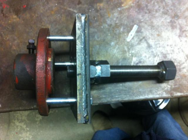

squonk 48,326 #10 Posted July 4, 2015 (edited) Here's my homemade puller. I had to pull a hub off of a 60's era trans about a month ago. I used my 1/2 " impact gun. Took over a half hr. to get that hub off but nothing broke. My hand hurt for a week after all that pounding though.http://www.wheelhorseforum.com/topic/52038-my-new-super-whoopie-hub-puller/ Edited July 4, 2015 by squonk 1 Share this post Link to post Share on other sites
