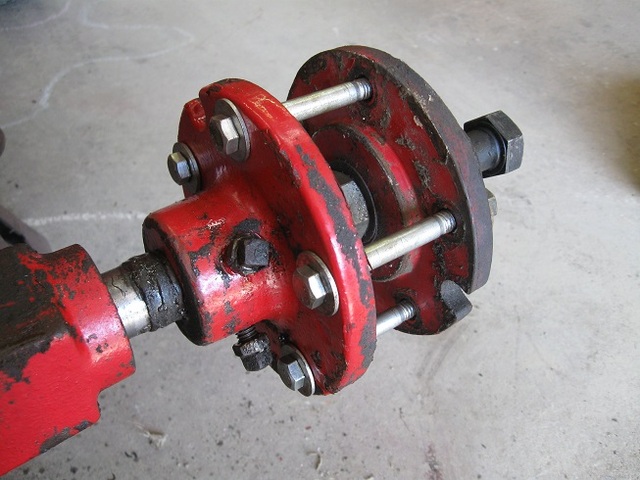

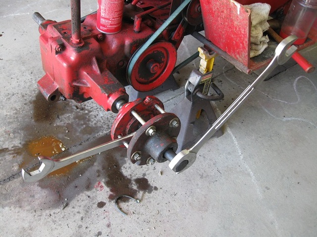

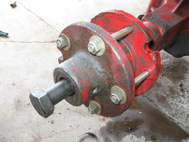

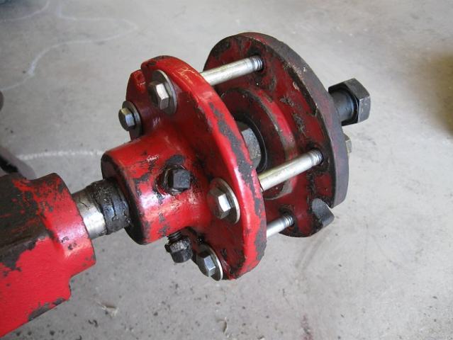

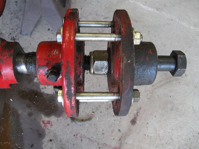

N3PUY 1,031 #3 Posted April 18, 2015 You can make a puller. Here's pics of the hub I pulled just today. I think you can see from the pics how it's done. 2 Share this post Link to post Share on other sites

N3PUY 1,031 #5 Posted April 19, 2015 I was lucky! The hub I used is off of the left side ... it slid right off. The reason the right side hub was stuck is because the set screw had mushroomed against the axle and would not back out. Share this post Link to post Share on other sites

moe1965 774 #14 Posted August 26, 2016 On 4/18/2015 at 6:29 PM, N3PUY said: You can make a puller. Here's pics of the hub I pulled just today. I think you can see from the pics how it's done. I'm using the same setup on mine. One hub came off no issue the other one is giving me a fight. I used a little heat and pb blaster. I think I will switch to a fine thread bolt. Is that what you are using? Share this post Link to post Share on other sites
