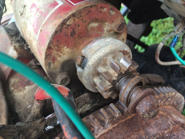

So after getting the cover off it looks like the gear on the alternator has moved in towards the center of the engine.

Aldon
It looks to me like starter is in need of rebuild or replacement. The gear when you initially crank it should extend and engage flywheel. Cost and effort of rebuild may be a wash with what you can replace it for. it should be K321 Kohler Starter........

Rob R
Your starter Bendix is toast, you either need to rebuild this or replace the starter.... both are available on e-bay

Thanks Aldon. I ordered a new starter it will be here tomorrow. I'll let you know how it goes.

Got the new stater put in today and she starts like a dream. Thanks to everyone for the feedback. Now on to other repairs. :)
