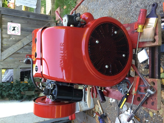

MikesRJ 562 #9 Posted May 25, 2015 (edited) I'm almost done with the engine. Edited May 25, 2015 by MikesRJ Share this post Link to post Share on other sites
rmaynard 17,431 #10 Posted May 25, 2015 Wow. That looks great Mike. Were you able to use the crankshaft that spun the rod bearing? Share this post Link to post Share on other sites
