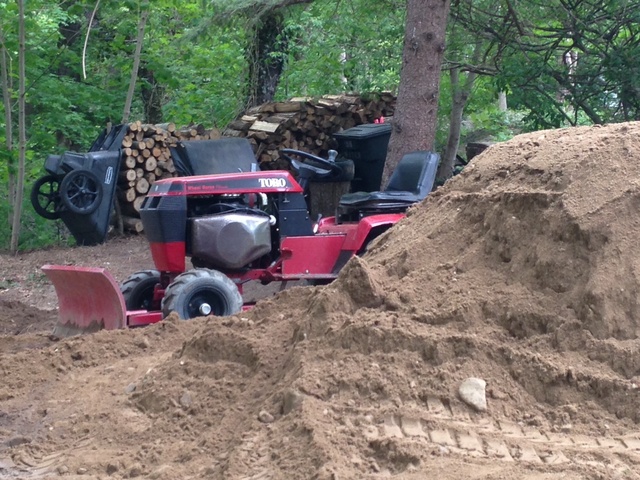

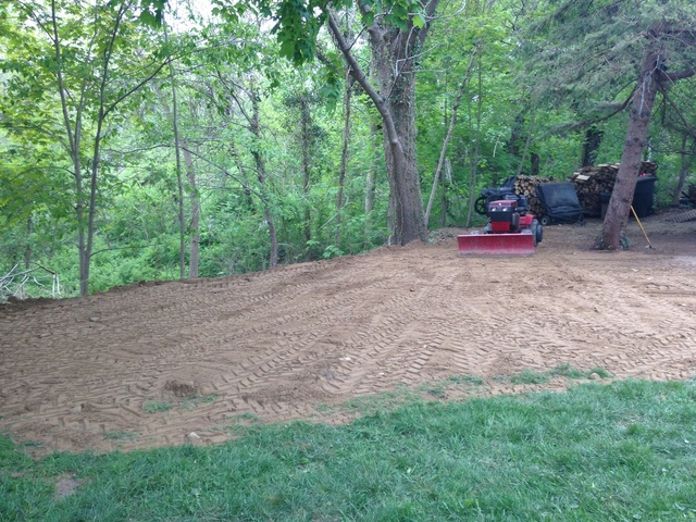

TunaSlayet 89 #1 Posted May 18, 2015 So I wanted to post a topic on the 48" dozer plow, and it capabilities when paired with a hydro lift 300-500 series tractor. I had many doubts that I would actually be able to grade and spread fill and loam with my machine, but like anything else, was willing to try. I was able to spread and grade 10 yards of fill in about and hour with no real heavy abuse to the machine. Figured I would share the wealth. The community of red square helped me put this tractor back in running order. 6 Share this post Link to post Share on other sites
muz123 1,193 #2 Posted May 18, 2015 Looks like fun! Share this post Link to post Share on other sites
Pollack Pete 2,273 #3 Posted May 18, 2015 Now you gotta hand rake all those groovy marks made by those ag tires.Just kidding.Looks like a good job done.Very nice Horse. Share this post Link to post Share on other sites
c-series don 12,656 #4 Posted May 18, 2015 As a grader operator by trade I would say, nice job. Now you probably want more material so you can get more seat time! Nice tractor. Share this post Link to post Share on other sites
TunaSlayet 89 #6 Posted May 18, 2015 Thanks guys! I will say to anyone considering using the dozers blade for grading, it does in excellent job. I will post up the finished product when I am done. Probably looking at another 50 yds of loam coming in 10 yd dumps. Then I'll just have to get the grass to grow. Any tips from the pro dirt movers out there to help prevent any erosion on the steeper sections. I was planning on some kind of ground cover, but something in the short term may be needed if we get some rain. Share this post Link to post Share on other sites
bmsgaffer 2,071 #7 Posted May 18, 2015 Its good to see the 420 working!You must have a very straight dozer blade, mine always seem to have a little twist in the frame so they do a great job i just usually have to do a little smoothing out afterwards. I have a mid-mount grader now though and that things awesome!The only truly effective erosion control I have been able to find is stepped block walls (the stuff designed for it). Trees work great for a while too but its hard to get them to grow fast enough to hold the hill in place! Share this post Link to post Share on other sites
Tim 97 #8 Posted May 18, 2015 erosion is going to happenplant seed ASAP to develop a root system to minimize Share this post Link to post Share on other sites
WildHorses 443 #9 Posted May 18, 2015 (edited) That's not a 420-LSE and if it was I surely hope you wouldn't be working it! Edited May 18, 2015 by danielbaute Share this post Link to post Share on other sites
JERSEYHAWG / Glenn 4,590 #10 Posted May 19, 2015 Fantastic job. Those banks look fairly steep. Retaining walls set correctly are pricey. Theres an art to it. Hope the green stuff starts taking root, weeds, anything to help prevent erosion. Thanks for sharing, keep us posted as you move along.glenn Share this post Link to post Share on other sites
AMC RULES 37,260 #11 Posted May 19, 2015 Better riprap that slope with the quickness.https://www.google.com/search?q=riprap+slope+stabilization&espv=2&biw=1366&bih=643&source=lnms&tbm=isch&sa=X&ei=I4BaVaTcG4b9yQSK6IDQBw&ved=0CAYQ_AUoAQ Share this post Link to post Share on other sites
bmsgaffer 2,071 #12 Posted May 20, 2015 That's not a 420-LSE and if it was I surely hope you wouldn't be working it! It actually is! Someone trashed it (used it very well) in a past life and he has resurrected what was there and gotten it to be a good worker!(See this: http://www.wheelhorseforum.com/topic/54228-520-h/ and this: http://www.wheelhorseforum.com/topic/55797-420-lse-mutt/)I'll bet many 420 owners are jealous they never get to really work that Kohler 20! Share this post Link to post Share on other sites
Forest Road 595 #13 Posted May 20, 2015 Looking good! For a final grade you should try a 50" mid mount grader. Share this post Link to post Share on other sites
TunaSlayet 89 #14 Posted May 20, 2015 I have been keeping my eye out for a grader blade in my area, but they seem to be hard to find. I can definitely see the advantage of having the plow directly over the weight of the tractor for stability and bite. As far as it being a real 420 LSE, that is certainly up for debate. It has the steering and front end from a 520, and the sheet metal is a mystery. It does still have its M20 Kohler! What a sweetheart of an engine. It is quiet, starts east, and never struggles with the plow. The eaton 1100 has taken a little getting use to, but the advantage is really the hydro lift, and not having to change gears. I have been eyeballing matts foot pedal kit for a while. After I replace the pto clutch, adjust the valves, and decarbon the heads, it will be first on my list! Share this post Link to post Share on other sites
