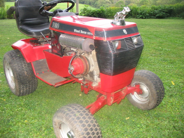

What Horse is best? They're all great but, wouldn't consider a vertical shaft engine. I adore the one cylinder 12 hp Kohlers, never let me down with proper maintenance.
The 416-8 is a 1985 model, a brute, I picked it up for next to nothin' a couple of years ago. That's the Horse I would cherish for a do all Horse.   :auto-checkeredflag:
