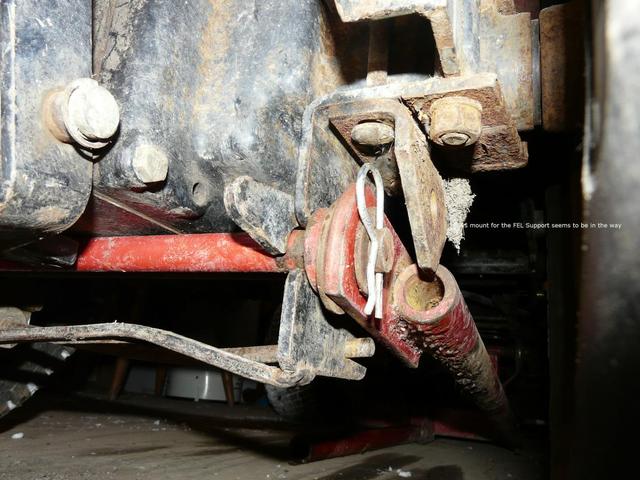

I feel like I am going crazy here.  With the help of folks on this board, I got my "new-to-me" 522xi operational last winter with a 44" snowblower.  It worked beautifully.
This year I removed my loader (just like last year) and I am now trying to mount the snowblower.  My current challenge is the mounting of the rear support rods from the rear Attach-O-Matic.  Last year, no problem.  This year the rods are "binding" on the rear axle brakets from the front end loader on both sides.
The attached picture shows the area of concern.  I suppose removing the FEL mount is doable, but I did not do that last year.

That piece of flat bar between the left and right side is bent up and in the illustrations it is straight. Would that do it?
OM with illustration
Garry
Adding - it looks like it should go in the front notches and I'm guessing you have them in the rear.
Thank you, thank you, thank you.
Your comment was a "eureka" moment for me.  I knew there was something I was missing and your more experienced eyes caught my stupidity.
I guess I was just lucky last year and put it in the front notches without realizing there was another option (the wrong one it turns out)
