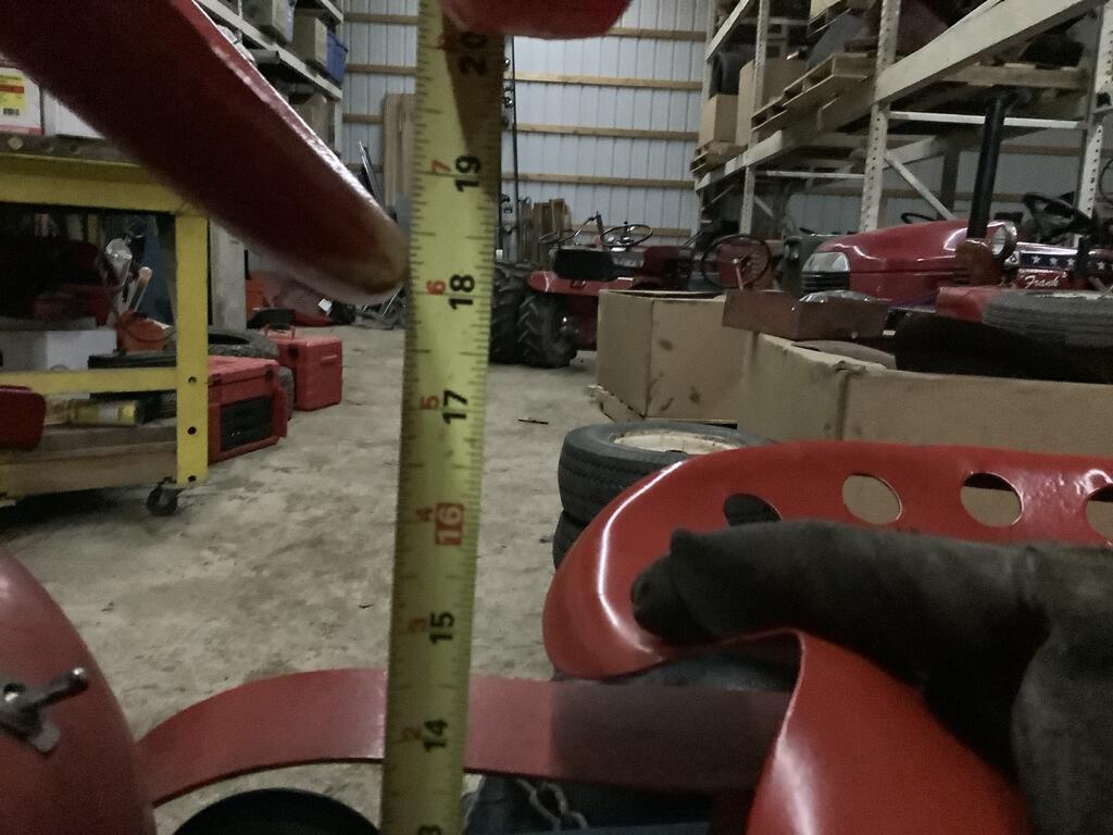

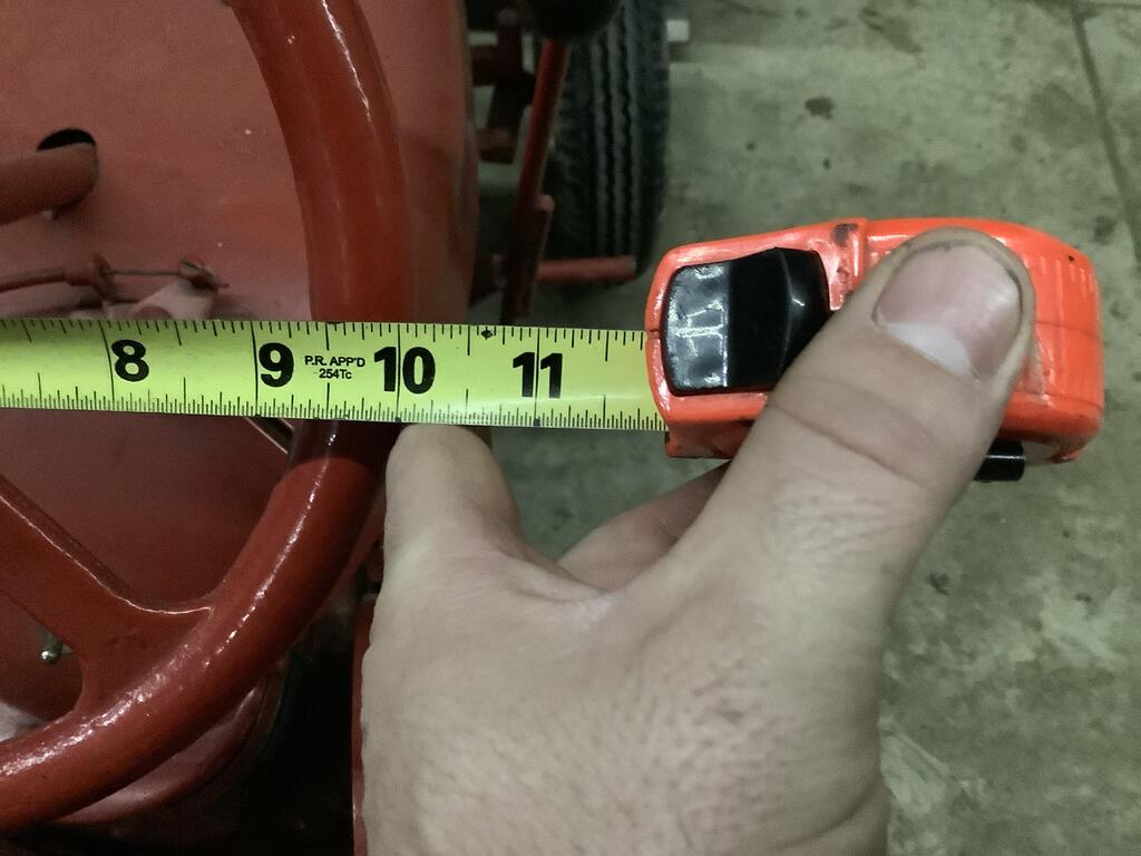

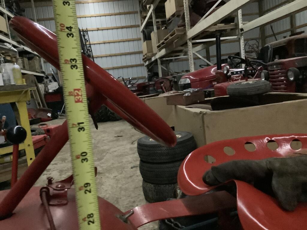

Jean of Normandy 1 #20 Posted January 29, 2021 71 / 5000 Résultats de traduction hello what is its ground clearance and the diameter of the small & the tall steering wheel on the rj 35 thank you Share this post Link to post Share on other sites

Pullstart 71,211 #23 Posted January 29, 2021 2 hours ago, Jean of Normandy said: 71 / 5000 Résultats de traduction hello what is its ground clearance and the diameter of the small & the tall steering wheel on the rj 35 thank you thanks @953 nut for pulling me in. @Jean of Normandy If you need other measurements, just let me know! I have about 10-1/8”diameter of the cast wheel. The pin height on the steering shaft is about 31-1/2” from the floor. The bottom of the steering wheel to the top of the frame is right about 18”. 1 Share this post Link to post Share on other sites
