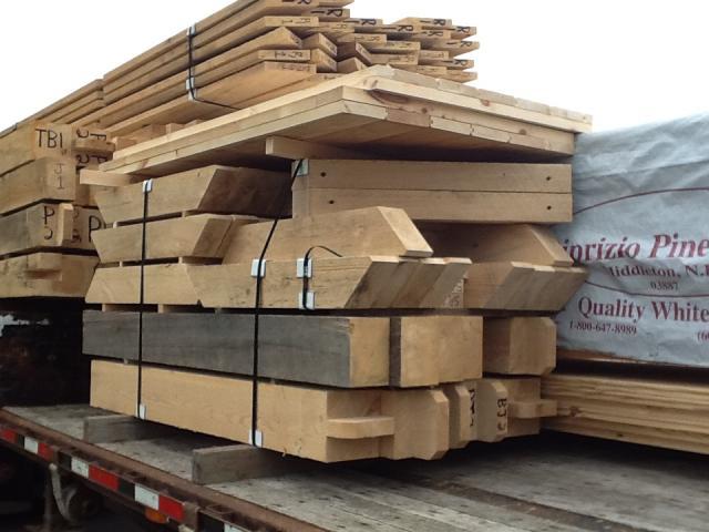

It should start to move along quickly now. I was at the barn builders place yesterday and took some pics of the barn all strapped up ready for shipping. It is about 20 mins from my house.
tunahead72
Okay, this is where I get excited, seeing the barn frame on the truck... Wait, where the heck are the photos of which you speak?

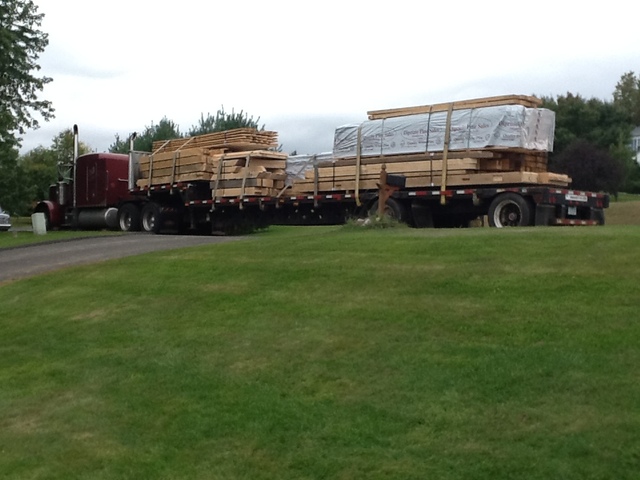

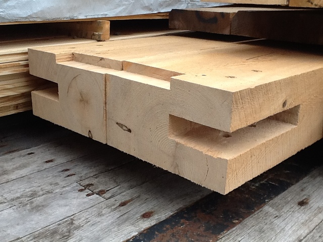

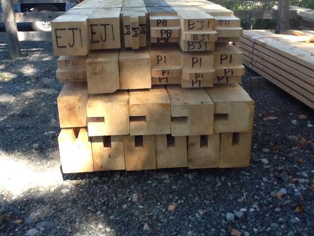

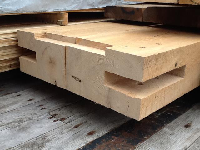

Here are the pics from yesterday. They will be loaded up and delivered tomorrow.... :)
Oooh yeah...     :handgestures-thumbsup:
like a giant Lincoln Log set
Nathanielperz
Post and beam right?

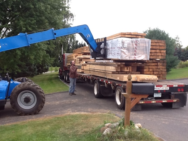

Today was a good day.. :)

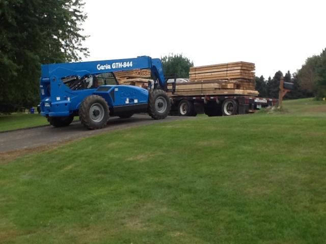

The barn was delivered to the house and so was the standing seam metal panels. I had to call in a favor to one of my contractors to help unload them at one of my projects and use his trailer to get it to my house. They plan on starting tomorrow to install sill plate and getting it ready to raise on Monday. My Sthil chainsaw had a small 16 bar on it and the chain was shot. I picked up a new 20" bar and chain at tsc and decided it was time to drop a tree near the barn that had to come down. That saw can cut for sure. I ended up using the terramite with the thumb on it to haul away the branches. It made quick work of it. I had to get it down prior to them raising the barn. Now I can sit back and enjoy.... :banana-tux:

Very impressive. I bet all the neighbors are wondering what yer up to! You know....excessive walking of their dogs by your house :eusa-whistle: tryin to get a glimpse of what your doing.
Mike..............
stevebo
They ALL know..... lol. I have been wanting this barn forever !!
When that rig pulls up in front of the house...
kinda hard to hide what you're up to.    :handgestures-salute:

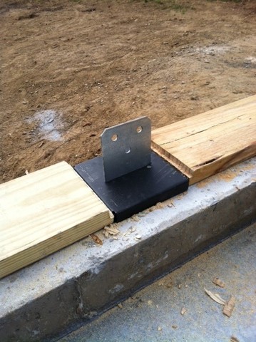

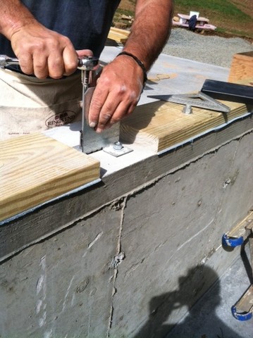

Today the 3 man crew showed up and installed the knife plates. They took a while to do as the pt sill needed to be cut out where these plates go then they needed to drill 1/2 inch holes 5 inches into the concrete to pin it with two masonry pins. They have them all installed and the upright beams in place ready to install. The bottom of the beams get cut in the middle so the knife plate will slide in and then they get pinned with 3 pins. IMO this is overkill but the problem is that in my town there is no building code for these kind of buildings so the only way they allow them is if an engineer provides a stamped drawing. This is what he wants and would not allow typical straps. The knife base sits over the bolts and the beam sits on it.

Overkill to say the least.  Was this guy a NASA engineer?  :laughing-rolling:
