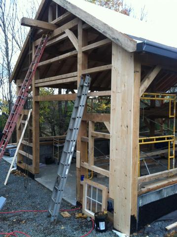

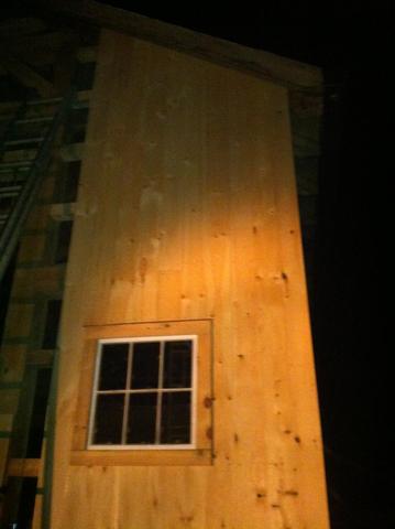

Progress !!!!! I was finally able to start the siding. Tomorrow is a BIG day as I have a small crew coming here by 7am to start setting up the staging and getting started on the roofing. I believe that Fireman, Timbo, KenB and a few other guys will come over and we can continue on the siding. Whoo Hoo!!
