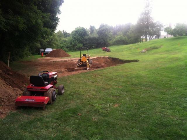

Steve...ya know how I hate to give you a ruff time. :)  but are you digging a mote around that barn???  I see the grade issues...just kind of wondering what that foundation you are digging is going to look like.  BTW...nice rock you found on the top side. :)  I went to the barn site, not sure which one you are looking at, but they all look real nice.
stevebo
Steve-
Mine is sort of a custom design. I am having footing poured first then the foundation which will be higher up front and then a slab. I plan on putting a good bit of drainage around the entire foundation and pipe it off into the woods.
stevasaurus
I was kind of thinking that was what you were up to.  You going to be able to pour the foundation, or are you using cinder block??  Very cool.  :)

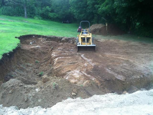

Well just thought that I would share a funny story. In 2012 I had a hard number for a price from the foundation guy. After digging we found lots of ledge which makes prepping the forms a little more difficult and the ledge needs to be drilled and pinned with rebar. The only other change I made was to add a 14 x 36 ft foundation and slab off the back side. Well that was enough for the concrete guy to more than triple his price !!!!  :laughing-rolling:  So... After telling him there is NO way that I was going to pay that he cam back and dropped it down to just over double :bitch: .... I have not even called him back at this point. I have another very well known and good concrete guy coming over on Monday to look at the project.
I do not think this guy realizes that I am in the construction industry and know how contractors try to jack up the prices based on circumstance.... Anyhow we shall see where the bid comes in on Monday.  :hide:

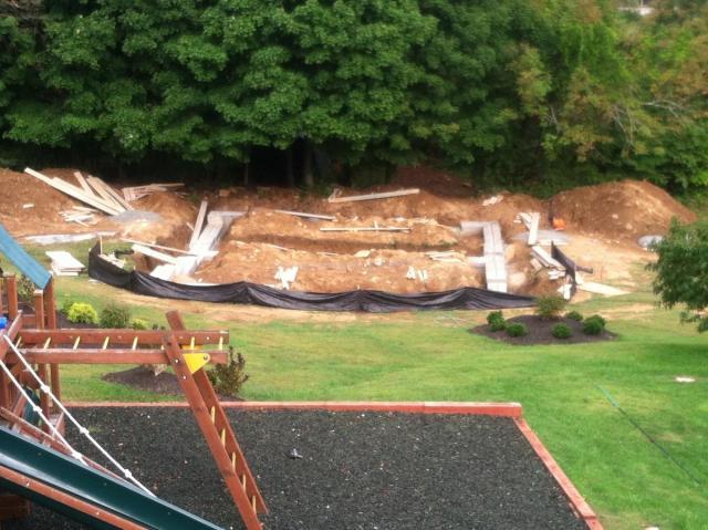

Mason came on Wed. to form however after heavy rains this past weekend it filled the hole with about 1 foot of water and at least 6=12 inches of mud! They said I needed to get it dry and clean. I spent the day yesterday with another guy and dug out all the mud with the machine then hand dug and compacted. Cleaned the ledge and then added 3/4 trap and packed it again. The mason is coming back today to install the forms.
I have to say this is not a fun process so far....

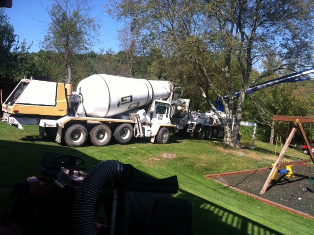

Here is the update as of today... I have no idea why I even told them where my septic was and where NOT to drive the concrete truck... I was in NYC yesterday so I was not here when they drove the truck on top of my septic fields.... :banghead: ... I do not think they did damage other than tear up that side of the yard. They will be back tomorrow and Saturday to form the foundation on top of the footings and hopefully be ready to pour Monday. That being said, I will need to prep the slab and back fill the foundation during the week. Not looking like we will have time to move gravel on a weekend however I will have much to do to spread topsoil etc once this is done.
Geno
Story of my life too.  I don't know if more people are getting the stupid disease or they just don't care.   :banghead:
Brrly1
Half of them are to Stupid to care! The other half is still up in the air!

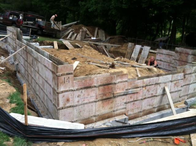

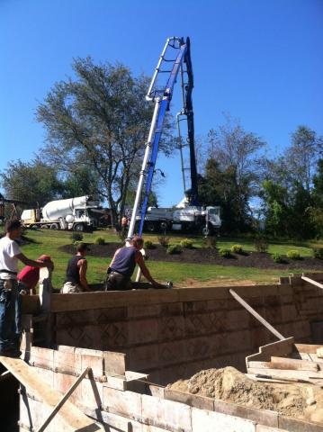

Today the crew was here and finished forming the walls and ended up getting the pump truck on site and poured the foundation. This week I will be picking away at getting the foundation back filled. I am still looking for as much help as I can get for this Saturday to help move gravel with the tractors and carts. It will not be hard work as I will have a dedicated guy on the terramite loading the carts and I will be in the barn to unload.

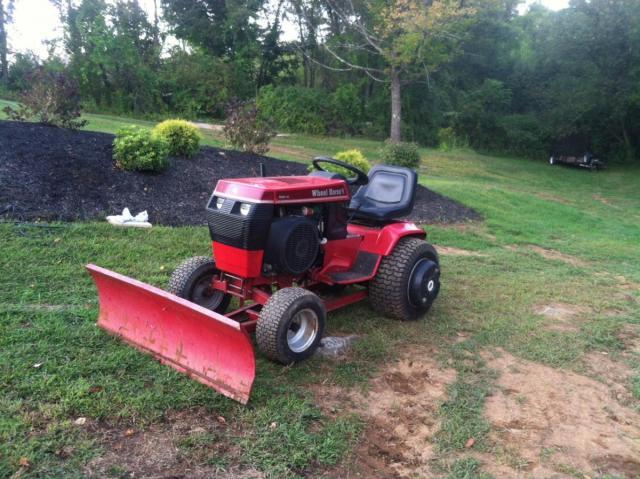

I got the plow mounted up on the 520 ready to push some dirt !!

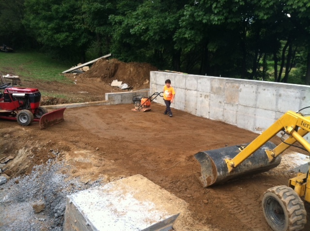

Today I was able to get moving on back filling the foundation after the crew removed the forms. I am just about out of the dirt that I dug out of the hole. I will  be calling for more fill to be delivered this week.
Ken B
Moving along! Man, Brennan is a worker!
stevebo
Ken-
It is the only help I can get around this place.. :ychain:  He really is. I told him I was tired while taking a break for dinner and said I think I am done for today. He said "I will do the hard work, you can stay on the tractor"... What a great kid. We worked last night until we ran out of fuel in the tamper. First thing this morning he said "Dad, we need to go get more gas".  :omg:
