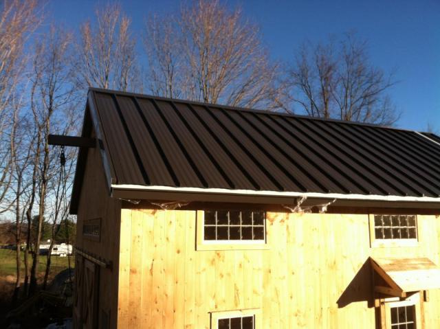

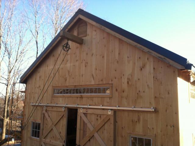

Today was a good dayl Cousins Timbo and Toddbo stopped over and wired up some of the lights. I was focused on working with the two roofers who helped install the rake edge metal and ridge cap. I have to say it was not easy and pretty scary as the standing seam panels are very slippery for sure. They had very specialized bracket clamps that attach to the standing seams. It was dark by the time we got that done. I still have to install the gutter straps, downspouts and snow rail. Here are a few pics showing the rake edge metal and ridge cap. I am officially watertight :banana-tux:

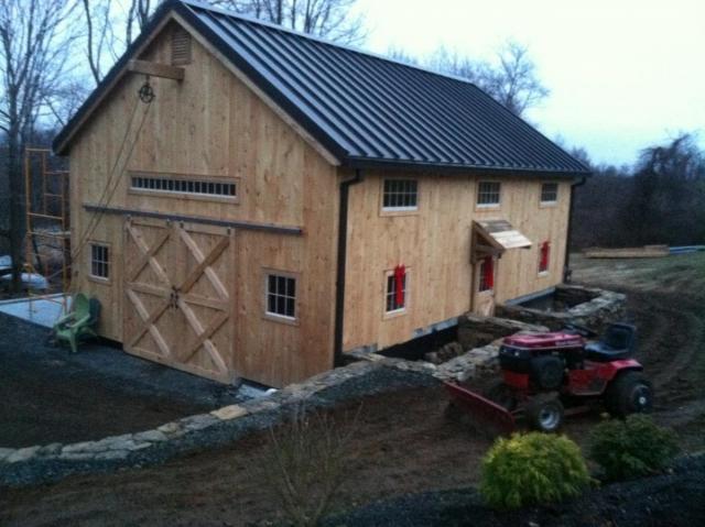

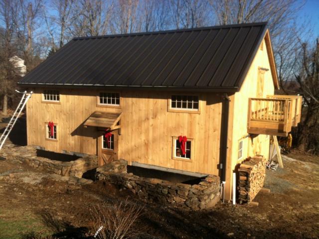

Today I was able to spend some time getting the gutter straps installed and one downspout along with the edge stiffener. Not sure if you can see it in the pic but the right side has it installed. It is basically a piece of angle at the bottom that gets pop riveted to the panel to stiffen it. I need to do the left side and install the downspout. Last thing I need to do is to install snow rail system once I get them....

I LIKE THE RED BOWS.   LOOKING GOOD.    RUSS

stevebo
Bob,

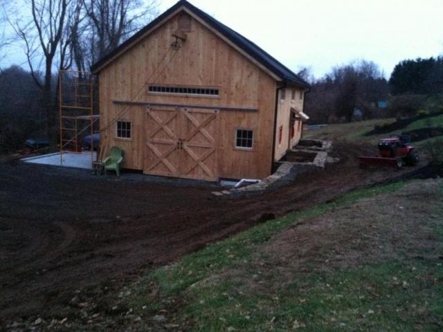

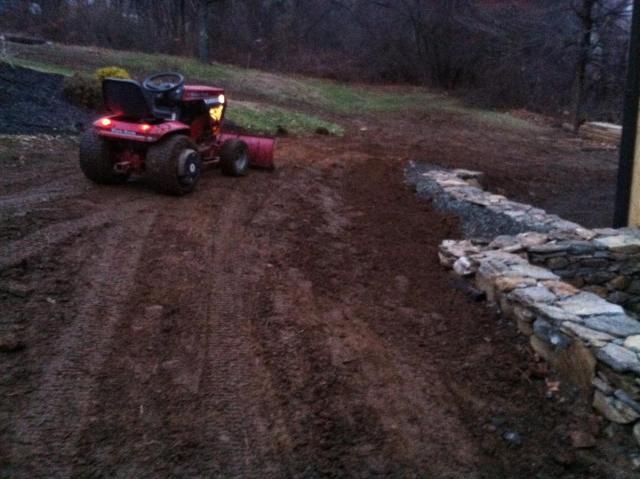

Frame is hemlock and siding is T&G pine. Here is the update for today. With the break in the weather for the past few days I was able to back fill the wall with gravel, level out the mounted up dirt, grade the gravel a bit and finish all the gutters and downspouts except one. I was also able to get all the edge stiffeners installed to. Tomorrow I should be able to finish the last downspout. Once I get that done I may start on the roof over the entry door.
Oh man...the regrading around the walls looks so good.   :thumbs:

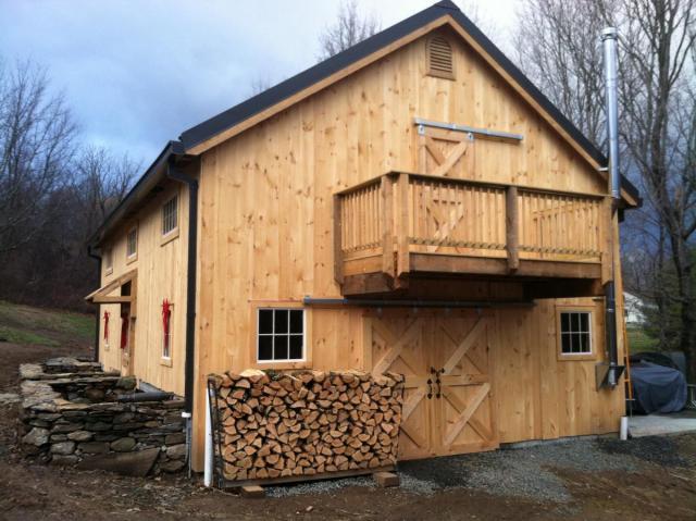

stevebo
Eric-

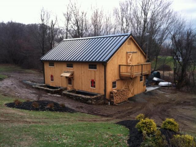

It may but I have no choice on that due to the slope of the property and grade. It had to step down. Today I was able to get the stove piping all set 100%. Now I need to make connections inside. I went with insulated pipe that calls for only 2" clearance everywhere (inside and out).

That looks incredible Steve. Within a short time it will look like it has been there for at least 100 yrs.. Where are the white candle lights for in the window's? :ychain:

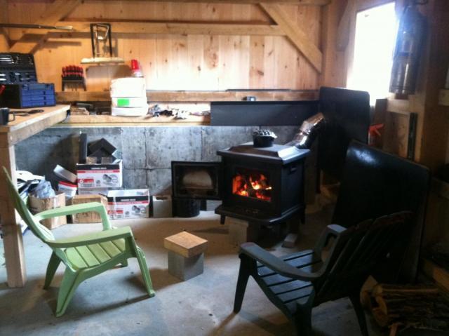

Today I got the stove all hooked up and ready for a cigar with a buddy..... Anyone around Wed. AM we will be in there with the fire going and smoking a cigar and having a nice Christmas drink ....

fireman
You got that thing balanced on cinder blocks? Build a nice base if you need to raise it.
stevebo
Jeff,
Code says that the floor of the firebox needs to be 18" off the slab due to gases. I plan on building it up with blocks under the legs but needed to get it in place by myself which was fun...
fireman
Floor jack and cribbing. Similar to what we do in the fire service. Raise an 1", crib an 1" until you reach the height you need.
