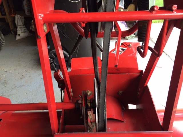

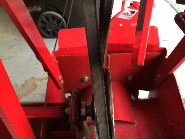

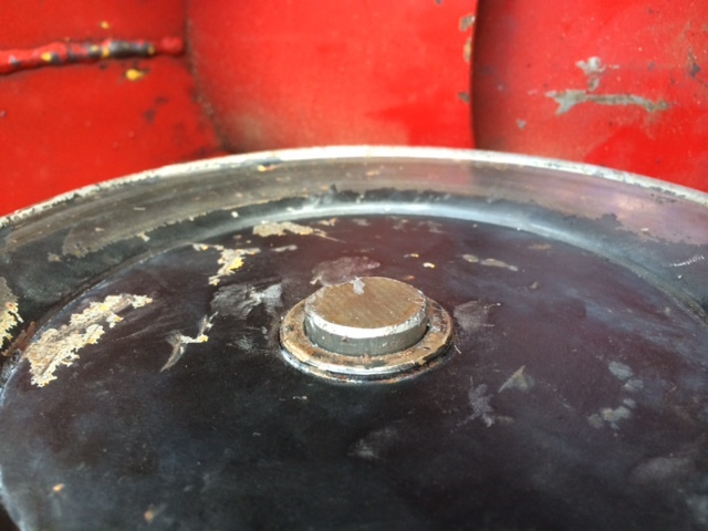

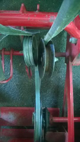

RMCIII 840 #1 Posted July 3, 2014 Here we go again. Picking this up from the winter. If you remember I had asked about the belt fraying on my 42" single stage snowblower. Well, here are, some photos. I did what the service manual called for in set-up when it discussed the belt pully. Making sure it was flush with the shaft. I tried it both flush and now where it is sitting on the shaft. If I make it flush, the belt has an even worse "on - off angle". I compared the mule pullys to one brand new. Measurments are the same so the mule drive pullys are not bent. I am at a complete loss on this. I know if I run it like this, it will chew this belt through, in a matter of weeks. Any thoughts? Rob Share this post Link to post Share on other sites
oldlineman 1,800 #2 Posted July 3, 2014 not sure but from the pictures looks to me that the belt is on the wrong mule pulleys, v should be on the v pulley and flat should be on the flat.I may be wrong but that is what i thing i see from your pictures. In other words swap the belt on the mule. good luck Share this post Link to post Share on other sites

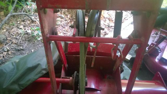

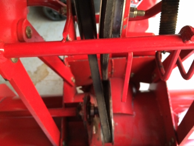

shallowwatersailor 3,221 #3 Posted July 3, 2014 Rob, Here are pictures of mine. It almost appears that mine has more angle to the mule sheaves. John Share this post Link to post Share on other sites
shallowwatersailor 3,221 #4 Posted July 3, 2014 not sure but from the pictures looks to me that the belt is on the wrong mule pulleys, v should be on the v pulley and flat should be on the flat.I may be wrong but that is what i thing i see from your pictures. In other words swap the belt on the mule. good luck After comparing your pictures to mine, they look reversed. Share this post Link to post Share on other sites
oldlineman 1,800 #5 Posted July 3, 2014 looks like to me that his belt is on the wrong mule pulleys v is on flat and flat is on the v that is what it looks like to me. Share this post Link to post Share on other sites
oldlineman 1,800 #6 Posted July 3, 2014 I would think that the blower pulley should be centered on the two mule pulleys. Share this post Link to post Share on other sites

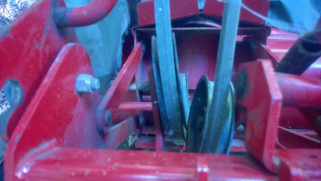

shallowwatersailor 3,221 #7 Posted July 3, 2014 Another shot. Share this post Link to post Share on other sites
doc724 927 #8 Posted July 3, 2014 I just walked out in the garage to look at mine. The flat side (back of the belt) should be on the idler pulley (the flat one). The V side of the belt should be in the v groove pulley. On my blower, the idler is on the bracket that is attached to the big spring (that keeps tension on the belt). Rob, I agree with John, the belt is just reversed. Share this post Link to post Share on other sites
oldlineman 1,800 #9 Posted July 3, 2014 that's what i have been saying all along! Share this post Link to post Share on other sites

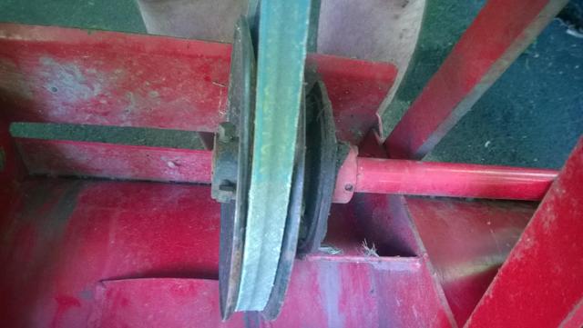

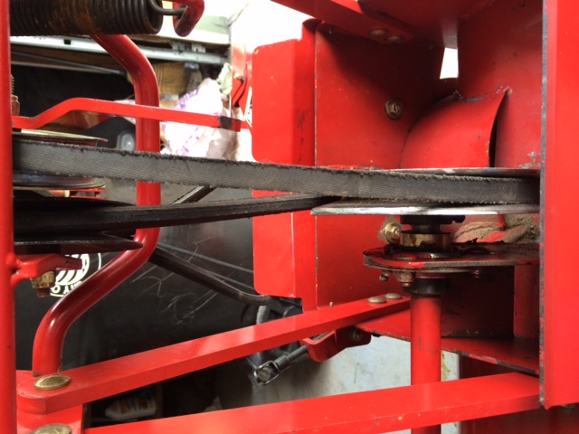

RMCIII 840 #10 Posted July 4, 2014 (edited) I will take a look. But looking at John's belt, it has a slight angle to the "on-off" also. Not nearly as bad as mine though. Photo is now showing belt reversed, but as you can see, still has a moderetly severe angle coming off the bottom of the pully. As you see, I put the pully back flush, as the service manual states. Rob Edited July 4, 2014 by RMCIII Share this post Link to post Share on other sites
Rick_in_CT 156 #11 Posted July 4, 2014 Rob, Comparing your pictures to John's, I see that the drive pulley on John's is mounted with the hub/set screws to the outside of the pulley, where yours are to the inside. This may be altering the alignment of the drive pulley to the mules. I also notice that your belt is sitting very deep in the pulleys. This is either due to wear from last winter, or it is the incorrect width belt. John's belt is sitting up high in the pulley as expected. The drive power from a V-belt is achieved off the sides of the belt, not the bottom surface. Belts should not bottom out in a pulley. From your original pictures was the belt ever run in the "flipped over" position it was originally shown in? If it was, this would certainly damage the belt as it was run inverted in the V-pulley. Lots of heat and wear would have been generated. Now is the time to get this figured out, I recall your frustration last winter. Rick Share this post Link to post Share on other sites
RMCIII 840 #12 Posted July 4, 2014 I see that also, but both the Dealer Tech Manual and the Toro Installation Instructions show the pully with the (2) SQ. HD. Setscrews facing inward on the shaft. Photos attached. Share this post Link to post Share on other sites

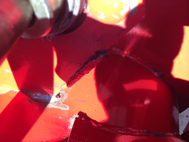

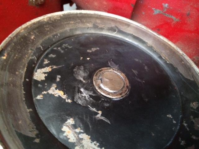

RMCIII 840 #21 Posted July 4, 2014 As a say, persistence pays off! Remove the belt pully, found out that the inside bearing had a broken weld, that allowed the bearing housing to wobble slightly. I'm thinking this is what was causing the belt to fray because the actual shaft was then wobbling. Rob Share this post Link to post Share on other sites
RMCIII 840 #22 Posted July 5, 2014 The Culprit. Not 100% sure this is going to solve the issue, but it certianly is a great start. Rob Share this post Link to post Share on other sites
doc724 927 #23 Posted July 5, 2014 Good detective work. Getting to root cause is always a good thing! 1 Share this post Link to post Share on other sites
