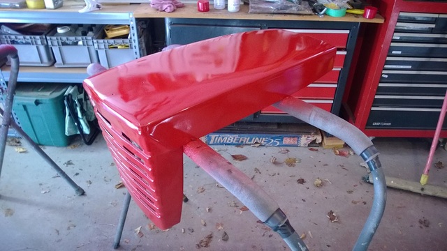

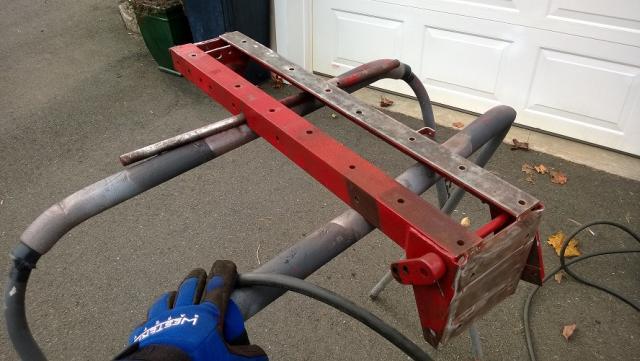

So since my last post I have done some more work. I have been very busy with school and other things so I have had less time to work on the tractor, and because of the lack of time I haven't stopped to take pictures as much. So the pictures are a little on the scarce side. I have been working more on the frame, transmission, hood and, larger parts of the mower deck. In my earlier posts you saw pictures of my hood when it was primed, now I have pictures of it painted. Unfortunately I have to take the paint off again because there are a few dimples on the top of the hood that i have to get out. I stripped the frame and primed it... I only have pictures of it half stripped. I also have pictures of the finished product of the deck shell. I have been working on the engine covers which I do no have any pictures on. Those parts are almost done, I will hopefully have pictures of everything up soon.

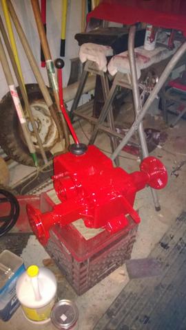

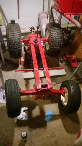

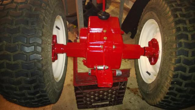

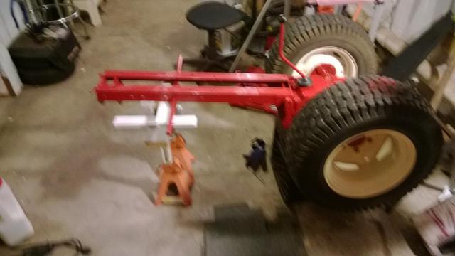

Hello again, I have been hard at working doingall linds of things and im sure you all will be happy to know that the machine is back on all fours and she is coming back together faster than I thought it would. The tranny is painted, I got a new shifter boot on there, all new grade 8 hardware and the wheels are back on as well. The frame is painted and hooked up to the transmission and the front rocker bar and axles are on there along with the front wheels.pictures coming soon
Eric857

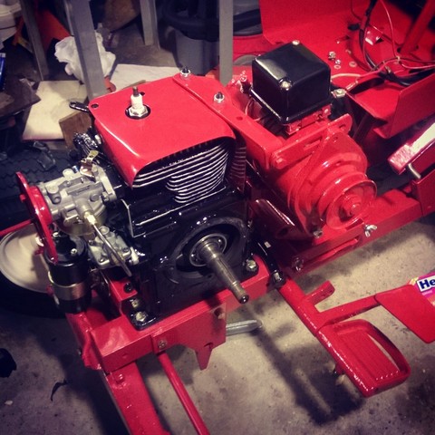

i painted the tranny, got the frame stripped primed and painted, put that together attached the whole front end and the rear wheels got the engine totally taken apart it took me three tries to get the head back on because i kept breaking bolts due to non calibrated equipment and when i tried to get the original head gasket off i wound up scratching the head so i had to get that out, after all that i was able to get the engine primed and painted, i decided to paint it black and i put the tins back on it which were all painted but my father and i looked at it and decided that it needed more contrast so he decided he should strip the cooling fins and paint them a metallic color (aluminum color), similar to what Harley does on their engines. it cam out awesome. I got the engine on the machine and that starter and almost all the other things that have to be on there., i have been fighting with the weather here in ct because i have to paint outside so i haven't been on a steady schedule. My presentation of the tractor is on the 30th of April so I will soon be posting a lot of pictures of the finished product
