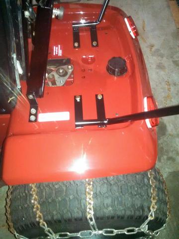

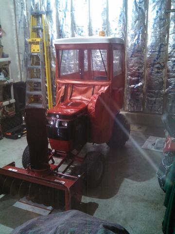

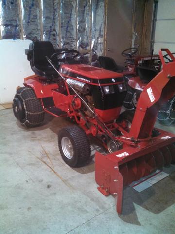

I sanded and painted the snow cab frame. I also was going to try this liquid vinyl on the seat. I also got the snow thrower, chains and wheel weights on today.

JERSEYHAWG /  Glenn
Coming along nice, My seat needs the same repair. Lets see how that works. Nice.
Looks like me and you have twins, only no cab for me yet. Its on the list. Matter of fact, no snow yet either. Lol

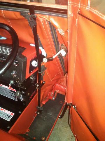

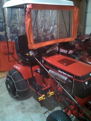

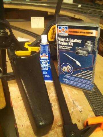

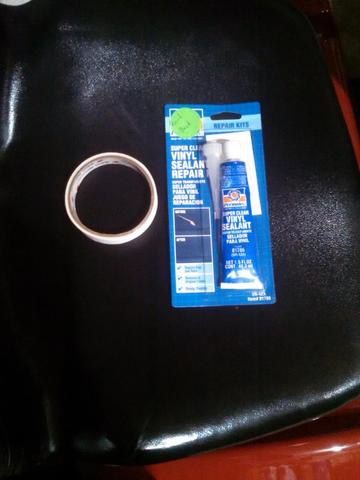

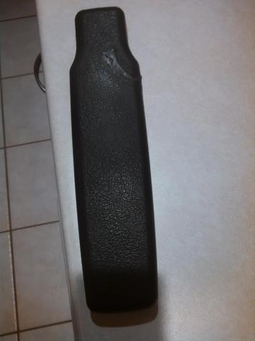

I used the Liquid Vinyl Repair on one of the armrest that was ripped. When it's done setting. I'm going to try a  Vinyl repair kit to finish it. I finished installing the cab yesterday. I want to move the strobe light forward about 1 1/2 feet. Thanks for the comments. It's motivating!!

JERSEYHAWG /  Glenn
Nice job on that cab.....looks great. Your doing a really good job.

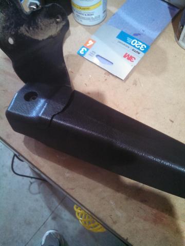

The armrest turned out decent. It's nice to use products that work.

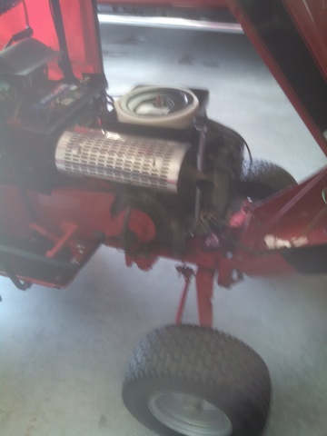

I took the top off the carburetor and cleaned everything. It was surging at lower r.p.m.'s I also put a new fuel filter and gas lines on the 520H too. It runs great now.

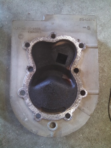

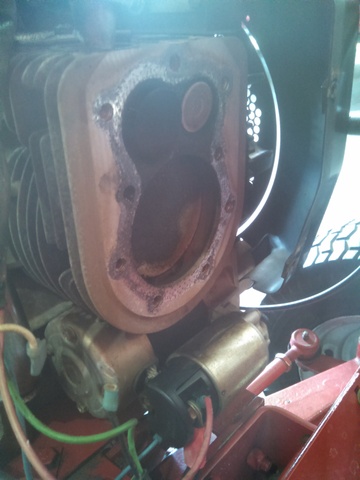

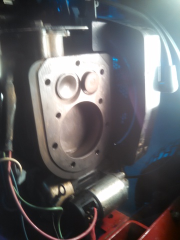

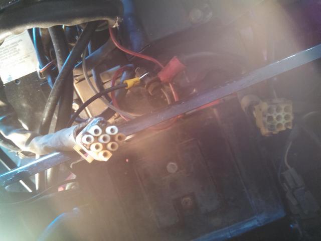

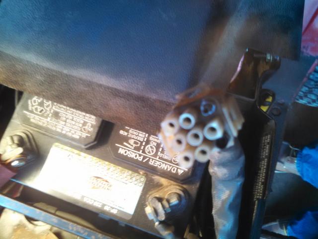

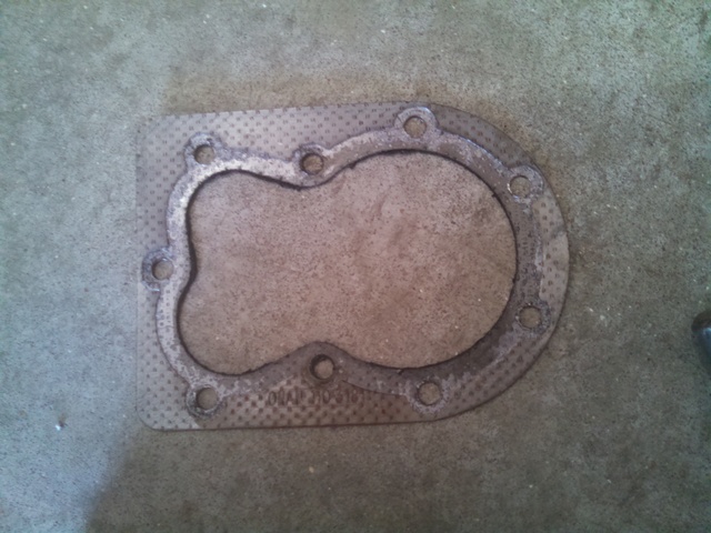

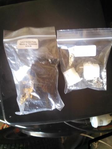

I was investigating why the tach didn't work and why it quit charging twice this winter. I couldn't believe everything else worked. I'm going to put these in.
post-5623-0-92717200-1426966658_thumb.jp
post-5623-0-61747100-1426966683_thumb.jp
post-5623-0-77903500-1426966853_thumb.jp
Edited by 608KEB
608KEB

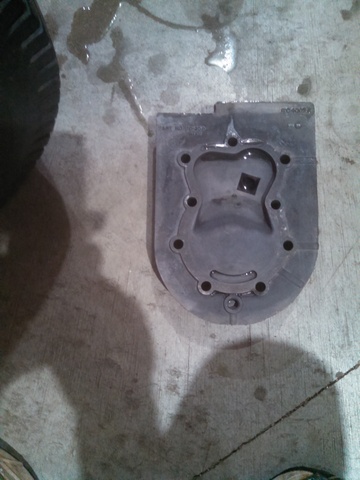

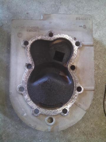

Adjusting the valves and going to clean the carbon off the heads. 1008 hours. The valves weren't out of adjustment to bad.
Edited by 608KEB
