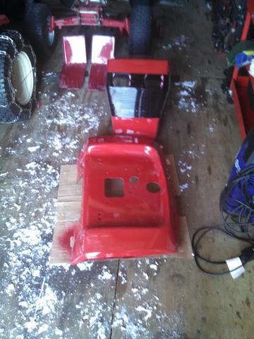

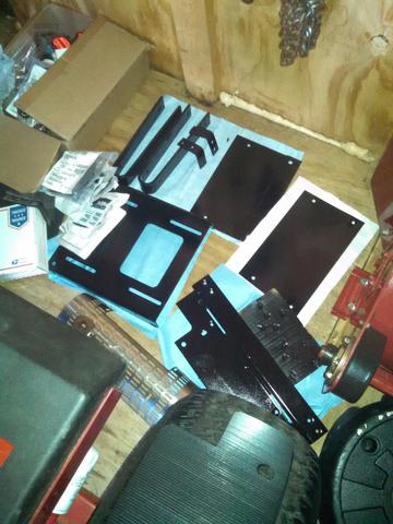

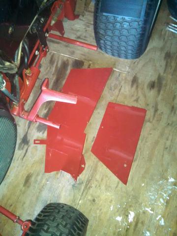

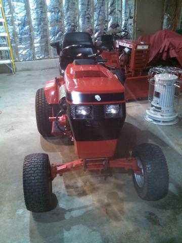

Hi all, I picked up the tin parts from the bodyshop man today! They turned out great he bead blasted the parts before painting. Cheesegrader, to get the dent out by the headlight, he took two rubber handle hammers. He put the rubber handle against the dent and pounded it out. I thought that was a great idea. I'll post better pictures tomorrow of the painted parts. I matched the paint from my 75 C-100. So the paint has more red in it than the original paint. Paint code, RS910 IB Spectramaster Red, Dupont Urethane Ful-Thane 2K

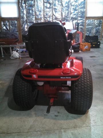

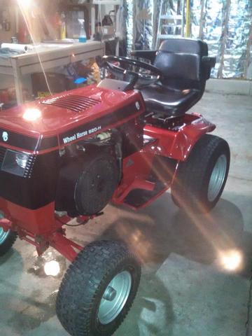

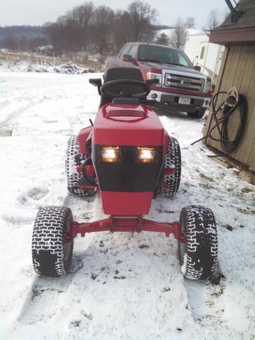

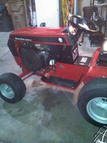

Got the tins on. I have a set of decals from redo your horse. They look great! I still have to adjust valves etc. I will post my progress.

Geno
That is one shiny tractor.   :handgestures-thumbsup:

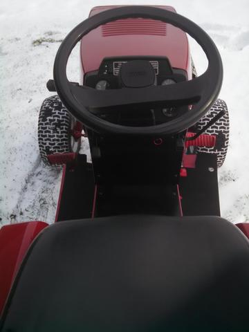

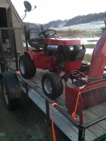

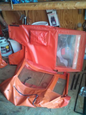

I got a cab with the 520-H when I bought it. Is there anyway to bring the color back some? Also wondering if there was something that could be used to remove scuffs from the windows? I have been looking online at different products to restore vinyl. I just don't know what to try.

Zeek
Looks nice, good job  :handgestures-thumbupright:
KyBlue
You've done a great job, and the tin's look amazing!!
As to your windows ... try this video.. Since those Vinyl windows are the same as whats used in the jeeps and convertible tops...
  • Like 3
MalMac
Mother's Back to Black works real good on the vinyl. Helps bring color back somewhat, but it really soften's it up so it does not become brittle. That's what I use on my cabs.
  • Like 1
I've been thinking my cab windows were kind of cloudy but wasn't sure what, if anything, I could do about it. Great tips! Thanks!

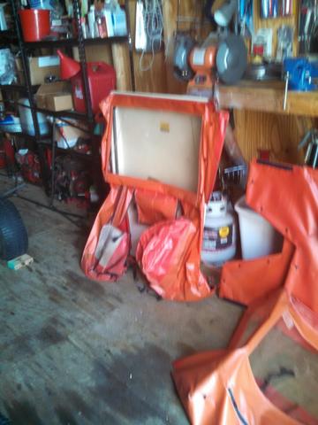

I was looking for a few tips on how to repair some small holes that are in the snow cab that I have.

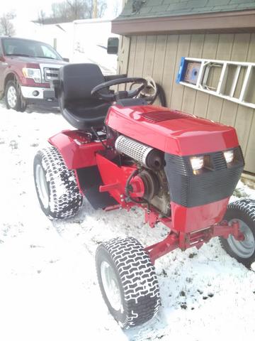

After reading through a few threads about onan/Nikki carburetors(Thanks for the input Martin). I checked the fuel pump. Then I poured some Sea Foam into the fuel line after I got the engine warmed up. And now it runs great! Idles right down too. I was wondering if anybody has tried spraying water into the carburetor to decarbon a engine. I have not done it myself. But I saw some video's on " you tube". Any thoughts on this?

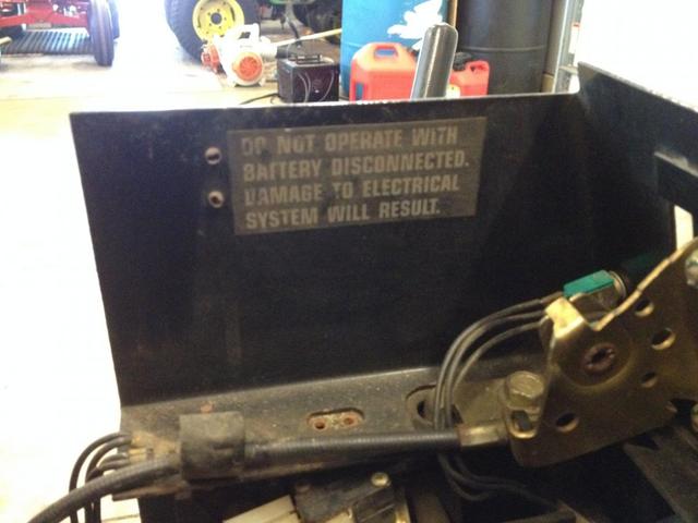

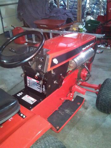

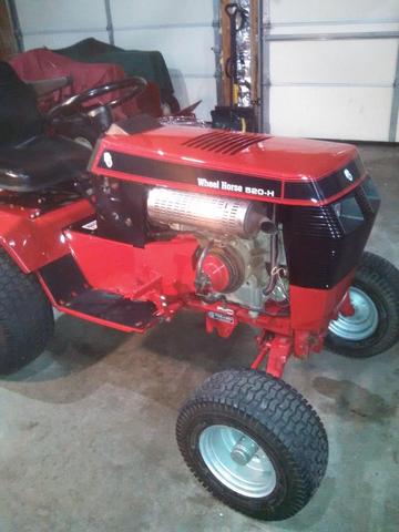

I put the decals on this morning. hats off to Terry at Redo your Horse. They look great! I was wondering where the battery warning decal goes on the hood?

Martin
battery decal goes inside the hood stand above the pto on the 400 series, I'm thinking the 500 would a similar position, even though the sheet metal is different.

Geno
You have to wear sunglasses to look at that thing.  :laughing-rolling:

cheesegrader
That is Sooooo pretty!  Almost too nice to take out to work!
I'll try the hammer trick on the hood this spring.  I have the Cozy Cab and the two-stage blower on it this winter, so I have to live with it for now.
I don't think putting water into a hot cylinder is a good idea.  I would feel bad if it took care of the carbon, but cracked the block in the process.
I've seen it done without damage, but I plan to take mine apart and scrub it out the old fashioned way.
Your choke problem sounds like a dirty carb, but I would also replace all your old fuel lines, and check to see that you have a strong fuel pump.
I've been impressed by how ratty the interior of old fuel lines looked in my last few tractors.  That crap has to be breaking loose and getting into my carb.
I now have a spare carb, and it is very, very clean.  Next carb issue I have, the new carb goes on, tractor goes back to work, and i deal with the faulty carb when I have time.
