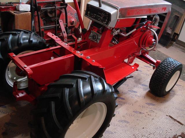

Always a problem matching red colours. It's the worst colour for stability and will vary according to surroundings (if shiney) and light. I try to match them outside when overcast. They say that light from a northern direction is is best on our Latitude (Artists use this method)....I kid you not.
IMHO , I prefer to keep the semi aged, faded Red. but with a good shine/finish. So mine came out nearest to RAL 3000. Both my Tractors had slightly different shades of original non exposed paint, so pretty inconsistent.
Here's an example on the 74 C-120 where the colour behind the old decals gave me a near match, plus there is a good original painted Deck in the background for comparison. Wheels are Diamond White, similar to the US Wimbledon White, a Tad creamier than the original ...pic taken with daylight Strip Tubes and natural light with no flash..... should zoom in if you click on it
post-3520-0-48498600-1361720169_thumb.jp
By the way, Vapourmatic paints are Enamel based and low VOCs, but the Thinners are the Iffy volatile liquids !!!. Good paint though.

Thank you for shareing your wise knowledge Richard. :D

That's interesting about light from the north being the best for looking at stuff... Your full of handy info Richard  :handgestures-thumbup:
