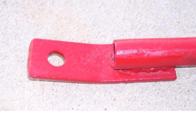

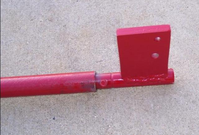

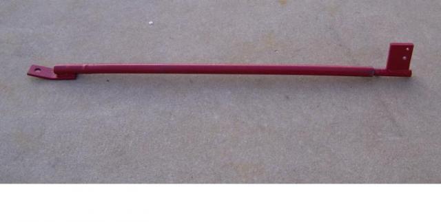

Picked up a B80 with a 42" Snowblower. Missing the lift arm. I have heard and seen some pictures of the flag, lift tube. Can anyone provide a picture or two of how it looks underneath hooked up and some measurements for fabrication purposes? Would really be great, Thanks. I will post a few pictures tomorrow after daylight when I can get some good pics. The person who sold it to me said he lost these parts.

Here's a good start:
More information can be found by using the search box in the top right corner. :handgestures-thumbup:

Heres how it hooks up:
Thank You that helps a ton, and the snow will be falling way too soon. Have work to do now...... Thanks again
Mike.......
Thanks to you as well, thats what I love about Wheel Horse owners, always willing to share. I was digging around looking for this forever and just looked with the wrong search words. Thanks again, as always, if you cannot find just ask.

Built one out of scrap steel parts. Did not put the bends on flag but still functions great. Thanks again!!!! Here are some pictures. Also did not put angle cut on flag.

great Fab work!! :D
