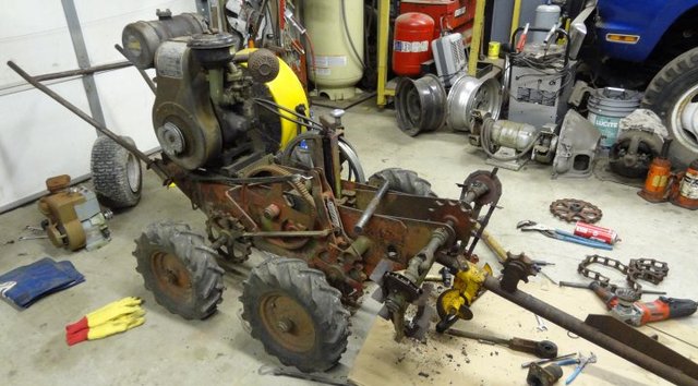

I picked up this old trencher at auction the other day. I was wondering if anybody's ever seen one of these or might know anything about it... Who made it? What year? It has a Wisconsin motor on it.
Any info or helpful suggestions would be greatly appreciated.

Never seen one of those before,Very cool looking! JAKE
SousaKerry
maybe an early ditch witch????
Who made it?
COMMANDO1
MAD MAX............
jones and son
who made it , is what i wanna know, there is a metal tag on the side with only 1-56666 legible.
KC9KAS
Are you planning on making it operational?
jones and son
well yeah, i got the motor running, ordered a bearing for it today and ordered a sproket from the local
deere dealer, i did have it actually running but the sprocket that drives the trencher only has 2 teeth left (out of 8) so it didnt run smoothly and a bearing was smoking hot after 30 seconds run time. i need to get a flat chain to run the wheel drive part of it,will try to get a pic 2moro of the wheel drive set up on it , its pretty interesting how it drives the wheels. I did find out the trencher chain is a ca550 chain, which is still readily availble,

its a walk behind

I've looked around and haven't been able to find anything similar yet. Are there any numbers on the engine? Sometimes you can find the origin searching on the engine info. It doesn't look home made to me. It's definitely an interesting contraption you got there. It's got a medieval look to it where it could lop off a limb if you're not careful.
jones and son
you do walk backwards ahead of it, one step up from a shovel is fine with me, i got the sprocket and hub in today
with a little maching and welding its back together, might get to test it 2moro!its a wisconsin with a magneto,
the tag reads 3x31/4, i'll get the serial # 2moro.
I'll bet it's a beast too...would love to see an in action video once it's up and running. :teasing-poke:

Got it running... I have a video, but I don't know how to upload it... Can anybody help?
PM sent. :thumbs:

it might be outdated, but i stood around talking on the phone while it dug a trench, sounds way better then a shovel to me :)
Does do really nice work, effortlessly, and it's fun to watch too. :popcorn:
