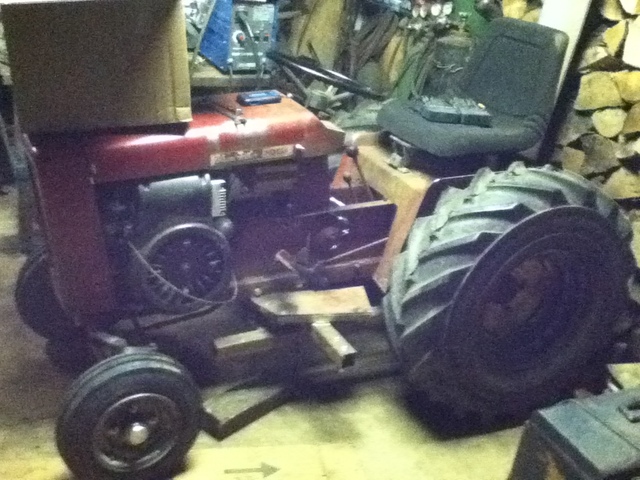

What you could have done is make a cut in the fenders in the vertical portion (where is meets the center section). Then you could weld in a strip of 1" or 2" wide strip of metal in, and then weld the portion of the fenders you cut off back on, thus making them taller.
Also looks to me like you didn't have to cut them THAT far back. Could have left 2 or so inches of the fender portion on and still not rubbed.

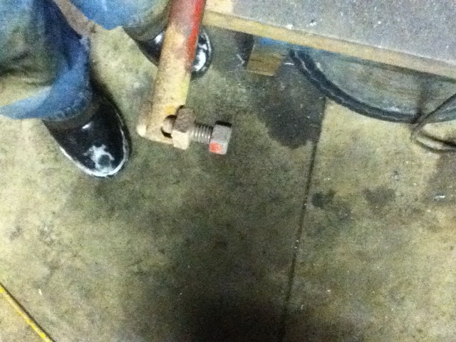

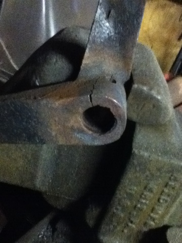

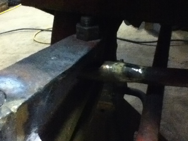

Dropped out the spindles today to get the new ones welded on. I had to heat up the entire bracket that connects the steering rods to the left hand spindle, and in the proccess managed to crack it. Luckily I was able to braze it back together. Spindles are tacked and just need to be welded. The one picture is the POs fix of the steering rod, so I cut of the end and welded on a proper ball joint.

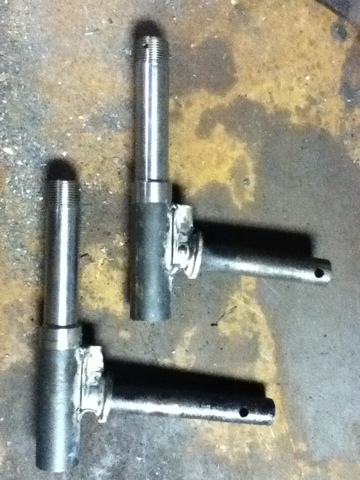

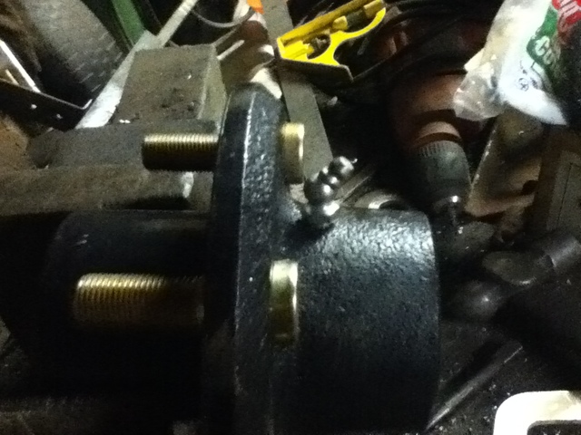

I got my spindles and steering arm welded up today. Front end is together and looking good.
The hubs I bought didnt have a grease fitting and I didnt feel like pulling the dust covers off constantly. Decided it would be best to drill and tap a spot for a grease zerk.

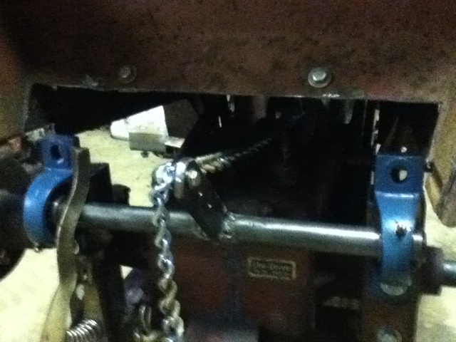

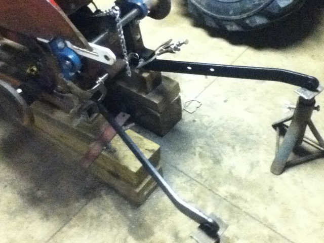

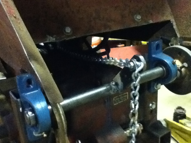

I think I've figured out how I'm going to do my 3 point hitch. I can't really explain it, but once I get it finished I'll let the pictures do the talking. Heres what I have do far:

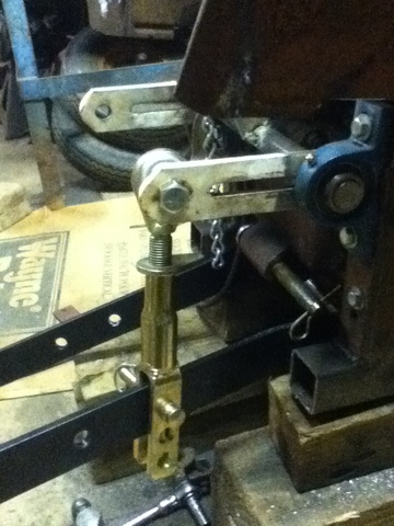

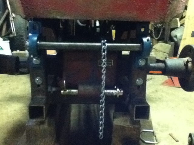

Gained more ground on my 3 point hitch with the arrival of my lower lift arms and other componants. At the moment I have a chain running to center lift.
Now that I've had time to really look things over and think about Nick's idea of a 3 spool valve and replacing the tractors origonal hydraulic setup with my loader pump is the best way to go.
