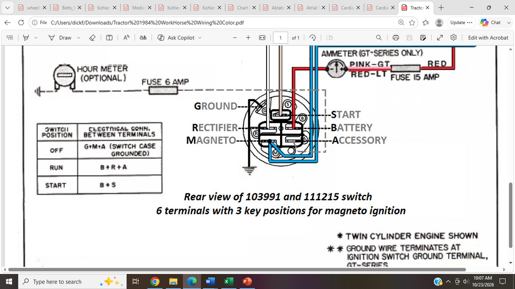

Pictures of the wires would help.  Both engines should have magneto ignition.
Sounds like you may accidentally crossed the kill wire and the charging wire and fried the magneto.

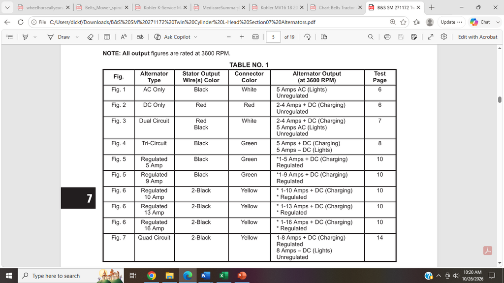

The new engine with it's higher amp charging system only needs the one wire from the charging stator connected. The second wire from the stator to the headlight switch can be connected to the auxiliary terminal on the ignition switch to make the headlights work.
 The kill wire which should connect to the same spot on the new engine as it did on the old.
@gwest_cashould have a wiring diagram for the GT1800, 1848, 1642, 1142, 1100 machines.  Same basic wiring for all.
Pretty sure the wire from the headlight switch to the AC side of the original stator has a green stripe, the kill wire should be a blue stripe, and charging wire should have a white stripe.   Someone please correct me if I'm wrong.  Doing all this from memory.
If all the wires are unplugged from the engine and fuses still blow the problem is in the tractor wiring.
