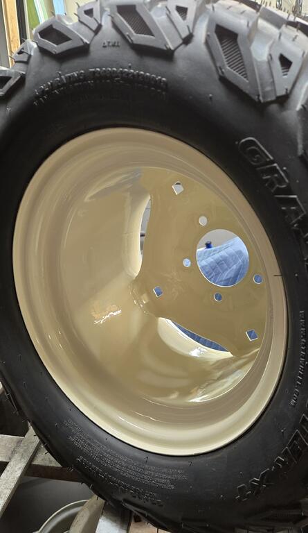

JoeM 10,318 #12 Posted October 9 Picked a set of these up at the show $75, but that was an insider price from Fast Eddie's. That valve stem on the outside is a luxury, but I have welded them shut and drilled new on the other side. 4 Share this post Link to post Share on other sites
sqrlgtr 4,224 #13 Posted October 9 13 minutes ago, JoeM said: That valve stem on the outside is a luxury, but I have welded them shut and drilled new on the other side. Agree they are handier about access but do interfere with some types of wheel weights (i.e. Wheel Horse) . Share this post Link to post Share on other sites

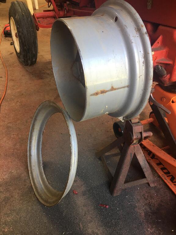

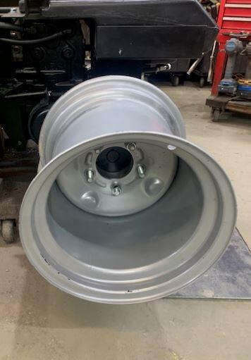

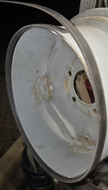

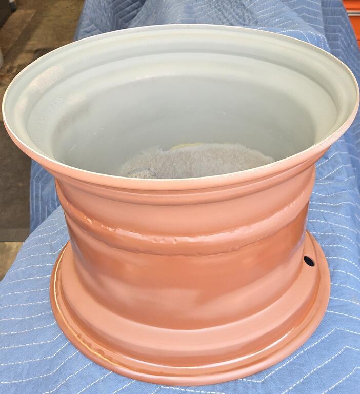

Achto 32,962 #17 Posted October 10 On 10/8/2026 at 9:44 AM, sqrlgtr said: I thought I had seen on here where someone had cut a set of wheels with an angle grinder to widen them but cannot find it now. I marked each rim where I wanted to cut them. Bolted the rim on to a tractor, spun the rim in high gear full throttle, & cut through it with a 4 1/2" grinder After all 4 rims were cut, I cut the center out of the outside rims and welded them together. Finished product. 3 9 Share this post Link to post Share on other sites
sqrlgtr 4,224 #18 Posted October 10 24 minutes ago, Achto said: I marked each rim where I wanted to cut them. Bolted the rim on to a tractor, spun the rim in high gear full throttle, & cut through it with a 4 1/2" grinder I was thinking maybe I might be better off running the wheel faster (higher gear) @Achto couple ???'s how wide are those wheels in pictures and did you weld both inside where tube goes and the outside where center goes or just one side and if so, which? Thanks 2 Share this post Link to post Share on other sites
Achto 32,962 #19 Posted October 11 2 hours ago, sqrlgtr said: couple ???'s They ended up being 11 1/2" wide. I ground the outside down smooth. On the inside I rounded the weld off good but left some build to the weld. The inside rims were rims, this ensured the correct off set. The outside rims did not matter so much because I cut the center plate out of them anyway. 1 1 Share this post Link to post Share on other sites

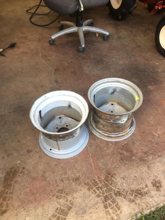

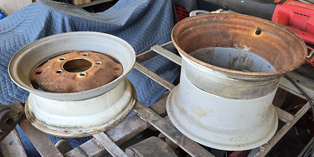

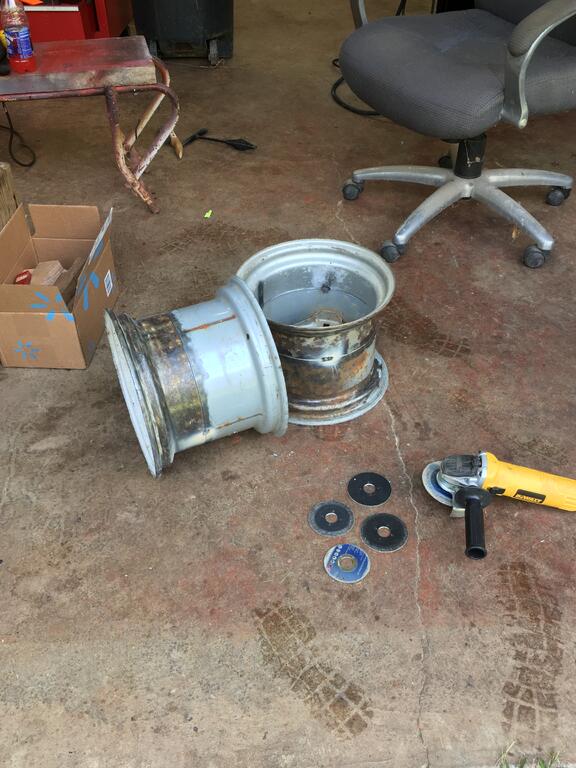

sqrlgtr 4,224 #20 Posted October 12 Decided to tackle wide wheel project today. Got um all cut and got um tacked together. I believe I can make a set of skinny 5/6” wheels out of the leftovers also. Used the 857 that has the LSD 8speed and it worked wonderfully. I was worried the grinder would overcome the differential but only time wheel would quit turning was when cut was almost all way through. FYI I found it easier to finish cut turning wheel by hand instead of letting tractor drive wheel to finish cut. All that is left is to finish welding and priming/painting wheelz. BTW used high gear and almost wide open throttle and a few cutoff disc later I Ended up with almost 10” wide wheels (between beads). 3 2 Share this post Link to post Share on other sites
