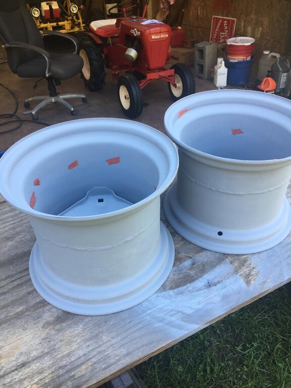

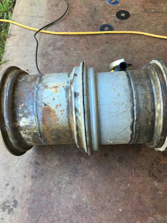

sqrlgtr 4,224 #29 Posted October 13 Got um welded together. Found some old aluminum siding and cut me a strip out and used thatvas a backer for my weld and it worked great. I had them tacked in 3 different places and just welded a1 1/2 to 2 inch bead rotatiing wheel to a different spot trying to keep heat down a little. Ran out of supplies (primer, Bondo, sandpaper etc.) and had to quit for the day. Opie took care of some business while we where at shop also. He is a groundhog killing mochine. This is the eighth one Ive seen him kill and he has probably killed more than that 1 8 Share this post Link to post Share on other sites

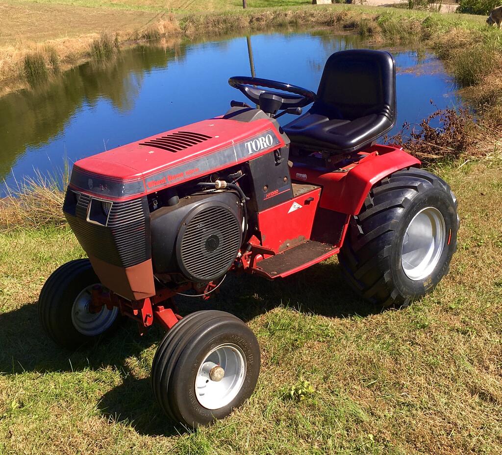

kpinnc 19,105 #43 Posted October 16 19 hours ago, ebinmaine said: What brand? I'm inclined to agree with @JCM 16 hours ago, JCM said: Eastwood Rally Wheel Argent Silver is said to be a very close match. The Eastwood kits I've used have a base coat and clear in rattle cans. It lays down well and the clear offers good protection. It's a bit brighter and glossier than OEM, but it wears in good over time. 2 1 1 Share this post Link to post Share on other sites

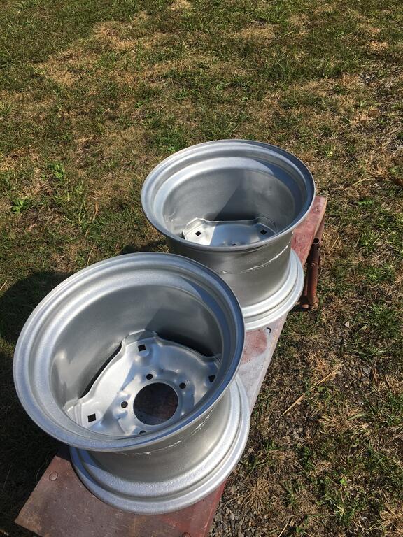

sqrlgtr 4,224 #44 Posted October 16 Got um painted ended up using Rustoleum Metallic. Its closest thing I could find local. I thought they turned out pretty good fer spray bombs. They actually look better in person than in pic’s, sun was really shining, and believe they will match factory closely after they get dirty and washed a time or two. Going to wait untill Monday before mounting tires to let paint cure a little. They are dry to the touch all ready definitely cures faster than the Regal Red spray bombs . 6 Share this post Link to post Share on other sites

sqrlgtr 4,224 #47 Posted October 17 (edited) 7 hours ago, kpinnc said: @kpinnc are those 26x12x12 rears and did you have to modify the fender/seat pan to get them to fit? I apologize if I have asked before my memory isn't what it used to be. Edited October 17 by sqrlgtr Share this post Link to post Share on other sites

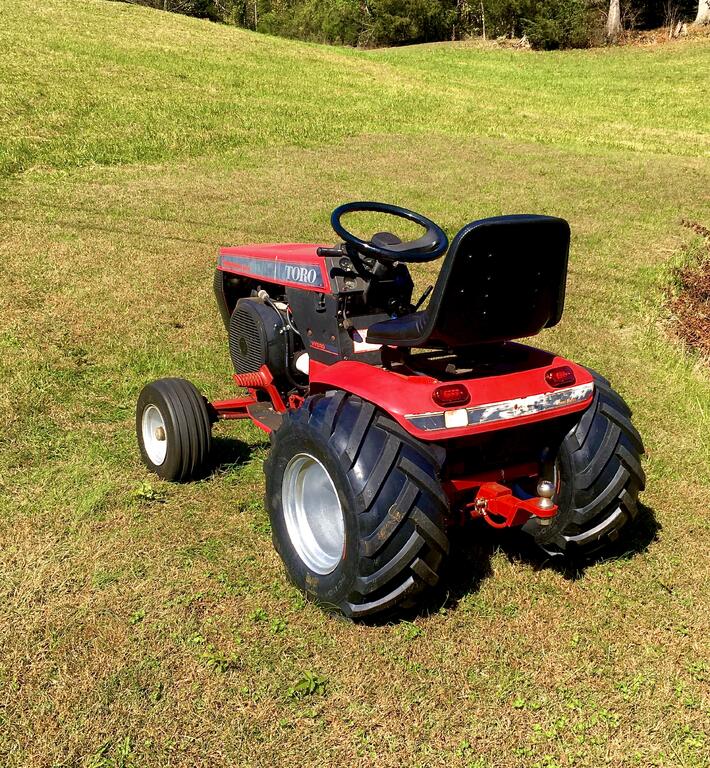

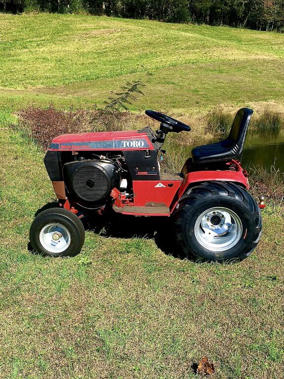

sqrlgtr 4,224 #48 Posted October 19 (edited) Wheels done and Tires mounted (26x12x12)’s on the 520H. Had to massage rear fender to get un tucked under there. Has been a fun project and glad I tackled it. Would I do it all again heck yeah. Ivstill cant get over how bright they appear in pics they are not as bright in real time. They have more clearance in real time than what appears in pics. Edited October 19 by sqrlgtr 4 1 Share this post Link to post Share on other sites
kpinnc 19,105 #49 Posted October 19 On 10/16/2026 at 8:17 PM, sqrlgtr said: 26x12x12 rears They are oddball 25x13-12. ATV tires have some strange sizes! 2 1 Share this post Link to post Share on other sites
sjoemie himself 3,283 #50 Posted November 1 On 10/19/2026 at 9:17 PM, sqrlgtr said: That's tough! Great work. What tires are these? 1 Share this post Link to post Share on other sites
