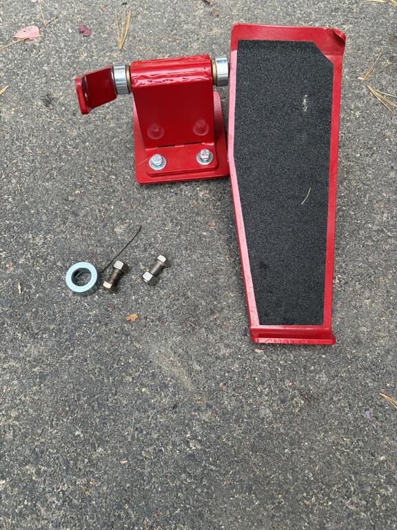

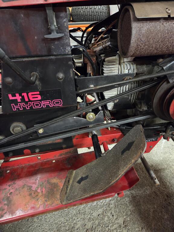

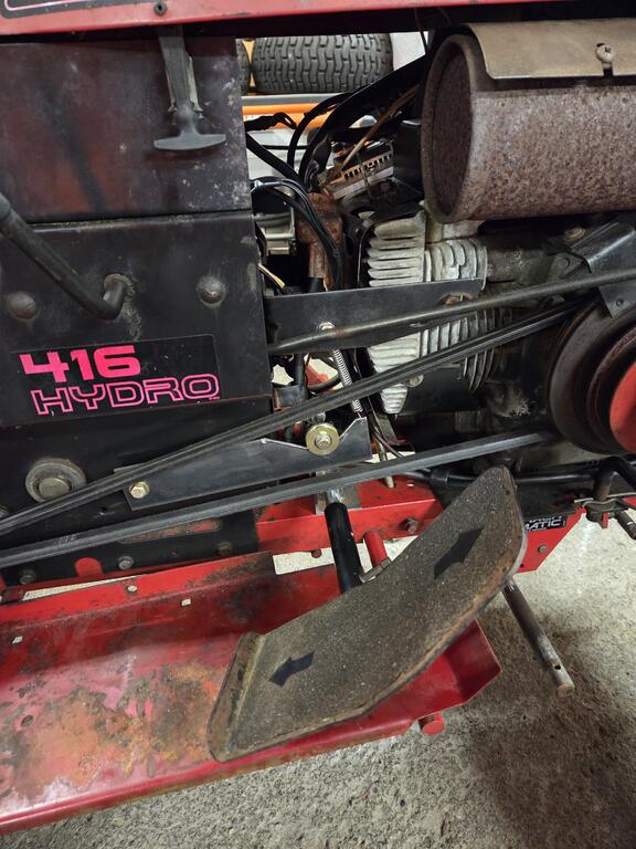

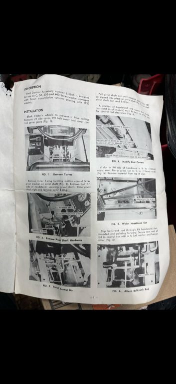

AHS 1,703 #1 Posted October 6 Hey all! Hydro foot pedal from Corey Thatcher. I have one, I haven’t got it mounted yet, here’s some of it. I was chuckling, cause these look like WH directions/ manual. I was interested, do any of you have a foot pedal kit that you have already mounted? 1 Share this post Link to post Share on other sites

WHX?? 58,387 #5 Posted October 6 5 hours ago, JoeM said: Corey made these as a WH re-pop. They were a item at one time for C series ... particularly super Cs. Wonder why this Corey dude doesn't peddle them here? 1 Share this post Link to post Share on other sites

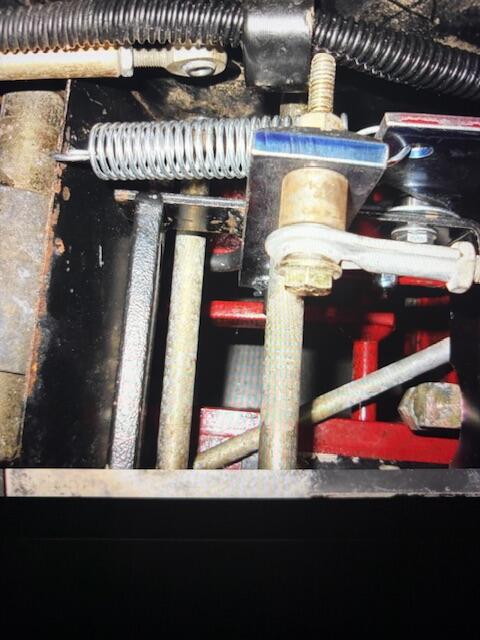

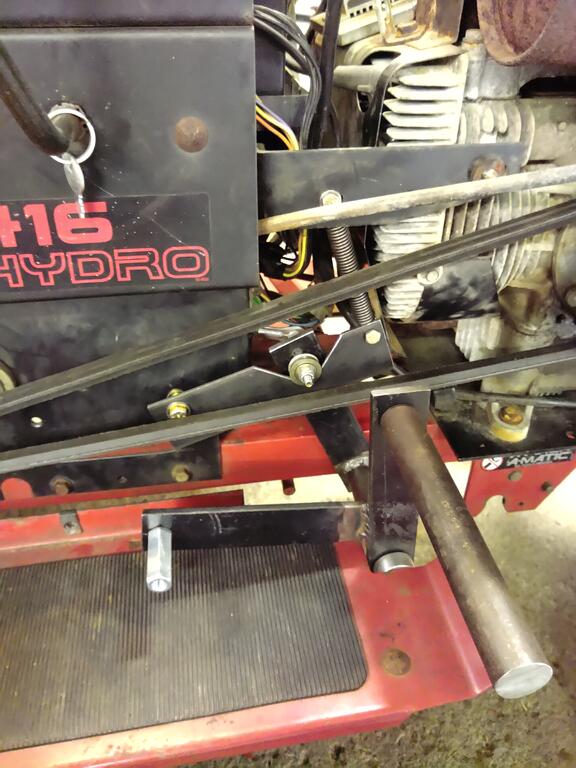

sqrlgtr 4,224 #6 Posted October 6 I took off one of Matts kits, are one somebody had copied off of my 520. Looked like the one in @cleat's linked thread above. It was the first and only one that I had been around and did not like it one bit but now that I have seen a few I realize that the self-centering bracket (the first one in cleats thread) was missing the spring which made it "self center" might have changed my mind. I couldn't figure out why anyone would like a foot control because I could not control it the way it was supposed to work, I was trying to regulate it up and down these hills with my foot because when you lift your foot it would stay in the position you had it in . I would start down a hill and would have to take my heel and try to regulate my speed with my heel, and you can imagine about how good that worked. I said all that to say I believe I will revisit the pedal control again and see if I can get it to work this time like it was designed to work. The one @AHS does look like a factory repro kit and doesn't look much like the kit I have. This is only pic I can find of the one I have but believe I have everything to put it back the right way now. Thanks @AHS you got me to wanting to try it, like I need another project . 1 Share this post Link to post Share on other sites

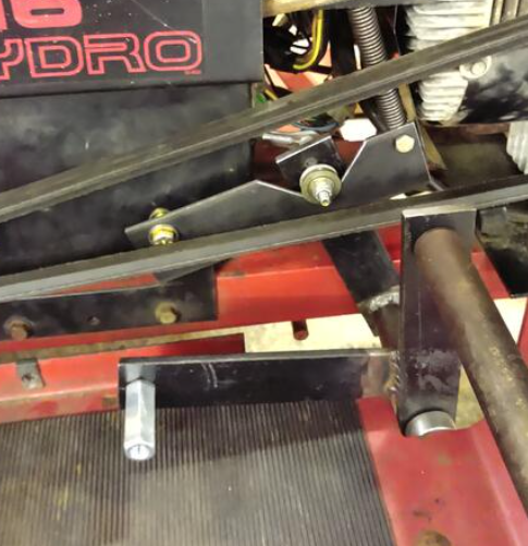

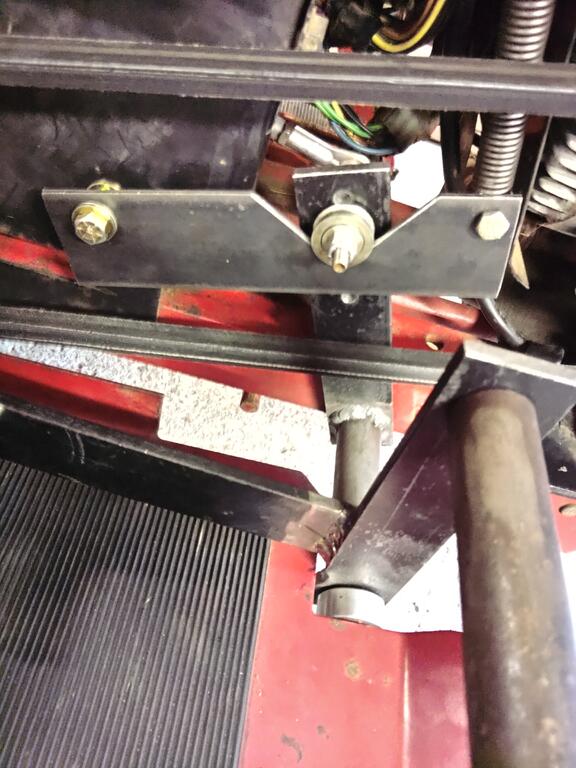

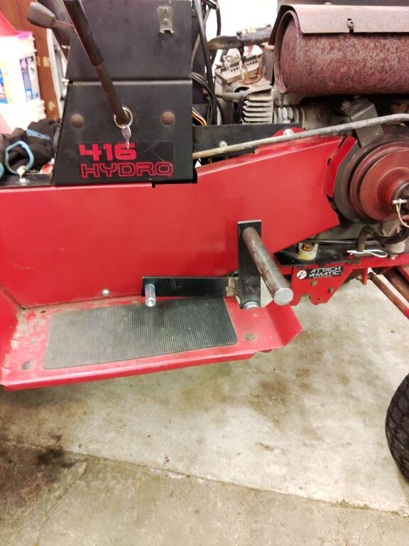

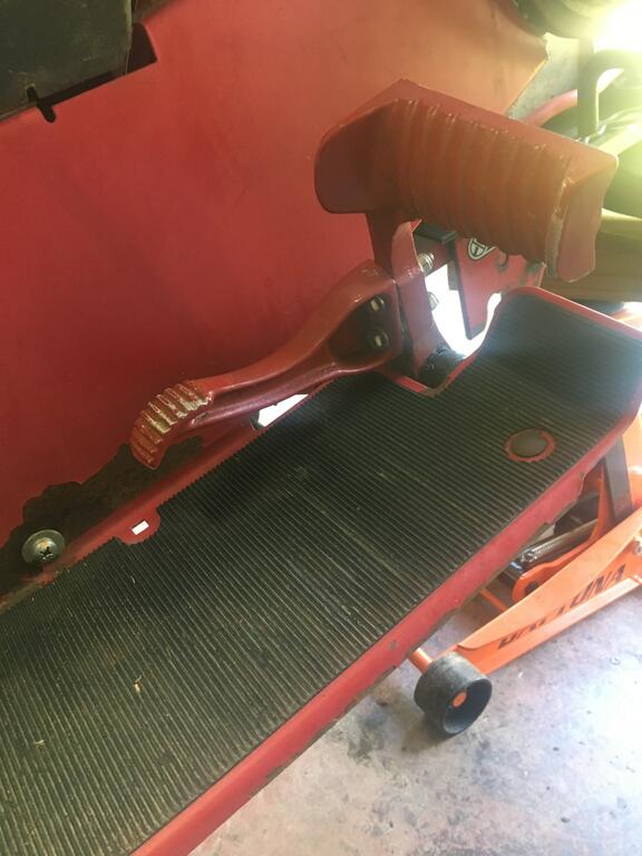

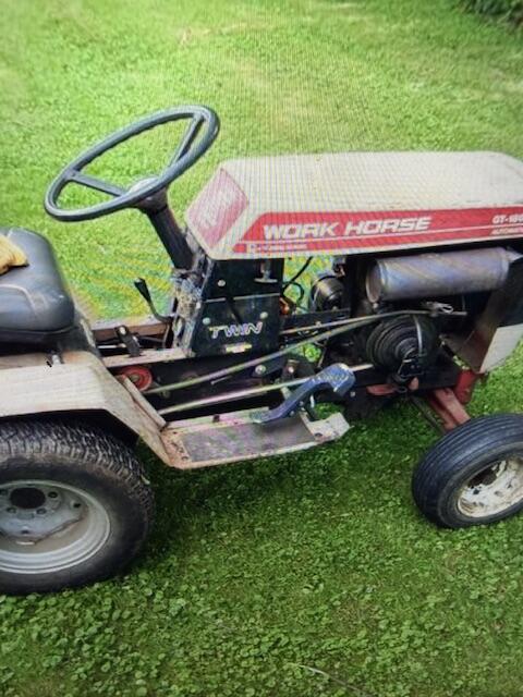

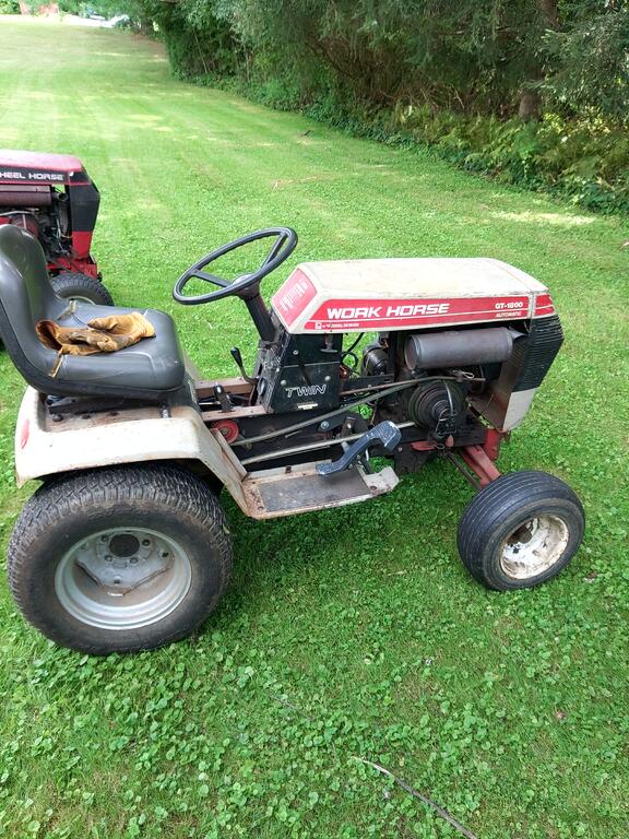

Bill D 3,213 #7 Posted October 6 I've fabricated three different style pedal setups. All self center. One is totally bolt on, just tap an existing hole in the hoodstand. The pedal setup on the GT1800 is my first attempt. The second attempt is shown in the first three photos. That pedal is totally bolt on. The last one was my latest attempt using a pedal from an MTD that I got on ebay. Not sure which one I like best. All could use some tweaking that I haven't had time to do. 3 1 Share this post Link to post Share on other sites
AHS 1,703 #8 Posted October 6 @Bill D i see yours goes back to neutral with that ramp! Neat! Share this post Link to post Share on other sites
Bill D 3,213 #9 Posted October 6 14 minutes ago, AHS said: @Bill D i see yours goes back to neutral with that ramp! Neat! Thanks. It's basically a spin on Matt's return to neutral setup, only in a different location. 2 Share this post Link to post Share on other sites
sqrlgtr 4,224 #10 Posted October 6 Here is another pic of the kit I have it works in the same princeable as @Bill D's but the neutral return plate is located in the trans control tunnel. It is the plate located to the right in pic and I actually wrote on it in black majic marker, but like I said earlier it had a spring missing which pulled it back to neutral. 1 Share this post Link to post Share on other sites
Bill D 3,213 #11 Posted October 6 I built each pedal setup for around $100 or less in materials. 2 Share this post Link to post Share on other sites
AHS 1,703 #12 Posted October 7 Auto center spring, that’s what this is? Return to neutral spring? 1 Share this post Link to post Share on other sites
cleat 9,442 #13 Posted October 7 2 hours ago, AHS said: Auto center spring, that’s what this is? Return to neutral spring? Yes, take your foot off of the pedal and the transmission goes to neutral stop position. I feel this is the safest design as it basically works like a dead man pedal where if you get into an issue or for some reason fall from the tractor, it will just stop moving. 2 Share this post Link to post Share on other sites

Bill D 3,213 #16 Posted October 7 1 hour ago, sqrlgtr said: @Bill D is this the pedal from a MTD mower? I like the looks of it and wouldn't care to try one, I think . That one is from a Kubota tractor. 1 Share this post Link to post Share on other sites
sqrlgtr 4,224 #17 Posted October 7 (edited) 3 minutes ago, Bill D said: That one is from a Kubota tractor. you like it or do prefer one of the others? I like the one @AHS posted also. Edited October 7 by sqrlgtr Share this post Link to post Share on other sites
Bill D 3,213 #18 Posted October 7 1 minute ago, sqrlgtr said: you like it or do prefer one of the others? I like the one @AHS posted also. The one in the first three photos is probably the best. Totally bolt on. I would like to shorten lever that connects to the transmission linkage, but if I do it hits the steering fan gear. The thow of the pedal itself is very short. The arm on the other two pedals is the same length as the cam control in the hoodstand. Much better pedal pressure. Like I said, all could use some tweaking. 1 1 Share this post Link to post Share on other sites
AHS 1,703 #19 Posted October 9 The Work Horse, the foot pedal off a late 80s early 90s Bolens! (I had one), i cant remember what it had for a foot pedal! Honestly, i like both of them. They’re both wicked simple! 1 Share this post Link to post Share on other sites
Bill D 3,213 #20 Posted October 19 On 10/9/2026 at 5:15 AM, AHS said: The Work Horse, the foot pedal off a late 80s early 90s Bolens! (I had one), i cant remember what it had for a foot pedal! Honestly, i like both of them. They’re both wicked simple! That pedal is off a Kubota 1 Share this post Link to post Share on other sites
