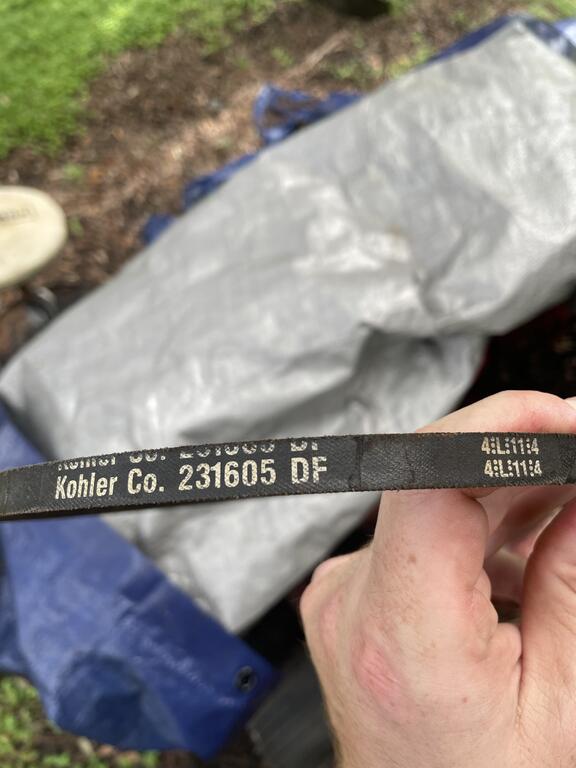

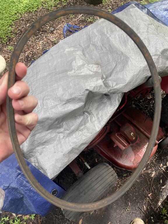

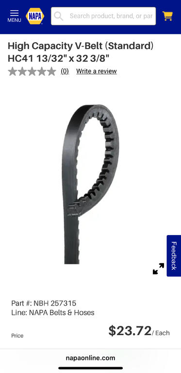

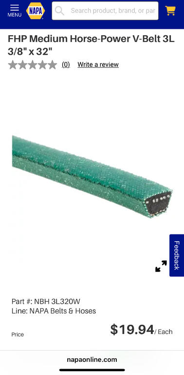

Took my 856 K181 starter gen off tractor to local shop.. they tested it Said it works good and ran a belt on the pulley.. said will crank tractor long as battery charged. But it is not charging so need new voltage regulator Current regulator has 3 terminals front and underneath wire.. can’t find anything online based on the housing #”s.
Also should get new S/G belt. Here is current belt and belt from Napa that supposedly fits.
Edited by FLtractor
953 nut
Kohler 7hp, 8hp                                                      Kohler # 231605                                     3L-32   Notched raw rubber edges NAPA 25-7315
A fabric covered belt like that will not grip enough to start your engine.
  • Like 2
FLtractor
Thank you for belt #. Interesting the # on Napa is a cogged belt unlike what’s on my tractor now.
regarding the Voltage regulator.. do you happen to know of a solar charger i could hook battery to if i decided not to get new voltage regulator?
Edited by FLtractor
  • Like 1
ri702bill
Agreed - you need the raw sided cogged belt. It fits tighter on the S/G pulley and does not slip.

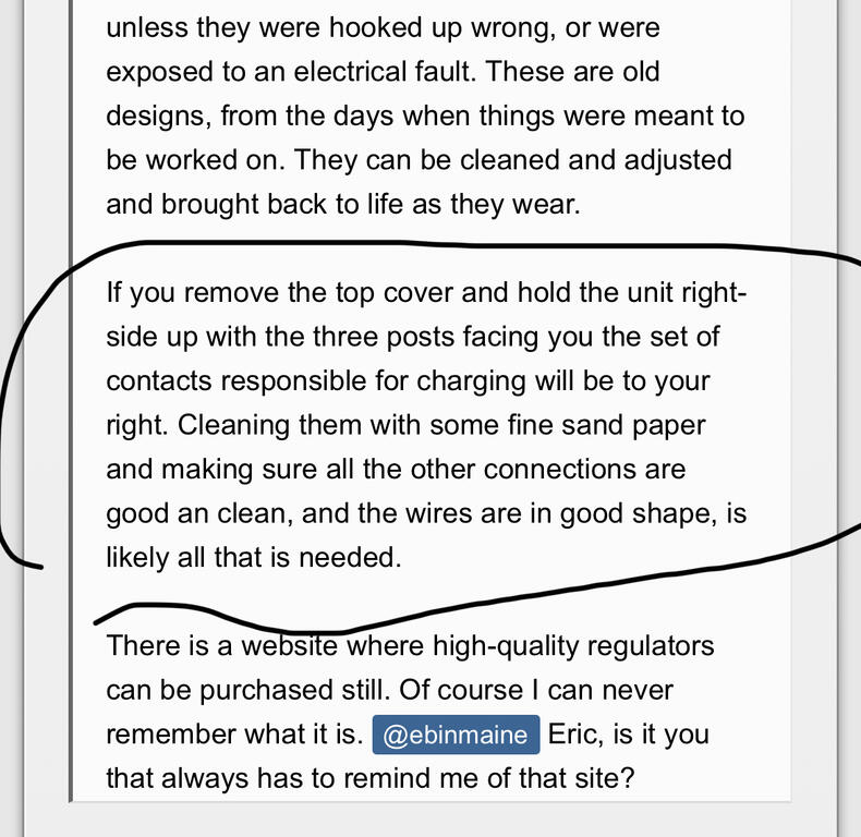

The regulators rarely actually go bad or break, unless they were hooked up wrong, or were exposed to an electrical fault. These are old designs, from the days when things were meant to be worked on. They can be cleaned and adjusted and brought back to life as they wear.
If you remove the top cover and hold the unit right-side up with the three posts facing you the set of contacts responsible for charging will be to your right. Cleaning them with some fine sand paper and making sure all the other connections are good an clean, and the wires are in good shape, is likely all that is needed.

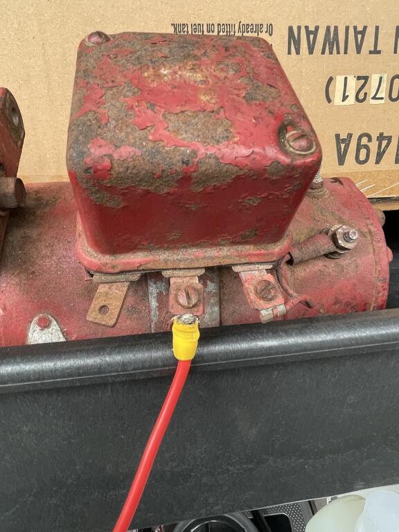

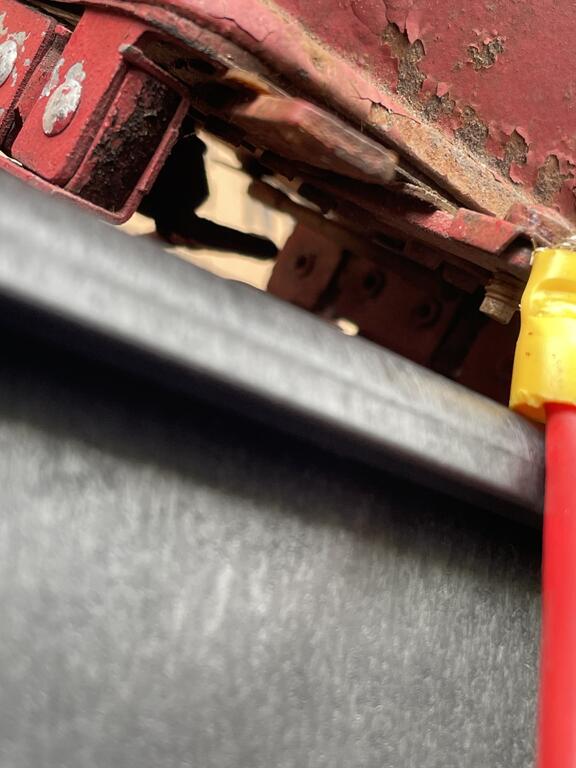

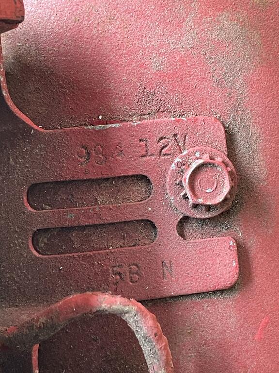

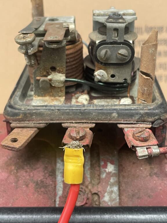

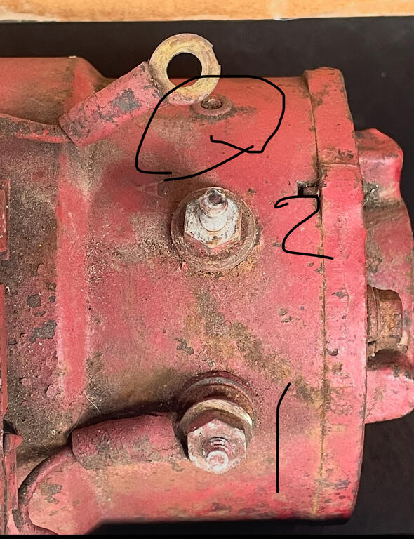

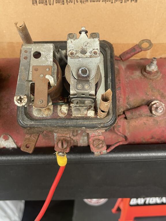

FLtractor
Posted (edited)
There is a website where high-quality regulators can be purchased still. Of course I can never remember what it is. @ebinmaine Eric, is it you that always has to remind me of that site?

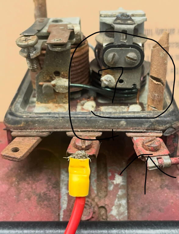

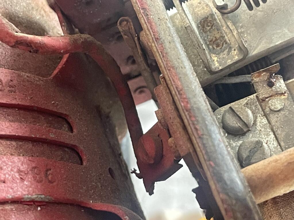

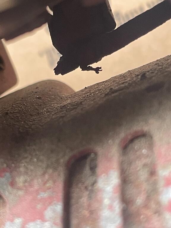

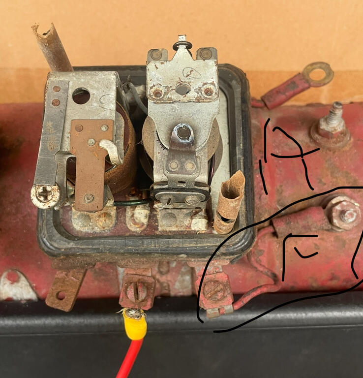

Evening, message some of these questions to Squonk on someone else’s S/G thread as it also related to here.. Did some closer looking at S/G and voltage regulator today … numbered picture.. (yes I know to sand the connections- will do so) # 1 is to farthest right terminal on voltage regulator.. but is outgoing to S/G?
#2… just looked closer and saw this is offically terminal A…. This  is power TO the S/G from ignition switch from battery.
#3.. no # just circled .. is this supposed to be as pictured or is mine broken off?
Also the underneath pic my tab from terminal # 2 wire appears bent and wire frayed in needing replacing.
You mentioned opening the regulator and sanding the far right connection .. but not exactly sure where to sand here .. also does anything else inside appear too corroded or out of place?
Since told the charging portion of the S/G will crank tractor over … the only terminal on the S/G that would affect it having poor connection is terminal 2 A? as in no external wiring except the 4 AW gauge from ignition to  S/G 2 A makes any difference?
So if that’s clean then it’s my wiring that is the issue since charger works and will have cleaned terminals connections.
Please let me know if post confusing and needs clarifying or better pictures.
Edited by FLtractor
pfrederi
If you clean up the Genny you will see an F stamped in it like the A you can see.  The right most terminal on the regulator goes to it.. The wire coming from under the regulator goes to the A terminal.
The center terminal in the regulator should go to Battery+
  • Excellent 1
FLtractor
Terminal F where the wire goes to outside front voltage regulator terminal.. what does that power or do? If starter generator Power goes from battery to terminal A to power the S/G.
Adsm08 mentioned above how I remove top cover and sand for better connection to see if that fixes the non charging voltage regulator … is anything in the front picture of the voltage regulator with the cover off? - posted his reply for better understanding
adsm08
Posted (edited)
Yes. The S/G is the starter and the generator, and as such it needs regulated, which is what the voltage regulator does.
Electrically speaking the only difference between a motor and a generator is the direction the power is flowing.
Quote
Inside the unnumbered circle I believe is OK.  None of mine have anything there. These units do naturally produce heat during operation, that may be a vent of some sort. Anything that goes through heat cycles needs to be vented or it will be put through a cycle of pressure and vacuum that will eventually cause the case to fail.
Next to the 2 is broken. That ring should be bolted down there, but the stud is broken. It is causing at least 90% of your issues. This is the A terminal, it is the connection the regulator uses to control the magnetic field to move the armature, which in turn cranks the engine. This is electro-mechanically the oppsite is what is happening once the engine is running and it is charging. DO NOT REMOVE THAT NUT. The other side, inside the case, is a bolt with a large wire soldered to it. If you undo that nut without holding the bolt from the inside, best case you drop the bolt, worse case you break the wire. Neither outcome is desirable.
That picture is pretty backlit and hard to see. With small, cheap and easy to make wires like this, when in doubt replace it.
Response will be with last picture.
Hard to tell from a picture.
A terminal cranks, F terminal charges, if I recall correctly. As pictured the most likely outcome is it charges but does not crank.
You have a very nice, original, adjustable regulator here. I would do everything I could to repair this piece and keep it rather than replace it. A modern production one will not be as nice, and if it even gets close it will be expensive.
The point that I was referencing is on the right in this picture. Push down gently on the top of the tower with the two screws facing the camera. The spot the two piece make contact is the point to clean.
The tower on the left has a similar contact point which is more easily visible in the picture. It is on the bottom of the rust-colored tab, straight up from where the black wire is soldered.
The point in question on the right side SHOULD be directly under the circle in the middle of the RH tower in this picture.
Finally, that center connection is atrocious. I would look at replacing that wire end with a proper ring terminal. That will delete the square washers. I will post links to some good wire-working tools and supplies down in the main body of my response.
There is certainly a lot to unpack here. I am going to put my responses in red inside the quote to try and keep them as close to the question they are answering.
Wire stripper: https://www.amazon.com/dp/B00IXAK7DE?ref_=ppx_hzsearch_conn_dt_b_fed_asin_title_1
I like this wire stripper for a few reasons. It is easy to use, works well in tight spots, has an integrated cutter (and supposedly a crimper, but  I've never figured the crimper out), and is easier on the wrists and fingers than a lot of the plier-style strippers. The biggest draw-back is that it does not work well on wires smaller than 18 gauge. There should not be any wires that small on your tractor.
Wire crimper: https://www.amazon.com/LEONTOOL-Wire-Stripper-Compact-Non-Insulated/dp/B0CHMLCJW4/ref=sr_1_19?crid=K3XCF0X3F9SF&dib=eyJ2IjoiMSJ9.3s25cFWOlDGBp_Cc5bsnhhDPDzKYZ924SOqEVx08ZnFDVkAp9c7HvqoHDJsMXAnr_PCWaisu1lOad_im2Rpn8xhZzjbR3pIGKEBhJI9LQJuHUdtDlFKByYQWtrx_ykStwtfg7iu655gMzA0q_uLyNwey3EjnE8ghoBOpid1Z3z8YoQvX00OfdVgendFnb0Qb05j6MkTeaQ1E9uIUbLj-id8oELquch1M_X3ruJt3M07llwvZSd8S2BFTJepgpFy-ONM7ACpam2OCtpJ_50UUW7pLmJXpVGlK7_deVAQZGXw._UpyhpH44IX99zRBAcLB7z0L_nQhdnam6cegCUQ4yCk&dib_tag=se&keywords=wire%2Bcrimping%2Btool&qid=1790982426&s=hi&sprefix=wire%2Bcrimp%2Ctools%2C150&sr=1-19&th=1
I have not used this exact one personally, but this style wire crimper is good. The stake near the tip should be used on every crimp. A non-staked crimp can come undone much easier than a staked one.
Ring terminals:https://www.amazon.com/600Pcs-Heat-Shrink-Connectors-Electrical/dp/B0CYM4Q816/ref=sr_1_1_sspa?crid=1DD3XJIIYSE96&dib=eyJ2IjoiMSJ9.eHygAPEFMm4zJSUjb2VRW5sSHnfpK6r6HiFMx0eQc5gcJARSY35MhOdhDqN3VmVrZYE9Mkcl9O5B8zI_-smlpUZshuoKZGeiwB70bydmV6R2_J-EtvS1N8GMK7V5aCH6BNreWyMUueDxDtCZQswbl84vHv77V9B5DdKgdtCbPkXDQniL8RWvUzLaNxZ83ejYtpWCsCVeUK5Xl92DxN4_9Nz49Buixr5IURn9oRYweiaR7q5-Uu2vQl4R2LuqlL7NSEj9Uc6pvzCQckCJ3cr5vx0xjQ71oIKBwEs02aGR-A8.xmMMyzIZYjBVr3iZ3UINWGTxYj3eocn0HPHLoSumUTI&dib_tag=se&keywords=wire%2Bring%2Bconnector%2Bassortment&qid=1790982563&s=hi&sprefix=wire%2Bring%2Bconnector%2Bassortment%2Ctools%2C121&sr=1-1-spons&sp_csd=d2lkZ2V0TmFtZT1zcF9hdGY&th=1
This is not the highest quality set, but should be good. It has heat-shrink tubing pre-installed. Heat shrink is a MUST for any wire repair. After the connection is crimped you heat the tubing and it shrinks down and seals out moisture and provides electrical insulation at the connection, both are important.
Heat shrink tubing: https://www.napaonline.com/en/p/NW_729137
This is needed for proper sealing of repairs made mid-wire. Always buy adhesive laden tubing. It has something like hot glue in it that will flow out and seal once it is properly heated.
The pieces in that kit are 5 to 6 inches long, and can be cut to length. Typically, for a well done repair, a piece 1.5 inches long is sufficient.
Heat gun: https://www.harborfreight.com/1500-watt-11-amp-dual-temperature-heat-gun-56434.html
This, not a lighter, is the proper tool for shrinking heat shrink. The link is to the exact one I own.
Butt crimps: https://www.amazon.com/SVAAR-200PCS-Tinned-Copper-22-6/dp/B08R2N8F46/ref=sxin_12_pa_sp_search_thematic_sspa?content-id=amzn1.sym.c50e4cd8-fa0e-4c88-b77e-b1f9601d89fd%3Aamzn1.sym.c50e4cd8-fa0e-4c88-b77e-b1f9601d89fd&crid=3LK4A8SF8VHHS&cv_ct_cx=butt%2Bcrimp%2Bconnectors&keywords=butt%2Bcrimp%2Bconnectors&pd_rd_i=B08R2N8F46&pd_rd_r=1bab920f-2322-4f7d-9136-d6303b094c8e&pd_rd_w=q0SMl&pd_rd_wg=fF1sb&pf_rd_p=c50e4cd8-fa0e-4c88-b77e-b1f9601d89fd&pf_rd_r=BHX8K4G9ZSGD0T7KG5GK&qid=1790983028&sbo=RZvfv%2F%2FHxDF%2BO5021pAnSA%3D%3D&sprefix=butt%2Bcrimp%2Caps%2C156&sr=1-4-e169343e-09af-4d41-85b1-8335fe8f32d0-spons&aref=j0Mj2lguoq&sp_csd=d2lkZ2V0TmFtZT1zcF9zZWFyY2hfdGhlbWF0aWM&th=1
These are for connecting wires to each other, if you can't solder for some reason. The connection can also be soldered once crimped if desired. These with the heat shrink I linked to are my preferred vs buying the crimps with the insulation already installed, as crimping can damage that insulation. This way you crimp, then install the insulation afterwards, no damage. If your smallest crimp is still too big for the wire you are working on you can strip extra insulation and fold it over to make that section thicker so it fits better. This is a situation where soldering over the crimp is a really good idea.
Edited by adsm08
added info on heat shrink
  • Excellent 1
adsm08
Posted (edited)
21 minutes ago, FLtractor said:
This picture makes the A terminal on the S/G unit look much less broken than the other picture. That ring terminal still needs to be bolted down to it.
Edited by adsm08
