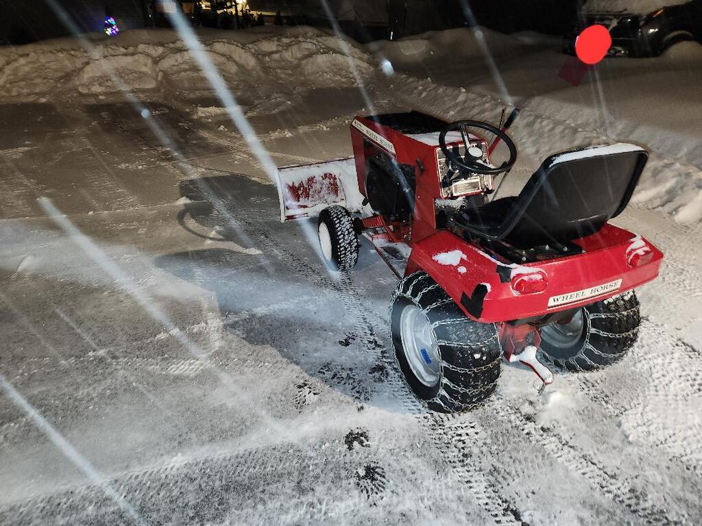

Brockport Bill
the key issue to me is the personal situation of the homeowners driveway - as well as the equipment -- i find the tractor with a blade can handle 8-10 inches comfortably - but over 10 then it makes sense to be sure to plow before it gets deeper - - especially if wet -- but clearly in your situation you have to have somewhere to put the snow -- not just for the one storm but for multiple storms over multiple weeks  -------
when i plow early in the season i always push the snow 5-6 feet off the drieway edge so i have a place to push and pile it for future storms -- but if necessary i use a walk behind blower along the edge of the driveway to throw it a distance clearing the 5-6 ft on the lawn for next storm............
- to me a modest storm of 3-4-5-6 inches is job for the blade ------ but it really depends on the driveway as much as any other factor - if as you say you dont have room and have to throw it a distance then thats a reality that cant be changed
