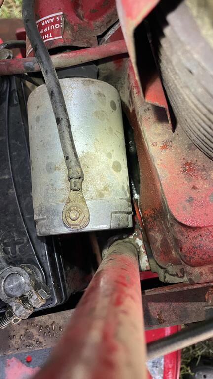

Fj40z 241 #30 Posted September 21 Well she’s gone. I suspected that the general consensus here was correct in that I was needing an overhaul. Had even talked with a guy about bringing it in for motor work next week. Tried to get home and mow again before a storm hit and she let go. Running fine as usual until it wasn’t. Loud rattle followed by the side of the block getting blown out. Really bummed about this. 8 Share this post Link to post Share on other sites

squonk 48,426 #37 Posted September 21 On 9/17/2026 at 3:27 PM, squonk said: 1000 hours. The balance gear bearings are probably getting loose. Most likely what grenaded. 1 2 Share this post Link to post Share on other sites
Fj40z 241 #38 Posted September 21 She grenaded alright. Storm finally passed so I was able to get back over and check. Big hole blown out right by the starter. Not only is the motor gutted but so am I. 3 Share this post Link to post Share on other sites
sqrlgtr 4,224 #39 Posted September 21 4 minutes ago, Fj40z said: She grenaded alright. Storm finally passed so I was able to get back over and check. Big hole blown out right by the starter. Not only is the motor gutted but so am I. sorry to see this. 1 Share this post Link to post Share on other sites
squonk 48,426 #40 Posted September 21 Yup that's where the gears fly out. When you get it apart it will look like it's smiling at you. 1 Share this post Link to post Share on other sites
ineedanother 2,885 #41 Posted September 22 1 hour ago, Fj40z said: She grenaded alright. Storm finally passed so I was able to get back over and check. Big hole blown out right by the starter. Not only is the motor gutted but so am I. Man, I hate seeing that. I'm still a little curious how it was going through so much oil without smoking. 1 Share this post Link to post Share on other sites
