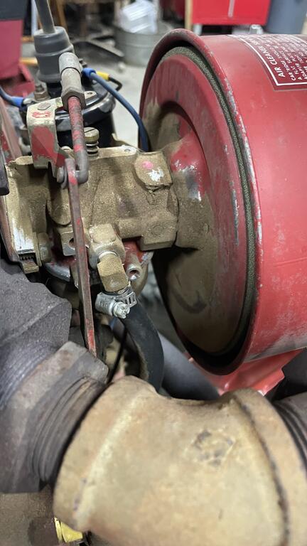

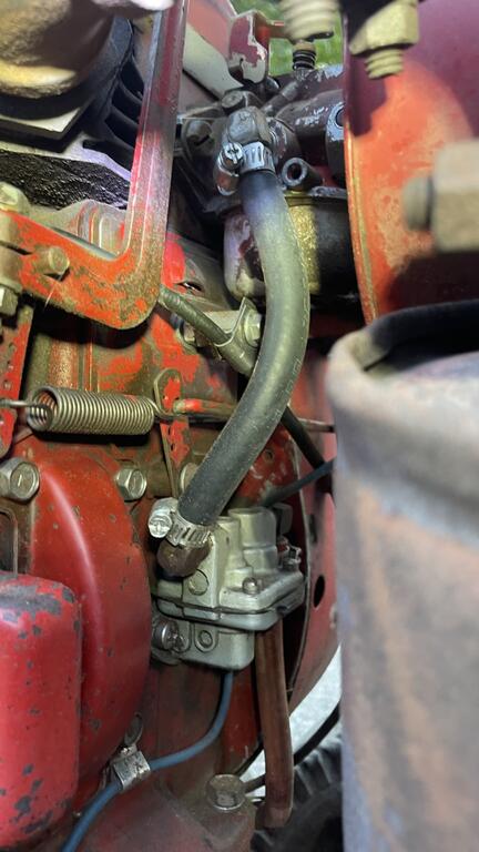

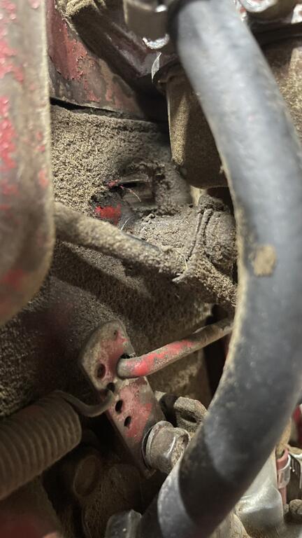

Fj40z 241 #1 Posted September 17 Hey all, my C160-8 is losing oil without smoking any at all. I mainly use it for mowing so it’s pretty much under some load at all times. Using Kohler 30w oil and I’ve smelt the dipstick and get no gas smell at all. I do see a lot of dusty oily residue at the front of the motor around the air filter and carb area and the front of the motor that wasn’t there before. It may have already been oily there and I just noticed it today since it was so dusty from being super dry here. Looks like a lot of build up around a small slit on the front of the motor. Seems to be running fine other than the oil consumption. Please excuse my ignorance LOL. Any help or insight it very appreciated as usual. Share this post Link to post Share on other sites
ineedanother 2,885 #2 Posted September 17 Define "loosing oil" if you would. A small amount on the dipstick between oil changes shouldn't be alarming IMO...and clean that thing You might want to pull the valve cover and make sure that it's clean so oil can return to the case rather than being blown out the vent. Replacing those gaskets might be in order. Looks pretty good to me for a working unless I'm missing something. A good rinse might show something more but I'm not seeing it. 2 2 Share this post Link to post Share on other sites
mrc 1,122 #3 Posted September 17 one of mine is a lot dirtier! Share this post Link to post Share on other sites

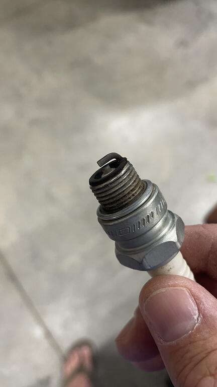

pfrederi 21,342 #9 Posted September 17 What does your spark plug look like??? Picture please 4 Share this post Link to post Share on other sites
Fj40z 241 #10 Posted September 17 Yeah using Kohler 30w oil. I’ll have to get a pic of the spark plug when I get home from work. I’ll also try and get it cleaned off good when I get home and see if I can isolate where it’s coming from mostly. I hope it’s nothing major, I’m very green on the ins and outs of small engines. I know it’s old and I can live with adding a little oil and small oil leaks, just hoping to avoid a catastrophic failure. Share this post Link to post Share on other sites
squonk 48,426 #11 Posted September 17 1000 hours. The balance gear bearings are probably getting loose. Share this post Link to post Share on other sites
Fj40z 241 #12 Posted September 17 7 hours ago, pfrederi said: What does your spark plug look like??? Picture please 2 Share this post Link to post Share on other sites
Fj40z 241 #13 Posted September 17 This one didn’t come with a hour meter. Has a factory block off plate where the hour meter would have went. I’d wager it has weeeeellllll over 1000 hours on it. I bought it from the original owner and they used it only for mowing for decades so there’s really no telling how many hours it has on it. Share this post Link to post Share on other sites
rjg854 13,454 #14 Posted September 17 32 minutes ago, Fj40z said: That doesn't appear to signs of burning oil 3 Share this post Link to post Share on other sites
Fj40z 241 #15 Posted September 17 @rjg854 I agree, looks pretty good to me. 1 Share this post Link to post Share on other sites
Fj40z 241 #16 Posted September 17 Cleaned it up some and let it run and get hot. Did not see any leaking but possibly only leaking under load? Share this post Link to post Share on other sites
sqrlgtr 4,224 #17 Posted September 18 My K161 7hp on my 701 leaks oil at the oil pan and block and if you park it in the gravel or dirt shed you dont even notice the oil slick thats under it, but you sure can in the concrete shop . May not be your problem but the spark plug you show doesn't appear to be that bad to me, if they are burning oil badly, they are usually wet with oil. Just throwing this out there because I thought mine was burning oil bad but turns out it was just marking its spot. 1 Share this post Link to post Share on other sites

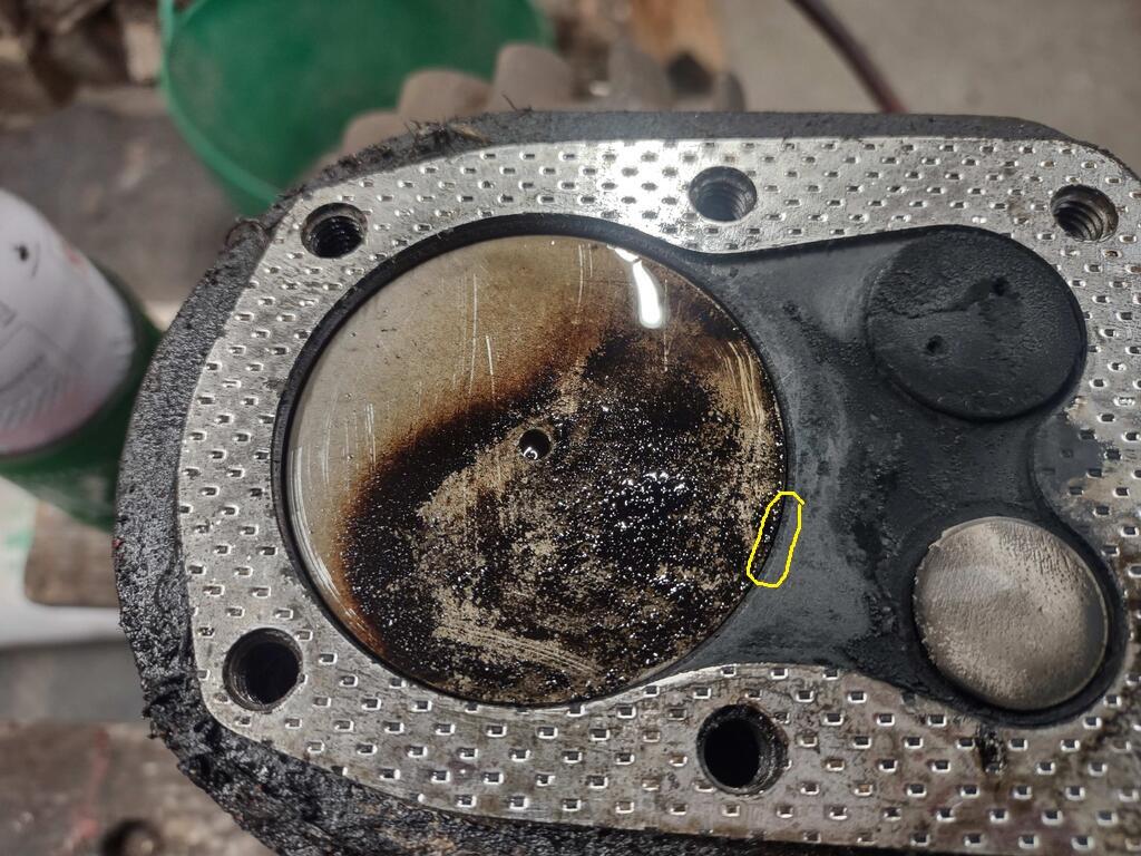

WHX?? 58,387 #21 Posted September 18 (edited) 9 hours ago, Fj40z said: I’m not familiar with the term oil wash? Where the top of the piston and combustion chamber has no carbon because of leaky rings. Dan skooled me this. @Achto got a pic??? I'm sure the Squonky @squonk has seen it. Edited September 18 by WHX?? 2 1 Share this post Link to post Share on other sites
Achto 32,962 #22 Posted September 18 This picture shows piston wash. The clean area is from oil getting past the rings and washing the carbon off the top of the piston. 2 2 1 Share this post Link to post Share on other sites
squonk 48,426 #23 Posted September 18 (edited) 10 hours ago, WHX?? said: I would say then is pop the head and check for oil wash. Never hurts anyway to check the bore, valves & decarbon. And whilst you're in there look at the piston edge closest to the exhaust valve. I bet it's eaten away. Edited September 18 by squonk 2 1 Share this post Link to post Share on other sites
pfrederi 21,342 #24 Posted September 18 I would think if all that oil was getting up past the rings the plug would have been fouled.... 3 Share this post Link to post Share on other sites
WHX?? 58,387 #25 Posted September 18 Just now, pfrederi said: I would think if all that oil was getting up past the rings the plug would have been fouled.... I would also think it would smoke?? 3 Share this post Link to post Share on other sites
