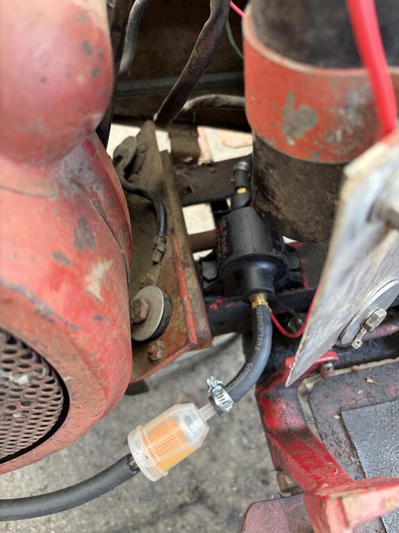

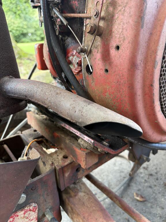

Just picked up this 79 C141 for cheap not running. Found out the lobe on cam for fuel pump was rounded so I put an electric pump on it. Runs good, shakes like crazy. What are you guys doing for replacement bushings on this shaker plate? This is my first one with this setup, all my others were mounted directly to frame.

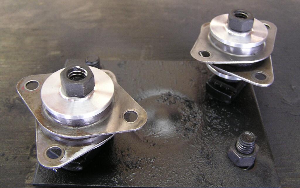

You have 2 choices for ridgid mounting. One is to purchase the Ebay available CNC machined ones ( I have a used set on a C81 - works great). Or measure the gap from the underside of the plate to the top of the frame & fill it with solid spacers of your making....

Wheel Horse Parts and more sells nice machined solid ones

Krice58
56 minutes ago, rmaynard said:
Not saying it was or wasn't, but I've never seen a cam lobe worn down by a fuel pump arm. However, an electric pump is a good replacement.
There was a small piece of the cam friction welded to the fuel pump. I’d never seen it before either.

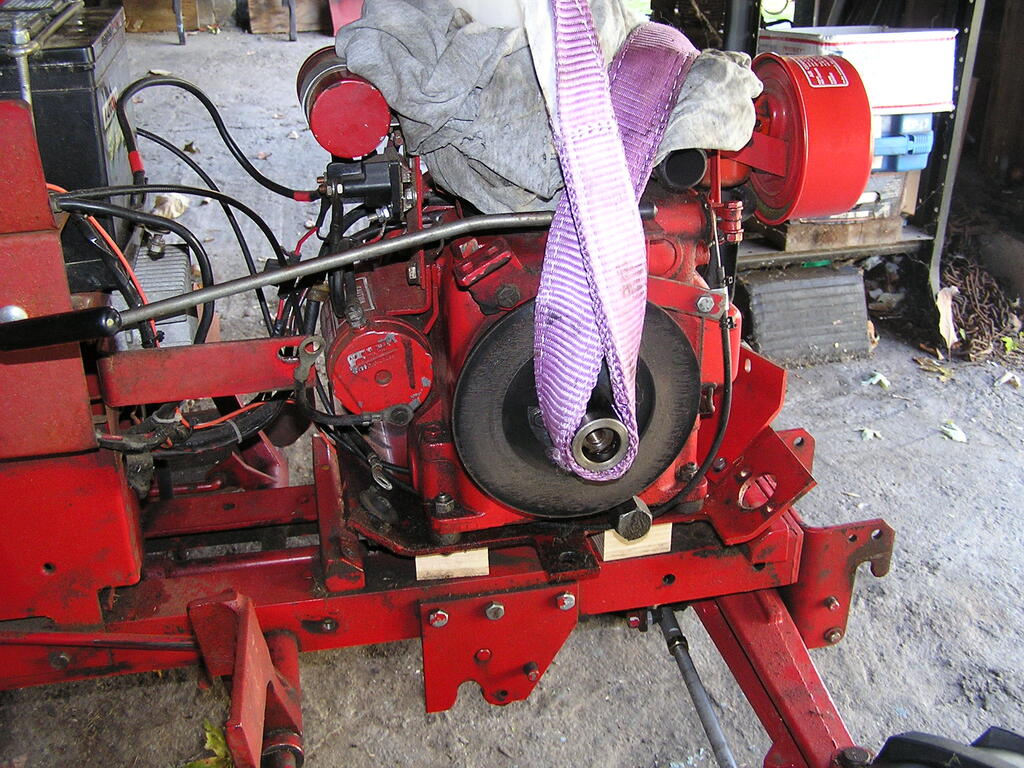

How do you install the bushings? I’d assume you’d have to lift the engine somehow?

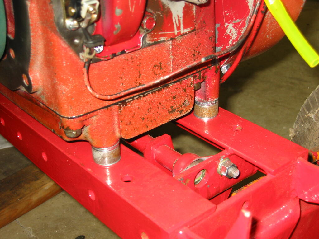

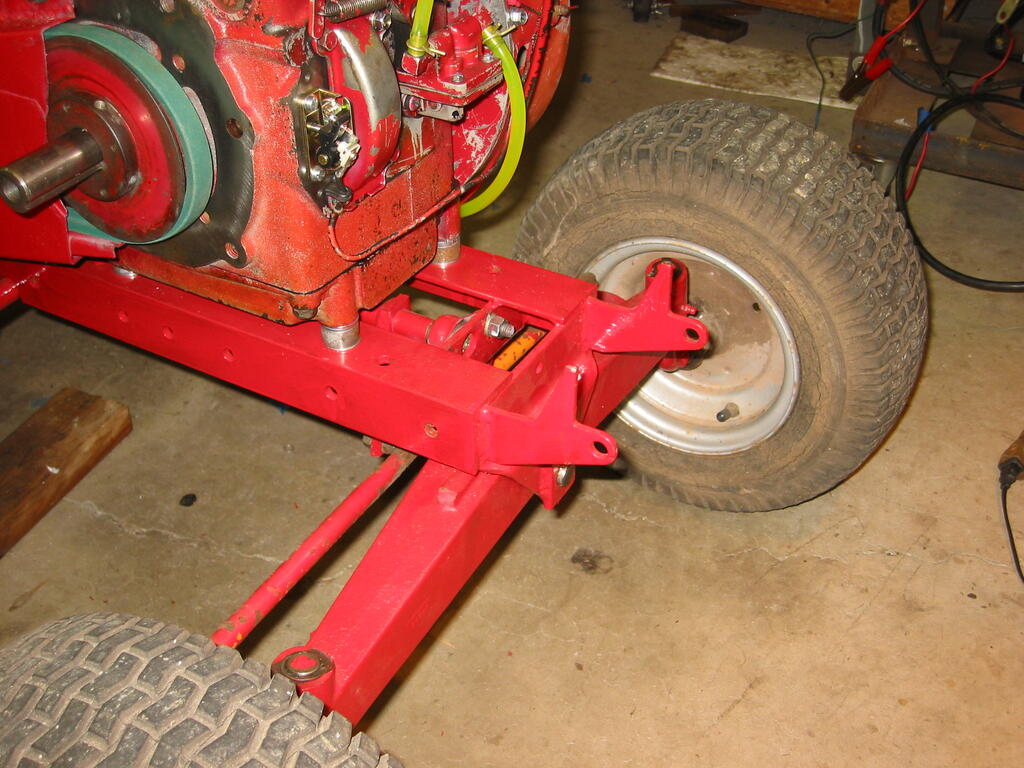

Sorry no pics Eric, but I have eliminated this engine mounting design that depends on four rubber sponges and the drive and PTO belt tension to position the engine.
Some I replaced the rubbers with solid spacers and some I cut the angled wings off the cradle plate, removed the tapered bars and bolted the plate directly to the frame with the correct spacers to put the engine at the correct height.   All worked well and IMO had the same or less vibration than the rubber mounts.
Here is a link to my Low Rider build where I altered the cradle plate to a solid mount.  Page #2 shows the mods.

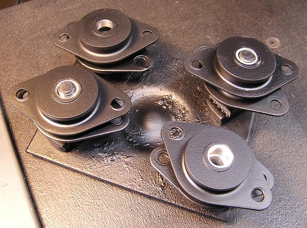

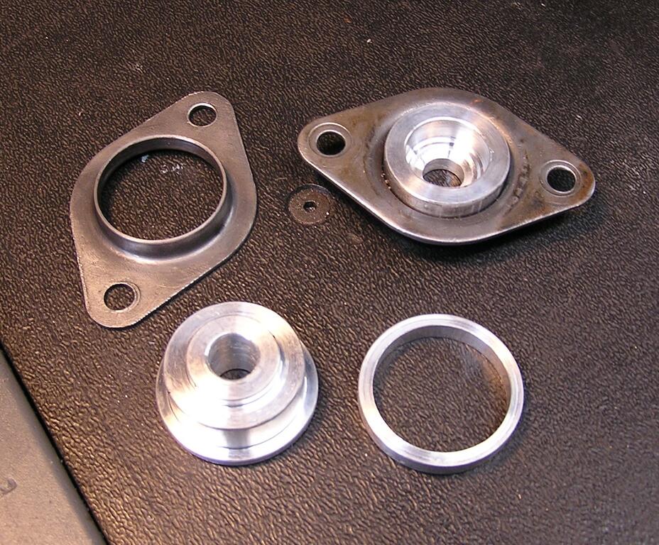

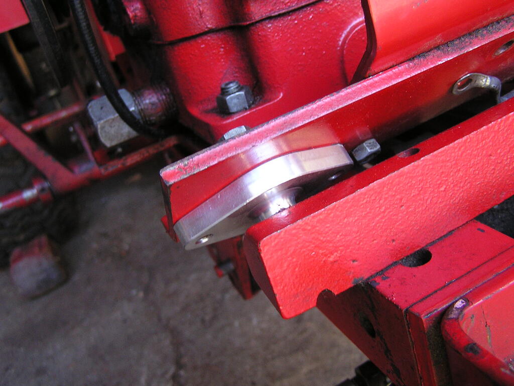

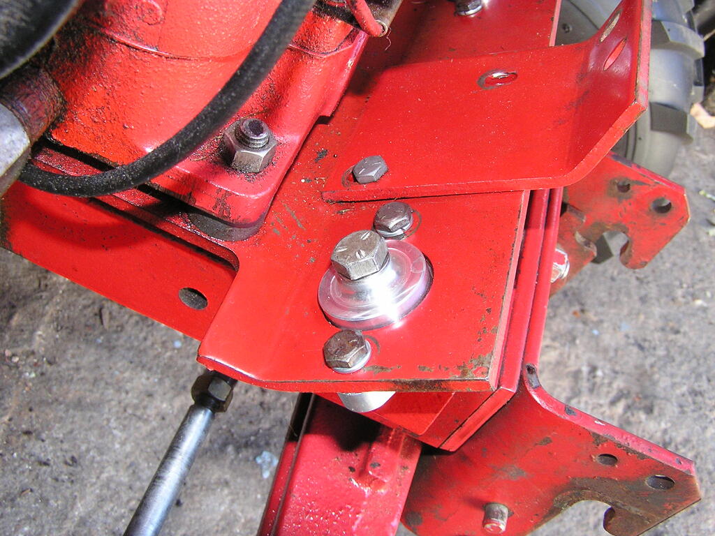

That might be me..... I used the steel plate mounts from two sets and turned up solid interlocking aluminum halves & centering rings. Then I powdercoated them all...
Those are now installed on the other C81 i purchased from @Sparky. They look almost identical to the OE ones...

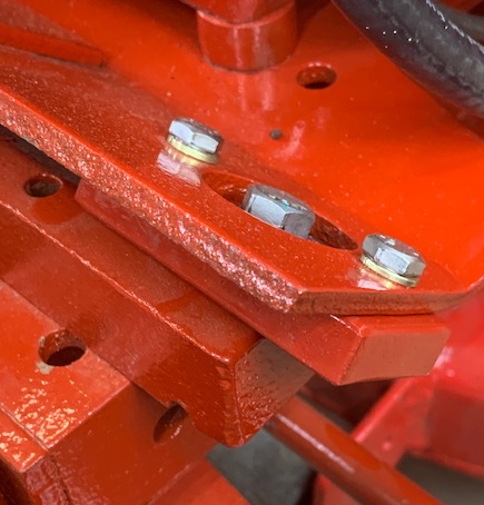

I just went the rigid mount bushings from performance machine and design...and they do work...but the installation is definitely not easy...if I were to do this again I would do what @pfrederi did above.

I did have to raise the engine to install them - but worth it.
