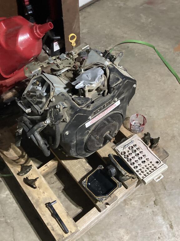

MainelyWheelhorse 3,133 #1 Posted August 15 (edited) So I’d like to put this, in this… As far as I know the only thing it needs electronically to run the engine separately, is a key switch that at least by part number is the same as the Magnum’s. What else do I need electronically to be able to run it in my C-85? I assume I’d need a small rectifier like the Magnum’s as well, possibly a solenoid. At least this time I have a good idea what it needs but I’m completely new to the Commands. Thanks! Edited August 15 by MainelyWheelhorse Share this post Link to post Share on other sites
953 nut 69,297 #2 Posted August 15 Here ya go, all of your other wiring including safety switches will work just fine. 2 1 1 Share this post Link to post Share on other sites
953 nut 69,297 #3 Posted August 15 46 minutes ago, MainelyWheelhorse said: need electronically to be able to run it in my C-85? I assume I’d need a small rectifier like the Magnum’s as well, possibly a solenoid. At least this time I have a good idea what it needs but I’m completely new to the Commands The solenoid is mounted on your starter and the voltage regulator / rectifier is the same as any magnum, it is probably already mounted near the flywheel fan. 1 1 Share this post Link to post Share on other sites

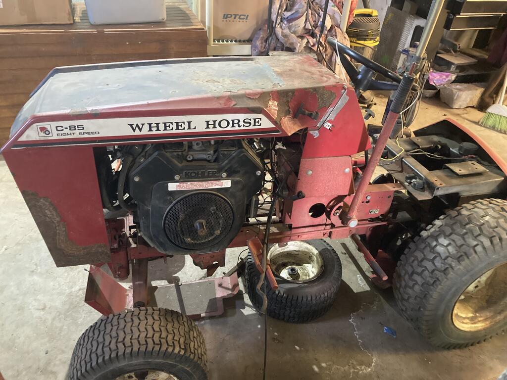

JCM 11,415 #4 Posted August 15 That C-85 looks very familiar Justin. Engine looks nice in there. Good luck 3 Share this post Link to post Share on other sites
MainelyWheelhorse 3,133 #5 Posted August 15 24 minutes ago, JCM said: That C-85 looks very familiar Justin. Engine looks nice in there. Good luck @JCM Thanks, I figured you might recognize it 😁. 1 1 Share this post Link to post Share on other sites
MainelyWheelhorse 3,133 #6 Posted August 15 35 minutes ago, 953 nut said: The solenoid is mounted on your starter and the voltage regulator / rectifier is the same as any magnum, it is probably already mounted near the flywheel fan. Ok, I’ll give it a look. Once I saw the parts start coming back as also magnum parts I thought this might not be a C-141 level repower. 1 Share this post Link to post Share on other sites
ri702bill 13,057 #7 Posted August 16 (edited) Another item you may wish to look at - your front wheel bearings & spindles. You just added a fair amount more weight to the steering... Pay attention to the underside of the spindles where the inner races reside. It is not uncommon to find the shafts well worn due to the inner race(s) spinning - they should remain stationary. Repair / replace as necessary. If you find the steering to be too heavy handed after the swap, consider cutting the bottom ends of the axle bosses to make room for a set of 3 pc roller thrust bearings & washers, as I did for @Handy Don on his 312. Makes for one finger steering.... Edited August 16 by ri702bill 1 1 Share this post Link to post Share on other sites

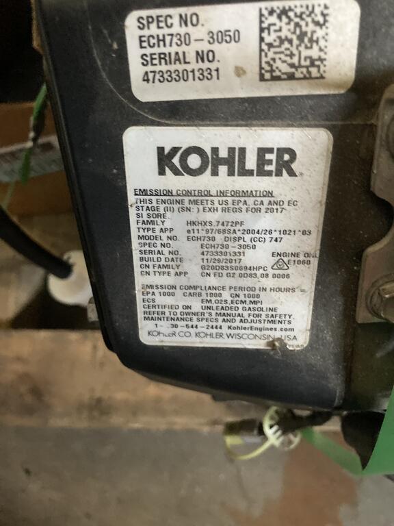

Wild Bill 633 941 #8 Posted August 16 ECH is an EFI engine meaning it needs an ECU and an exhaust oxygen sensor. 1 Share this post Link to post Share on other sites
JoeM 10,267 #9 Posted August 16 If your using it to mow it will need an electric clutch, there is no bearings in the output shaft just sleeves that run on oil pressure similar to an car. I will say that engine would be a rockstar in a c if done right. 4 Share this post Link to post Share on other sites
ebinmaine 80,695 #10 Posted August 16 2 hours ago, ri702bill said: Another item you may wish to look at - your front wheel bearings & spindles. You just added a fair amount more weight to the steering... Pay attention to the underside of the spindles where the inner races reside. It is not uncommon to find the shafts well worn due to the inner race(s) spinning - they should remain stationary. Repair / replace as necessary. If you find the steering to be too heavy handed after the swap, consider cutting the bottom ends of the axle bosses to make room for a set of 3 pc roller thrust bearings & washers, as I did for @Handy Don on his 312. Makes for one finger steering.... That's an aluminum engine. It weighs less than a Kohler K series big block. 2 Share this post Link to post Share on other sites
peter lena 10,065 #11 Posted August 16 @JoeM good spot for a SOFT START UNIT ? that would make that seamless , pete 2 Share this post Link to post Share on other sites
MainelyWheelhorse 3,133 #12 Posted August 16 3 hours ago, Wild Bill 633 said: ECH is an EFI engine meaning it needs an ECU and an exhaust oxygen sensor. Ok, As far as I know it has all that. 1 Share this post Link to post Share on other sites
MainelyWheelhorse 3,133 #13 Posted August 16 3 hours ago, ri702bill said: Another item you may wish to look at - your front wheel bearings & spindles. You just added a fair amount more weight to the steering... Pay attention to the underside of the spindles where the inner races reside. It is not uncommon to find the shafts well worn due to the inner race(s) spinning - they should remain stationary. Repair / replace as necessary. If you find the steering to be too heavy handed after the swap, consider cutting the bottom ends of the axle bosses to make room for a set of 3 pc roller thrust bearings & washers, as I did for @Handy Don on his 312. Makes for one finger steering.... As @ebinmaine was saying the engine is aluminum and around 10 lbs lighter. I’m not too worried about the steering, as even with the k in the c-141 the steering isn’t overly heavy. 1 Share this post Link to post Share on other sites
