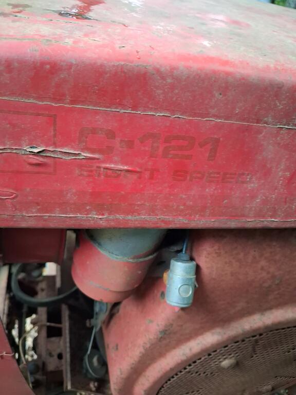

John c 222 #1 Posted August 5 Has anybody come up with anything that will remove spray paint I mean beside an actual paint stripper. I've found another barn find on the marketplace and the hood decals have been sprayed over, I'd like to get it off if possible and save the original decal. 1 Share this post Link to post Share on other sites
ebinmaine 80,461 #2 Posted August 5 We've used an orange citrus based remover that worked okay. Use caution though. A lot of the paint strippers are also quite fond of removing the decal color or basic glues. 2 Share this post Link to post Share on other sites

ebinmaine 80,461 #10 Posted August 5 39 minutes ago, WHX?? said: Yes try it on a small spot first to make sure 10 minutes ago, 953 nut said: Eric, that was my first thought, if any remover solution gets to the glue it is game over for the decal. My biggest concern at first glance is/ are the cuts in the existing decals. The edges are bad enough... the cuts are curled UP so they'll be prone to inviting whatever solution is used. 2 Share this post Link to post Share on other sites

John c 222 #16 Posted August 5 I'd want to save the decals, not planning to do a complete strip/blast/repaint, the finish is already shot so new decals would look out of place. 1 Share this post Link to post Share on other sites
