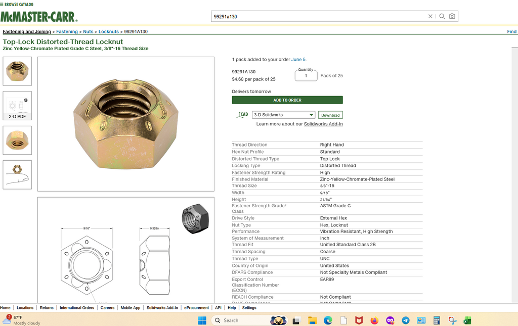

pfrederi 21,290 #2 Posted July 29 I haven't ever broken one. What Kind of lock nuts did you use?? If it loosens up the slop will lead to breakage. I am now using these 3 3 Share this post Link to post Share on other sites

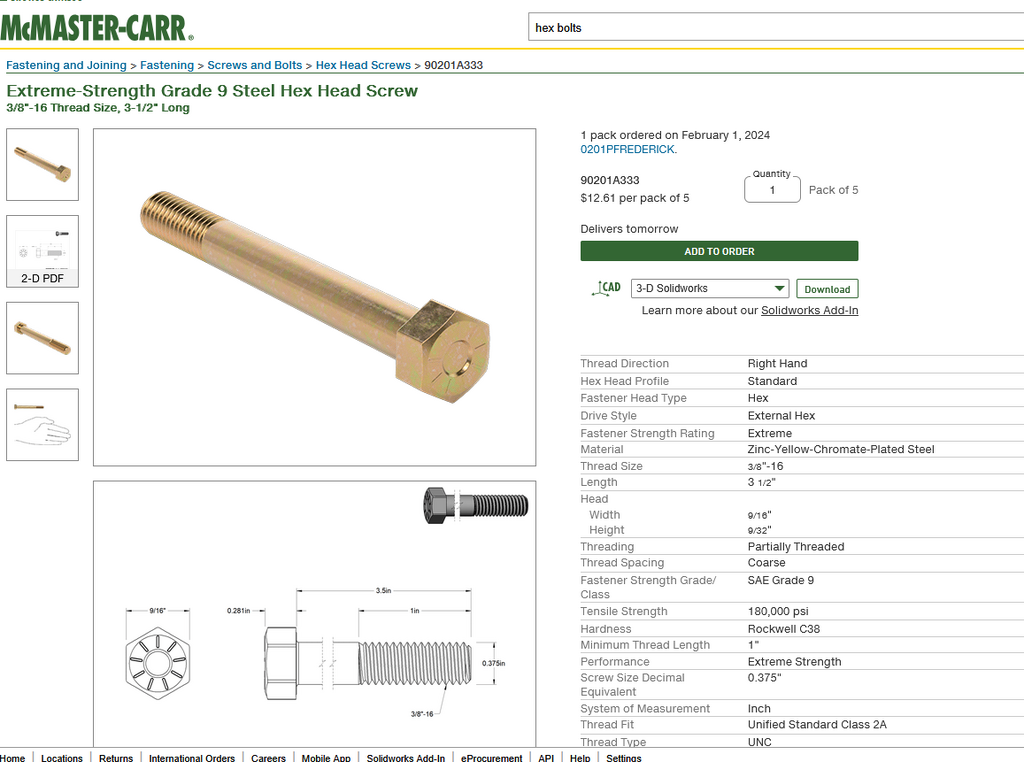

Bill D 3,191 #11 Posted July 30 I think @Skipper used Grade 9 bolts to rebuild the differential on his C195. Share this post Link to post Share on other sites

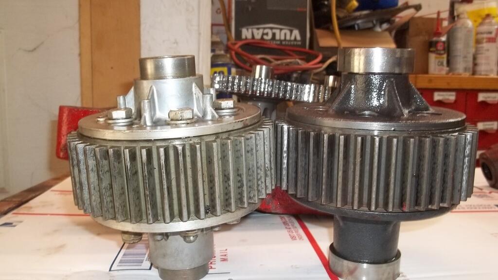

953 nut 70,262 #14 Posted July 31 9 hours ago, kb65 said: i am looking for a more robust newer diff. does any one know when the 10 pinion unit arrived and what tractors it could be found in? I think they would be the same for a manual or hydro. If you want to use a newer differential you will also need to obtain new axles, yours are retained by roll pins and the ones for the ten pinion are retained by HEAVY DUTY snap rings. Do not attempt to use regular snap rings and mount them with the sharp edge toward the inner end of the axle. The eight pinion is a stronger unit than the ten pinion in my opinion but they will all interchange. If memory serves me right the GT-14, Raider, Charger, and Electro, as well as the 10/1267 have the ten pinion limited slip differentials. The end plates on the 1967 to 1972 were aluminum and in 1972 they went to cast iron end plates. New springs for the limited slip can be bought from Lowell, Wheel Horse Parts and more. Also the 1533 bearings were in short supply during part of the 1970 run so some of then will have a B-348 Torrington roller bearing and a race that is pressed onto the ends of the housing. The one on the right has the race on it. E Share this post Link to post Share on other sites
kb65 14 #15 Posted July 31 are the axle lengths the same on all of the diffs. I have a pair of axles that use the snap rings but they are both the same length and i believe 1 is supposed to be longer than the other. I am hoping to find a 10 pinion in the 8 speed I have. If i do i will just need a left gear case for the hydro gear. thank you ken Share this post Link to post Share on other sites

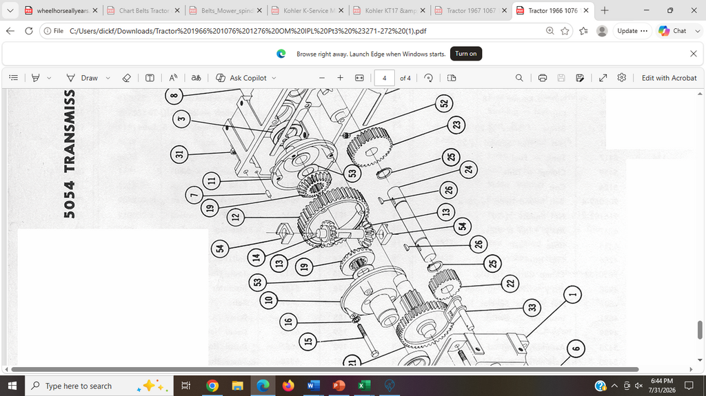

953 nut 70,262 #20 Posted July 31 1 hour ago, stevasaurus said: Your horse should have a #5060 10 pinion Limited Slip differential an 8 speed transmission. What do you really have there?? Maybe a phone call is in order? Steve, he has a 1076 with a Sundstrand Hydro. that he plans to replace the differential in. below is a screenshot of the IPL. 1 Share this post Link to post Share on other sites

stevasaurus 23,883 #22 Posted August 1 Sorry for my confusion here. If Richard's #5054 diagram is what you have, I would call your differential a "Bevel Gear Differential". I have no idea if an 8 pinion differential will be replacable in your trans. I would open your trans up, take pictures and measurements and compair with other IPL's. The hydro trans case, I think, is the issue for yes or no to do what you want. Checking part numbers in manuals is where to start. Share this post Link to post Share on other sites
