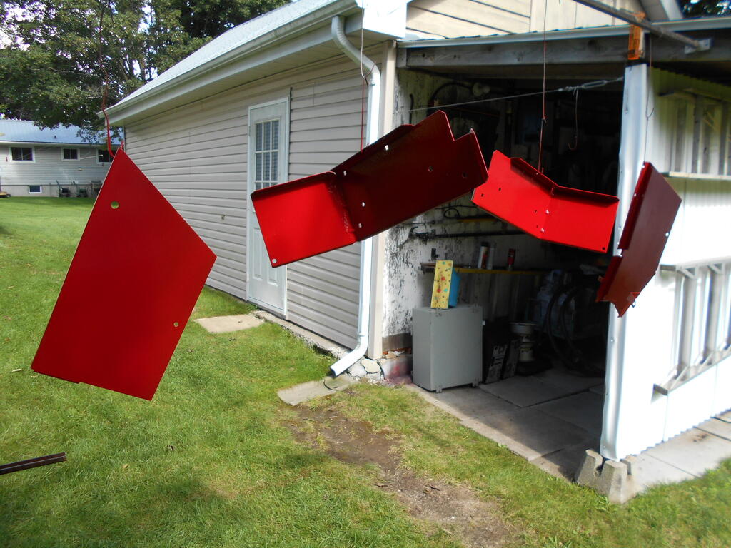

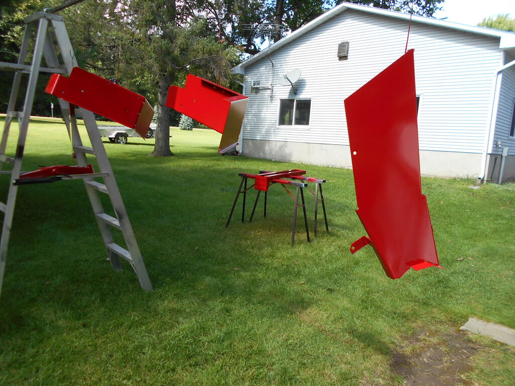

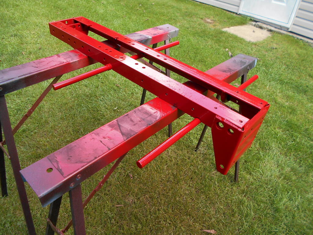

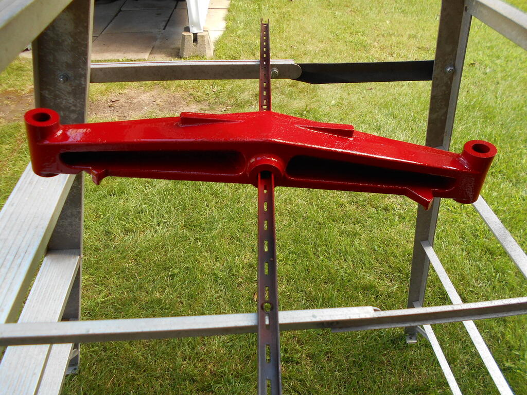

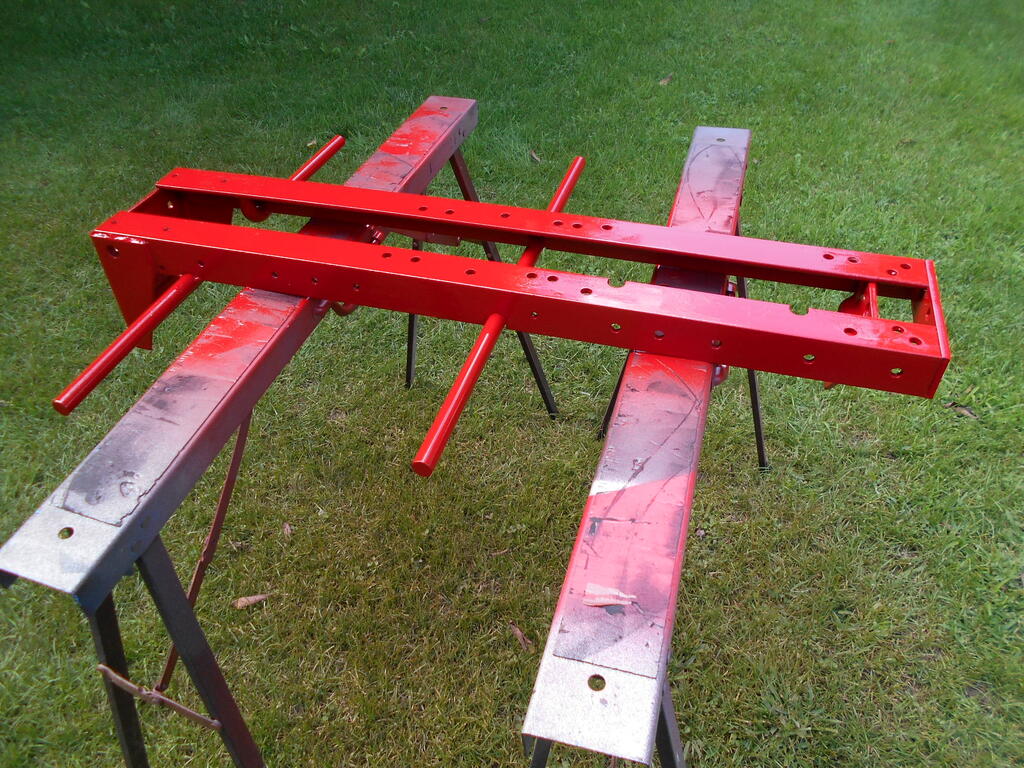

Well, I had a few parts hanging around cleaned up and primed so I thought I would brave the mosquitos and paint them using my paint spray gun.
I have a little less blood but at least some parts got red.
  • Like 4

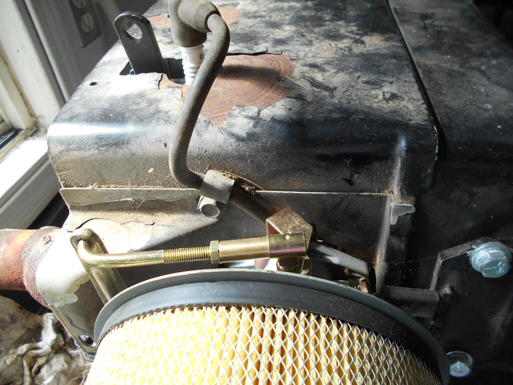

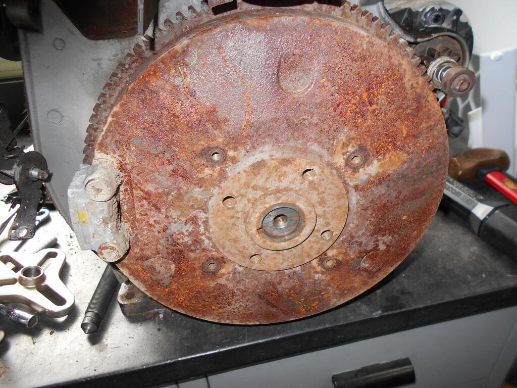

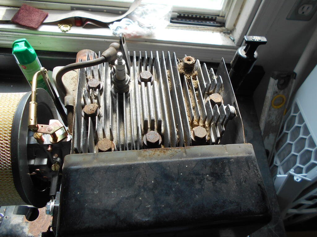

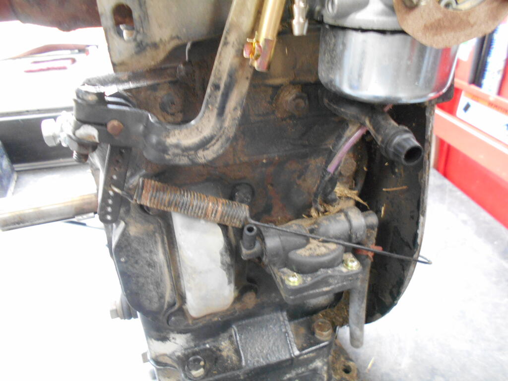

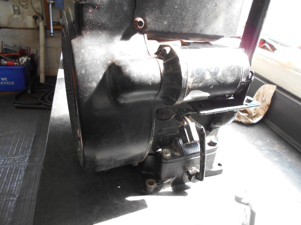

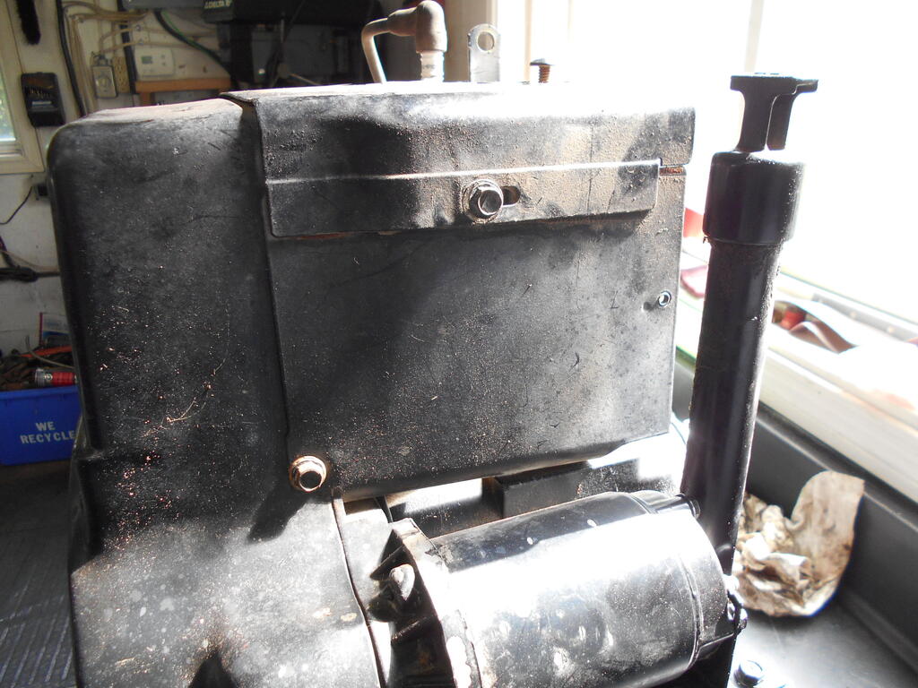

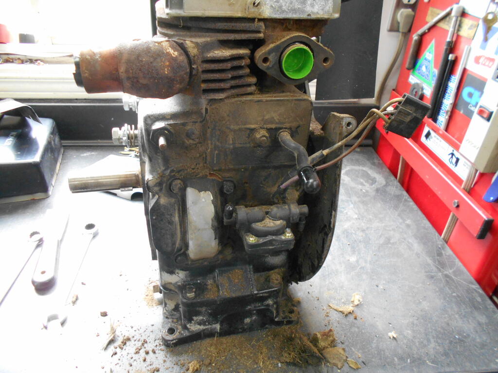

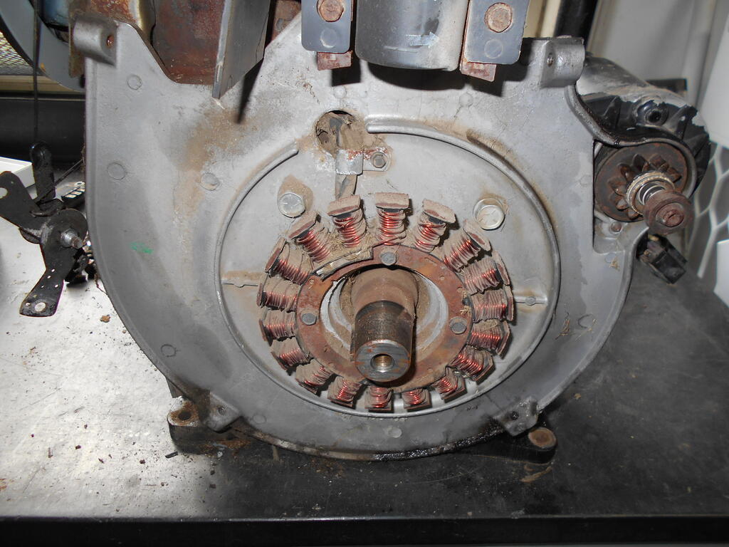

Another rainy day do I started dismantling the engine for cleanup.
I do not believe it needs a full tear down as it ran quiet and smooth.

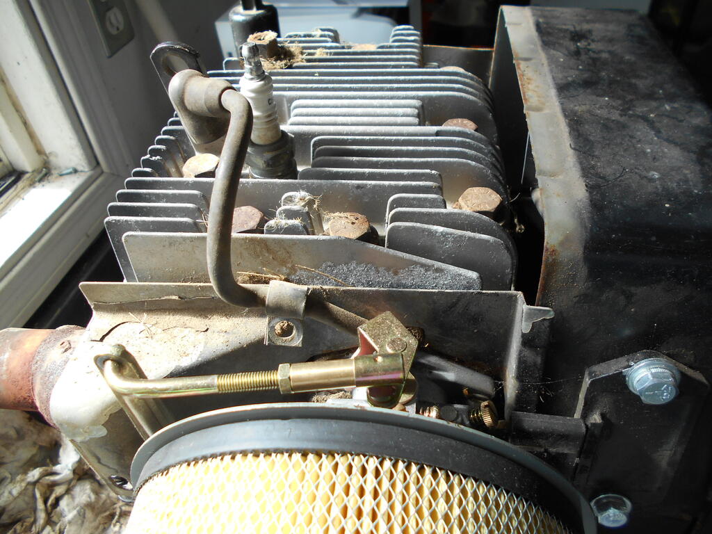

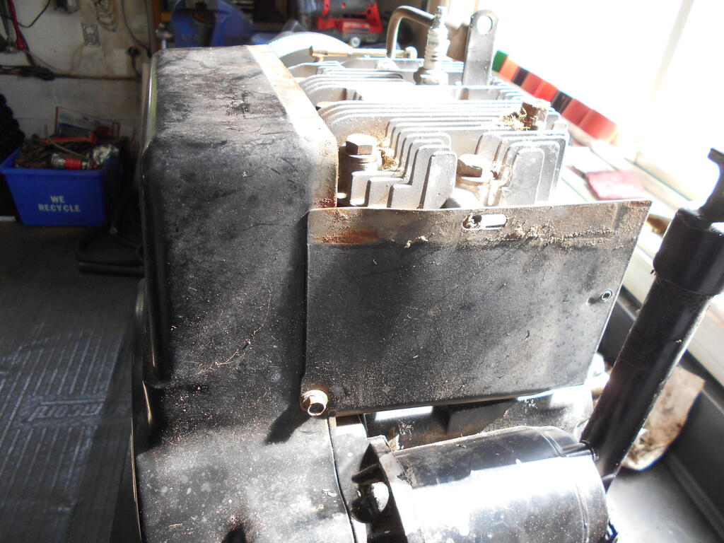

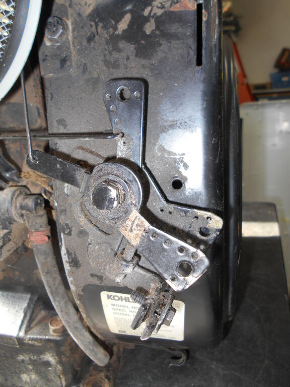

I took some picture of the tin work so I can put it back together properly.
Choke and throttle linkage as found.

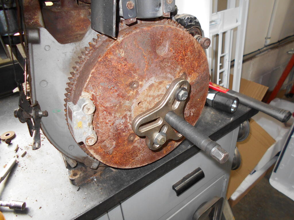

Flywheel ready to be pulled
Flywheel puller installed after chasing the threads for the puller bolts.

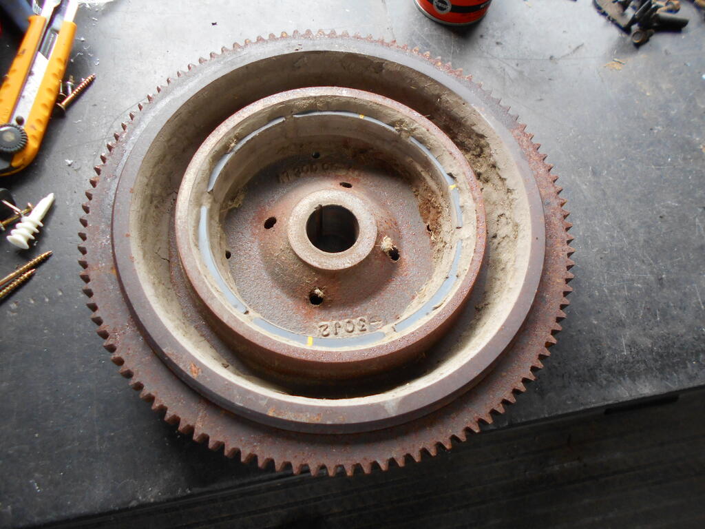

Flywheel pulled and very dirty inside.
Alternator coil is remarkably clean as compared to the flywheel for some reason.
  • Like 4

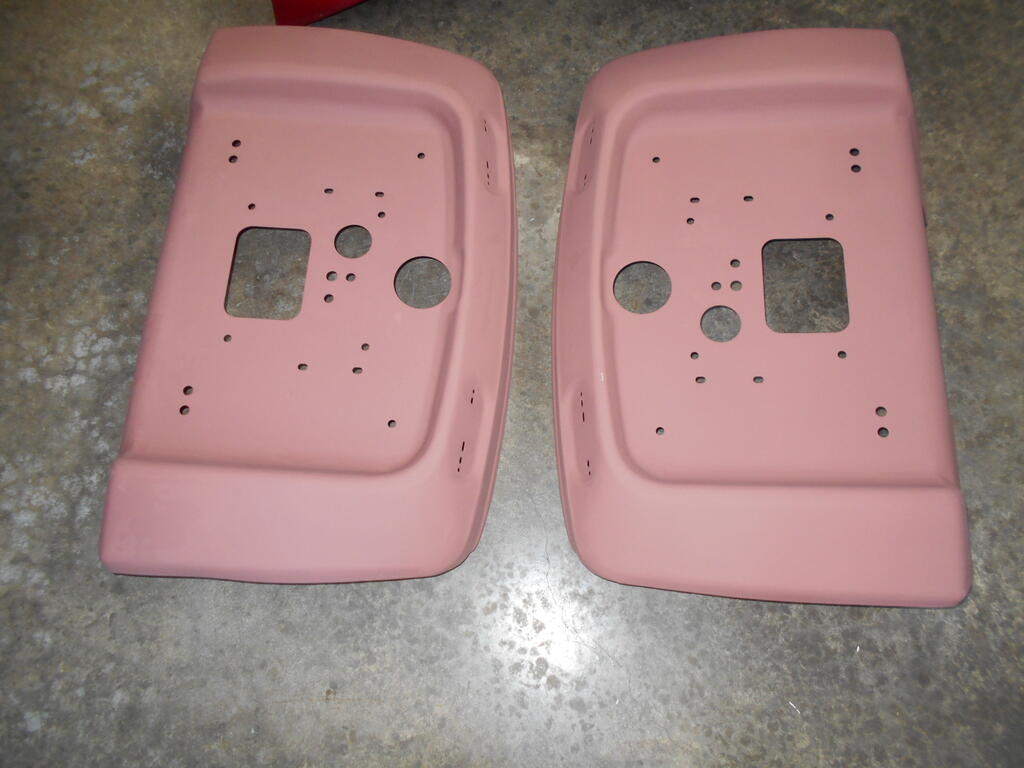

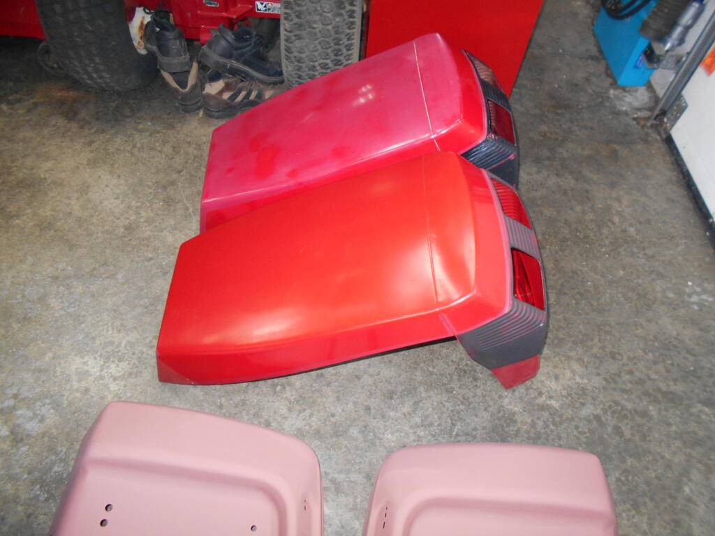

I have two fenders primed although one of them needs more sanding and a re-prime.
Two hoods are stripped and ready for sand and prime.

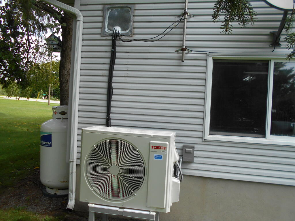

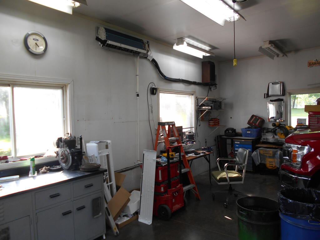

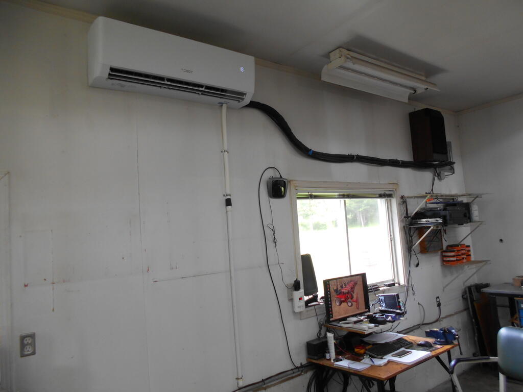

I am getting a heat pump installed in the shop so it is a mess right now.
  • Like 7
ebinmaine
For heat and AC?

cleat
Posted (edited)
3 hours ago, ebinmaine said:
For heat and AC?
Yes, i never had AC in the shop so I am looking forward to that.
I had a propane furnace but I am getting tired of paying for the tank rental and just buying propane in general.
I am hoping the heat pump can keep up in the winter but if not I have a 5000 watt heater for backup.
The house is getting a new heat pump with an electric air handler for air circulation and backup as well.
The house central AC unit has been on the way out for a few years now and this summer the furnace blower went out and it is $1200 just for the part so I am just getting rid of the whole setup.
I hope that I am not making a big mistake putting these in.
I will let you know next year how they work..
These are both high seer inverter units that are supposed to be very efficient and work in the cold.

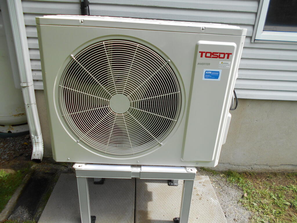

cleat

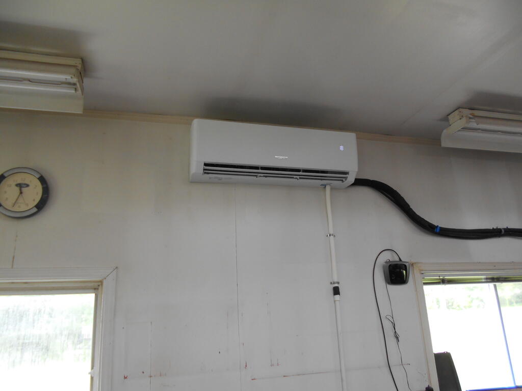

Heat pump installed just needs covers on charge lines installed.
8946827_Heatpumpinstalledjustneedscoversonchargelinesinstalled1.JPG.8e20cef38985ef6ca79ef0ee82b12945.JPG
102991797_Heatpumpinstalledjustneedscoversonchargelinesinstalled2.JPG.8a127544ab2f38cde76a9455e0d2f0fd.JPG
357957438_Heatpumpinstalledjustneedscoversonchargelinesinstalled3.JPG.4e08c991d8b428351e2e99a73f5fbf1a.JPG
1127100283_Heatpumpinstalledjustneedscoversonchargelinesinstalled4.JPG.87ac50c15054cc20439d4da87ee6203a.JPG
Here is the spec sheet.
SB_TW24HXP2A1DITW24HXP2A1DO_20260211.pdf
  • Like 5
  • Excellent 1
Handy Don
I’m surprised that they installed the external part parallel to the wall and not perpendicular or farther out, especially with the snowfall levels in your area an possible roof shedding. You’ll have to keep an eye on the space between the unit and the wall since the unit dumps heat in the summer, but dumps cooler air in winter.
  • Like 2
cleat
Fortunately that unit is on an end wall so no snow issues that way.
I will keep an eye on it but it should be fine.
  • Like 2

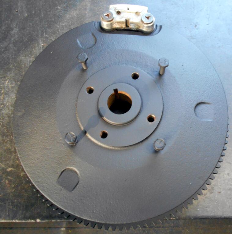

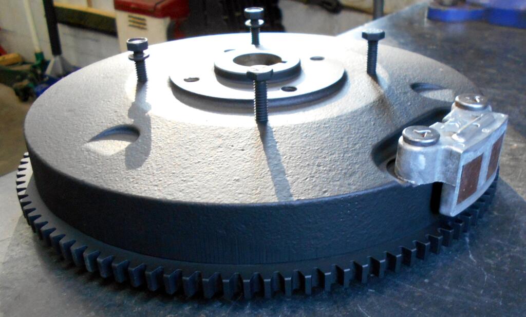

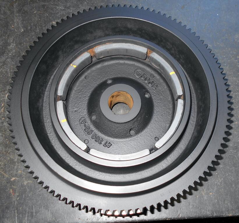

Flywheel has been cleaned up and painted.
I screwed bolts into all 8 threaded holes to keep paint out.
  • Like 3

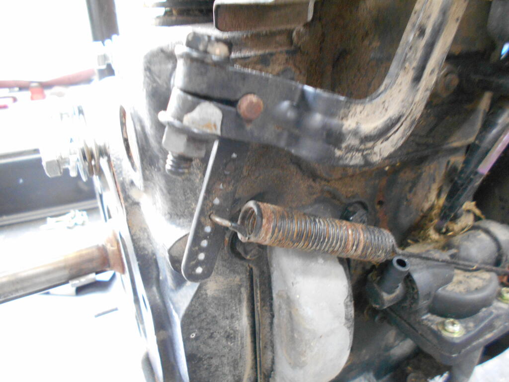

cleat

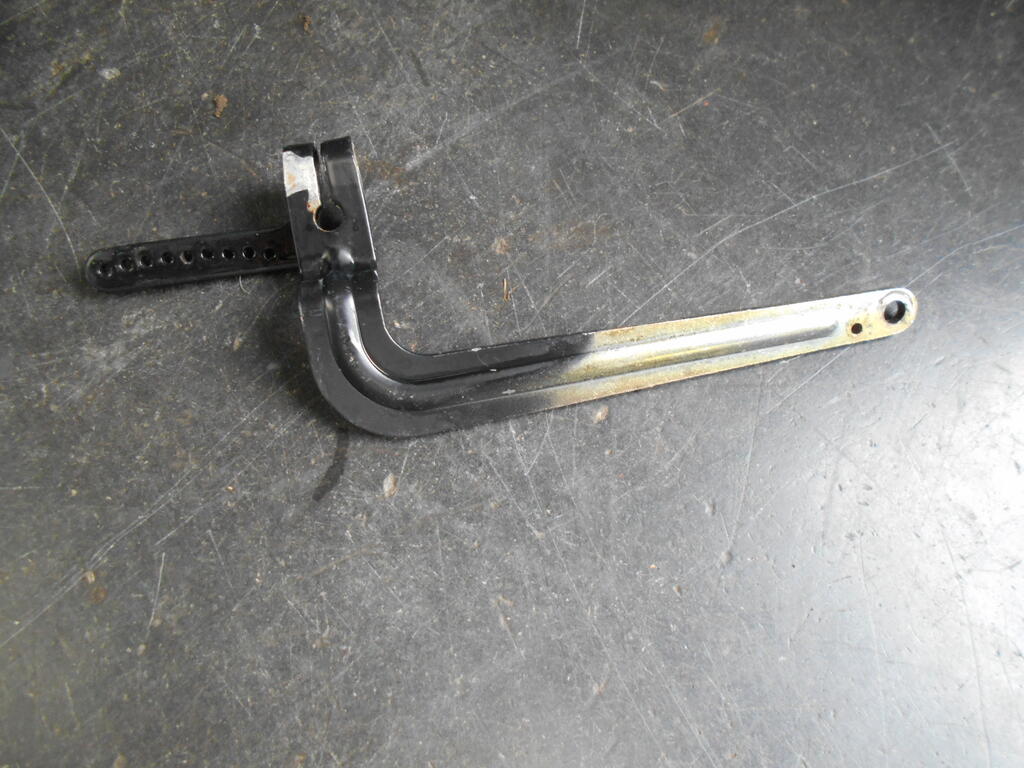

Governor lever and spring as found.
Governor lever and spring removed.
  • Like 1
  • Excellent 1

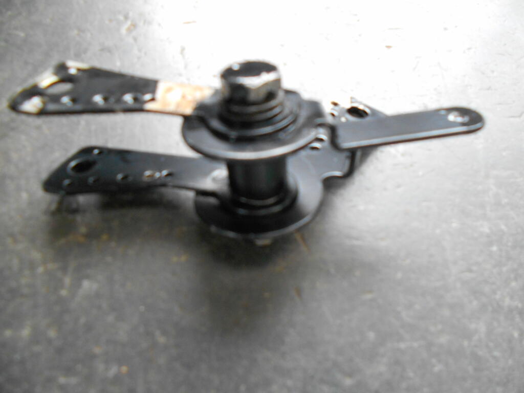

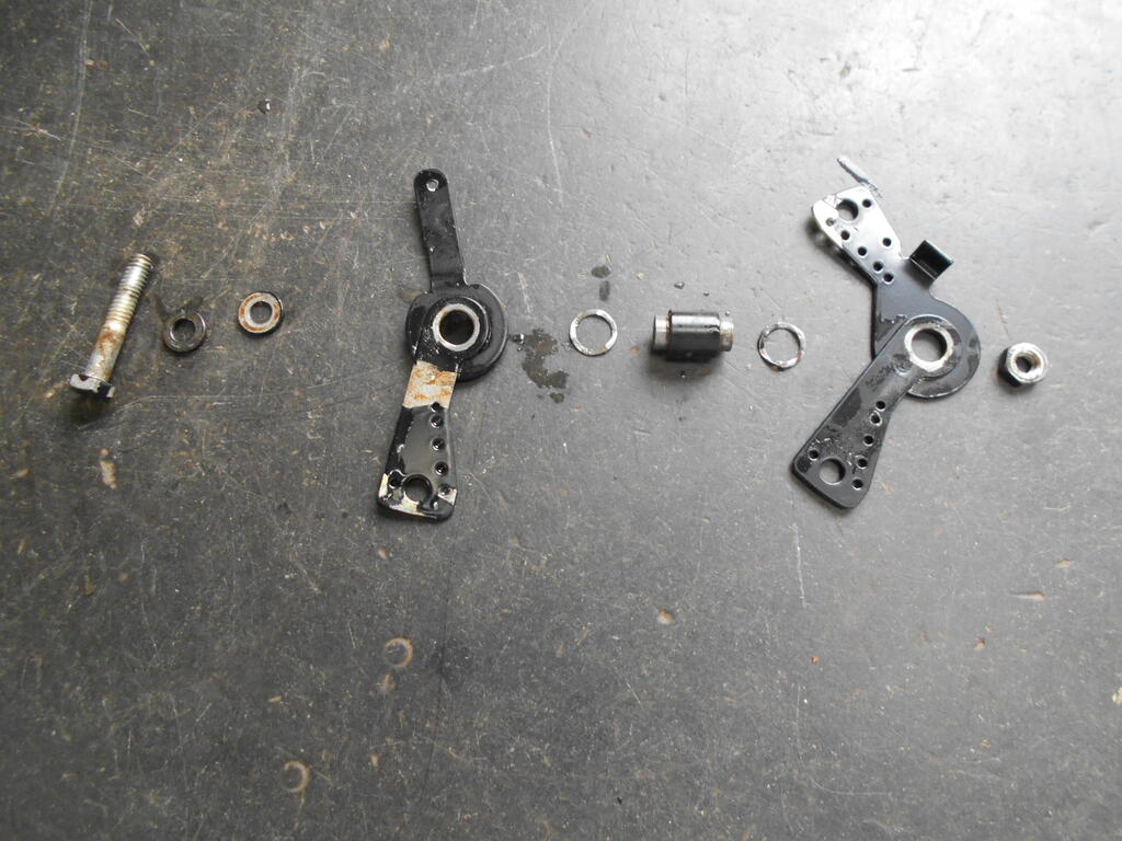

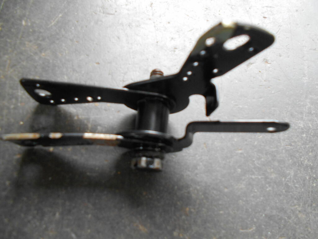

cleat
Governor lever as removed then de-greased.
Choke and throttle lever assemblies as removed then de-greased.
122342311_Chokeandthrottleleverassembliesasremoved1.JPG.5697857d380e91b2c2206c9000aa4cde.JPG
675931456_Chokeandthrottleleverassembliesasremoved2.JPG.2ae1b648c231141ead0e9cc76eb26217.JPG

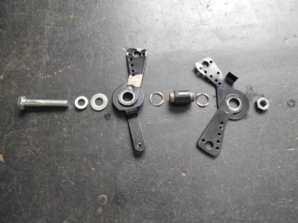

Choke and throttle lever assembly torn down.
1401632807_Chokeandthrottleleverassemblytorndown.JPG.808c50847480e0cced9f5c1c51c36727.JPG
Choke and throttle lever assembly torn down showing new bolt and washers.
898476931_Chokeandthrottleleverassemblytorndownshowingnewboltandwashers.JPG.f6bad5563bcf67364ce147425e1426e2.JPG
  • Like 4
  • Excellent 1

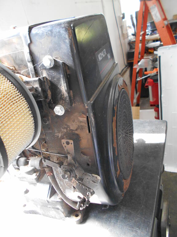

cleat
2 hours ago, sqrlgtr said:
I couldn't believe how much better the governor on the 856 was after I took it off and cleaned everything up good. It was binding up on the bushing and rod that goes in the block. @cleat looks like you got a good start on this project. Love following along on these builds.
Thank you, the governor on this engine was working fine but it definitely needs a cleanup.
I Will make sure nothing is binding as it goes back together.

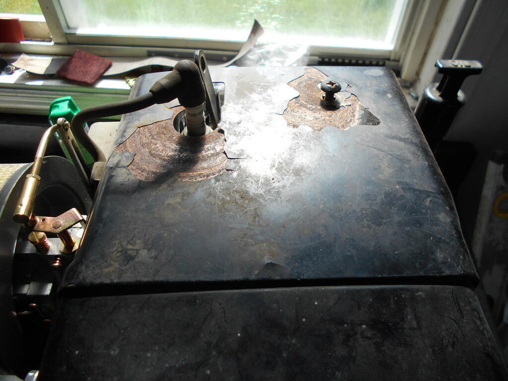

The paint on this engine is weird, thick and flaking off in spots and thin to missing in other spots.
  • Like 1
ebinmaine
I've seen other black painted Magnums do that. Possibly they were painted during the low VOC changeover.
  • Like 1
sqrlgtr
Posted (edited)
I have noticed that on the Magnum series a lot.
@ebinmaine most have been typing the same time I was :D
Edited by sqrlgtr
  • Like 1
