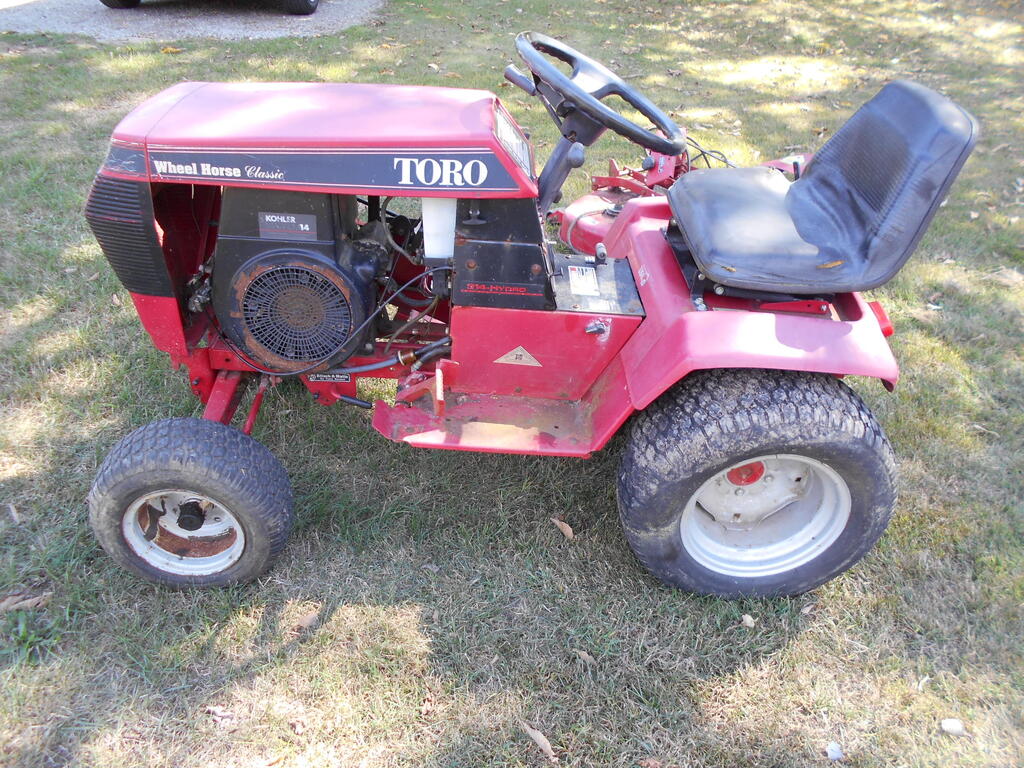

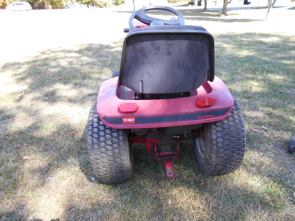

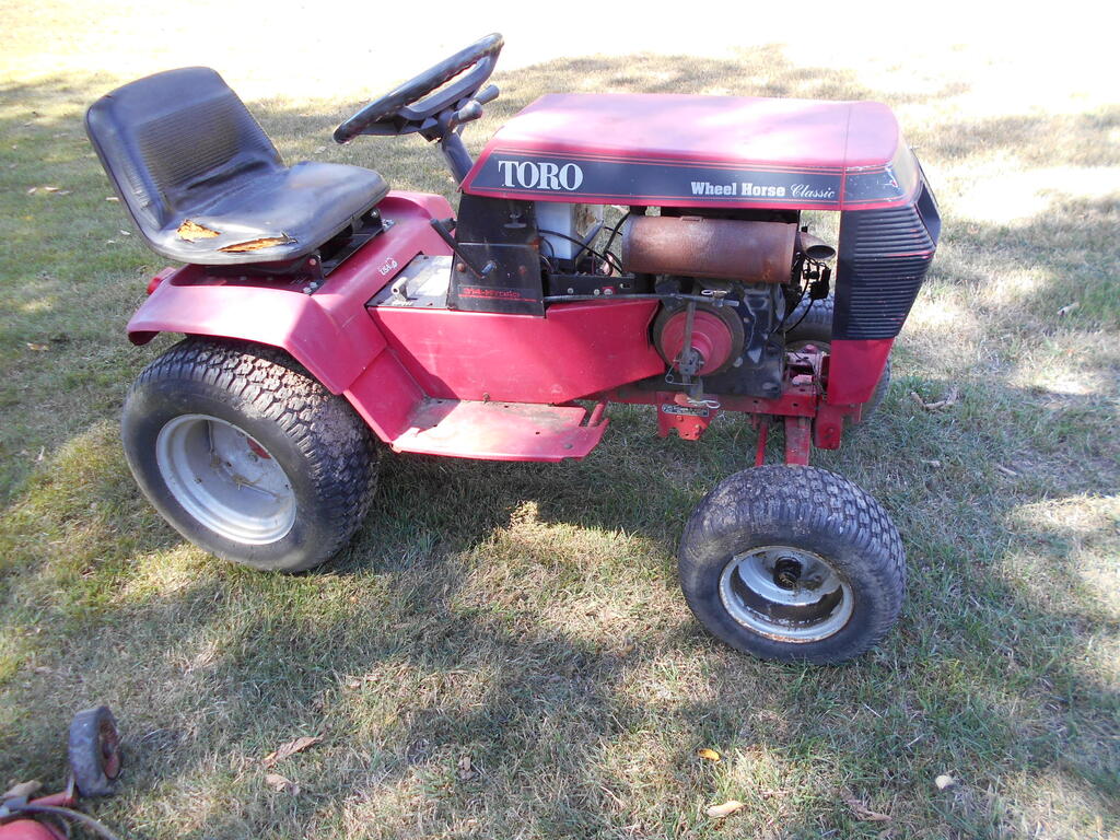

I dragged this machine home last summer and figured I might as well begin work on it.
This is what I am starting with.

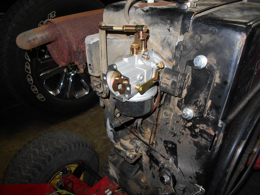

It had no carb so I got a cheap china carb for it and it will start by jumping the solenoid as the wiring has issues.
Hydro seems strong and engine runs quiet and as smooth as a single cylinder can.

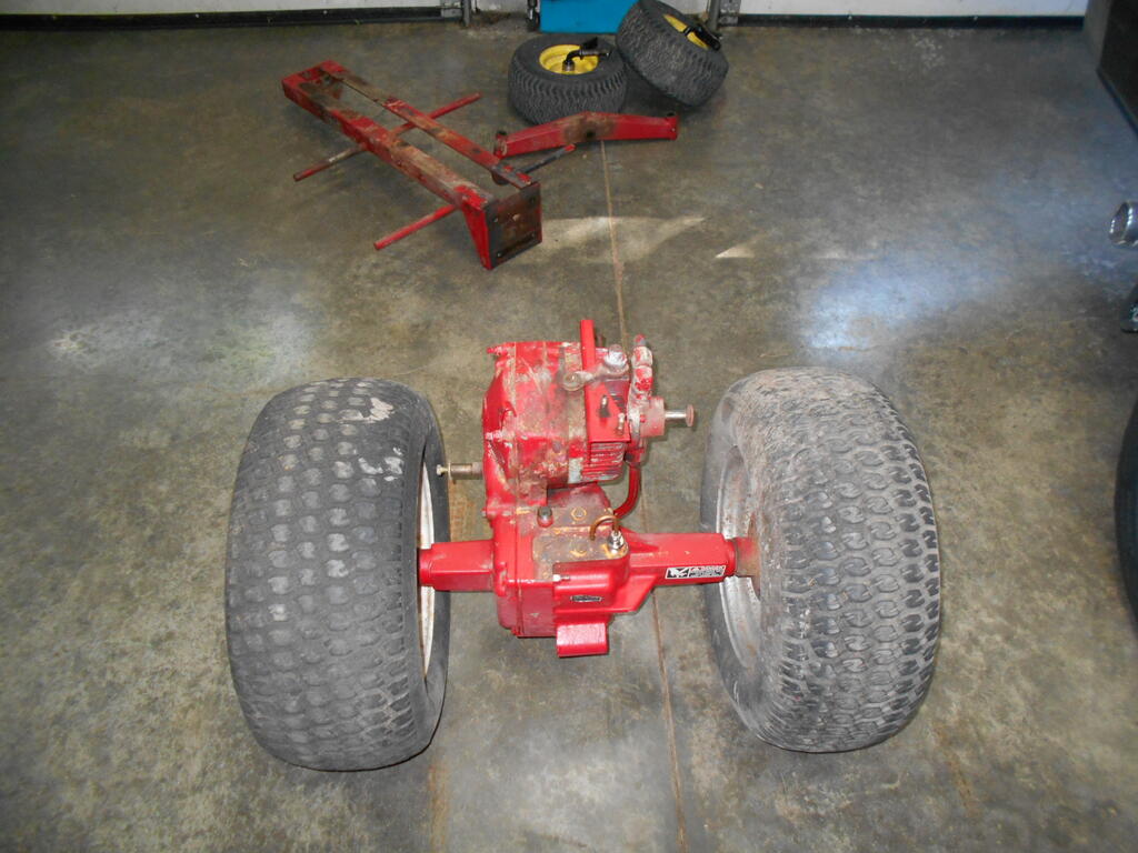

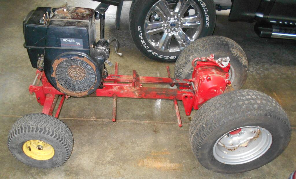

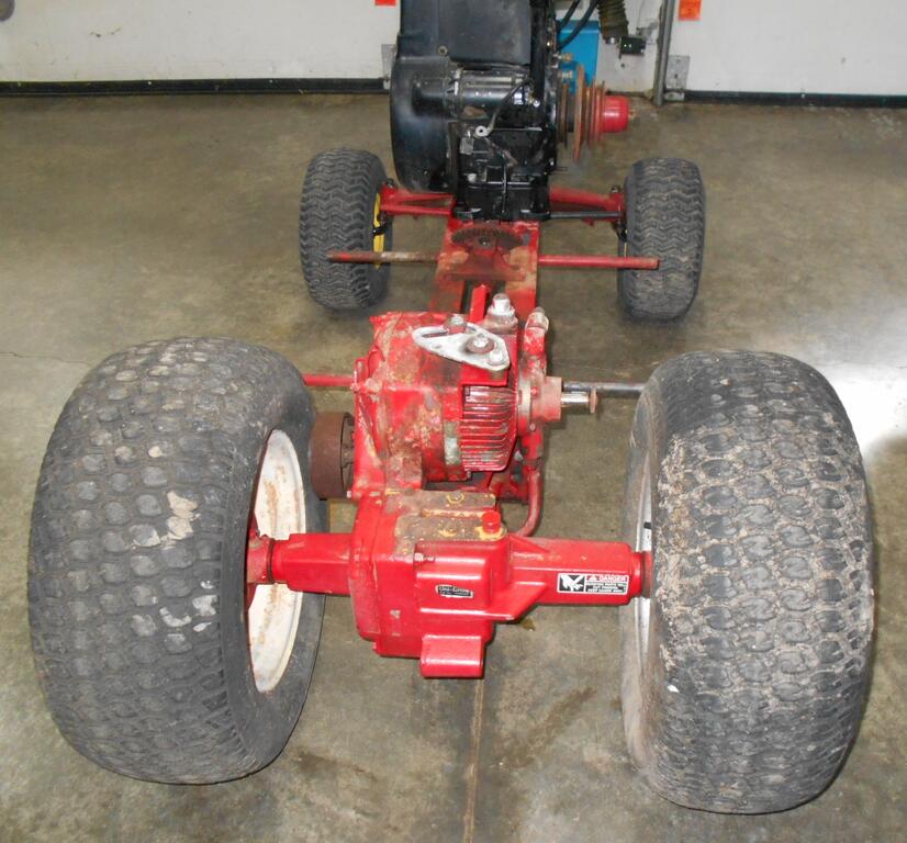

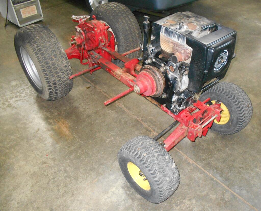

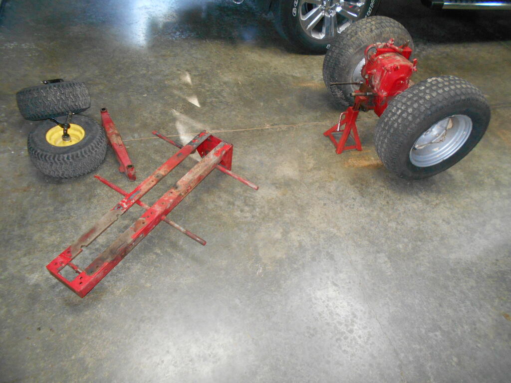

Tractor is mostly torn apart.
Frame, engine and rear end have preliminary degreasing done.
Don't mind the yellow wheels, they are just for moving the tractor around.

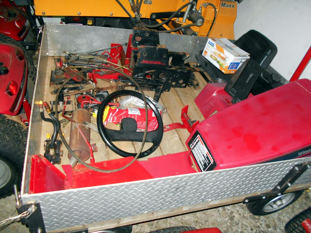

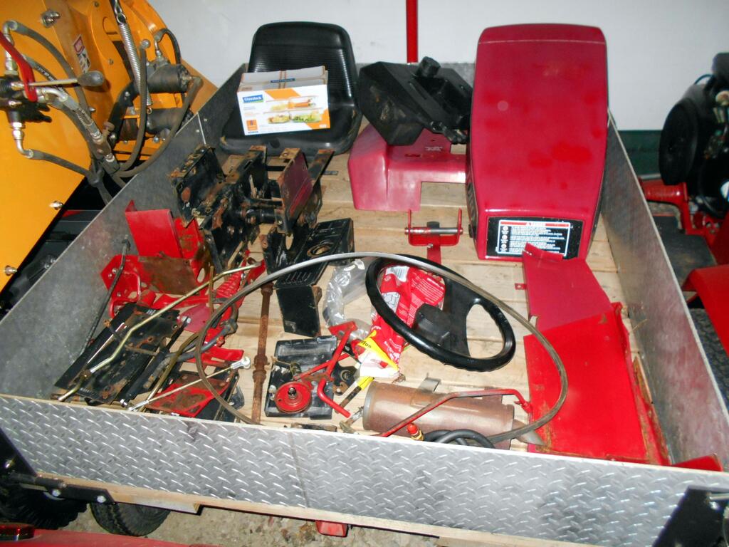

Wagon load of parts.
These are all cleaned up and ready for bead blasting and/or sanding.

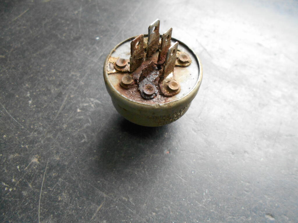

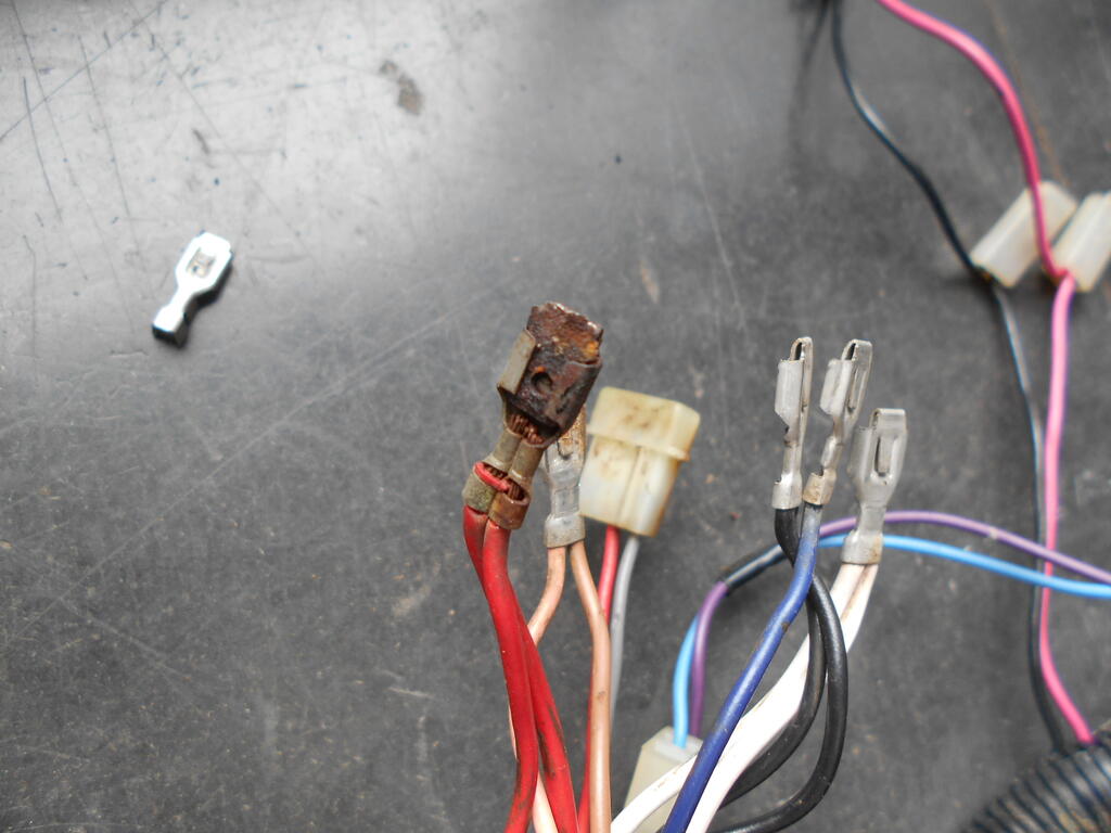

Well, I found out why the tractor needed the solenoid jumped to start it.
The battery connection terminal on the ignition switch is corroded completely.
Here is the old connector for the ignition switch.

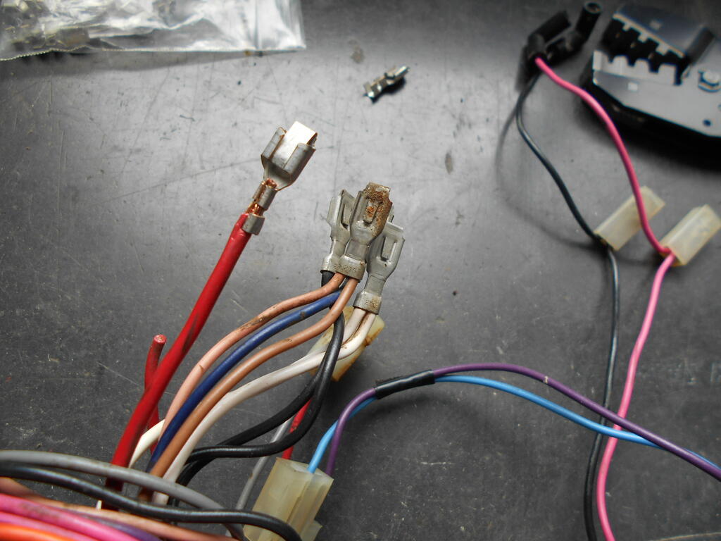

New connector installed.
614091325_Newbatteryterminalatignitionswitch.JPG.6136319ac24b227f23835c921ab3b996.JPG
The other connectors are in decent shape and will easily clean up.

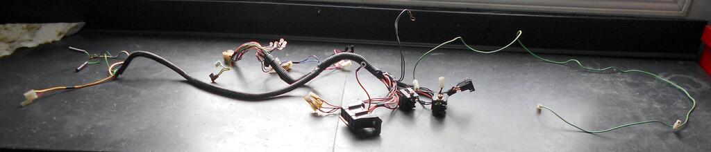

Since the indicator board is completely corroded as well, I decided to simply eliminate it and all it's associated wiring in the harness.
I also eliminated the seat switch and associated relays etc.
The neutral switch is gone as well since I will be installing a self centering foot control.

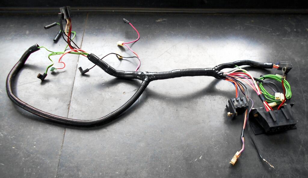

Here is the harness as pulled.

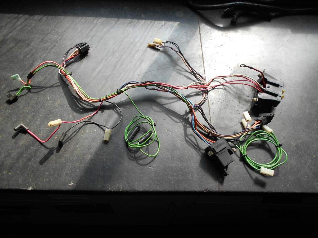

Here is the harness cleaned up and simplified.
Here is the harness ready to be installed.
I hooked it up to a battery and plugged in a new ignition switch, low oil relay, PTO switch, and 2 new fuses and tested all functions.
Everything works perfectly including grounding the magneto for shutdown (yes, I do have the correct magneto ignition switch).
