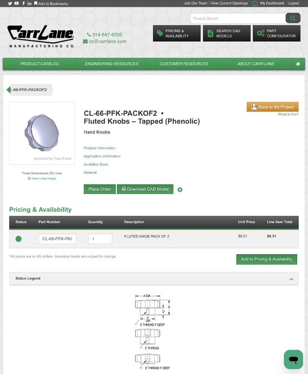

MainelyWheelhorse 3,133 #1 Posted July 9 (edited) I found these knobs while looking around online. My order hasn’t been shipped yet, but we’ll see how the process goes as Carr Lane deals primarily with industrial customers. So far so good though. Not to step on anyone’s toes but I thought I’d try them out and see how it goes. Edited July 9 by MainelyWheelhorse 2 1 Share this post Link to post Share on other sites

ri702bill 13,061 #3 Posted July 9 Looks like a Mule Drive Adjuster Knob... I have used plenty of both Carr Lane & Jergens parts over the years. They can be pricey, but excellent quality. 1 Share this post Link to post Share on other sites

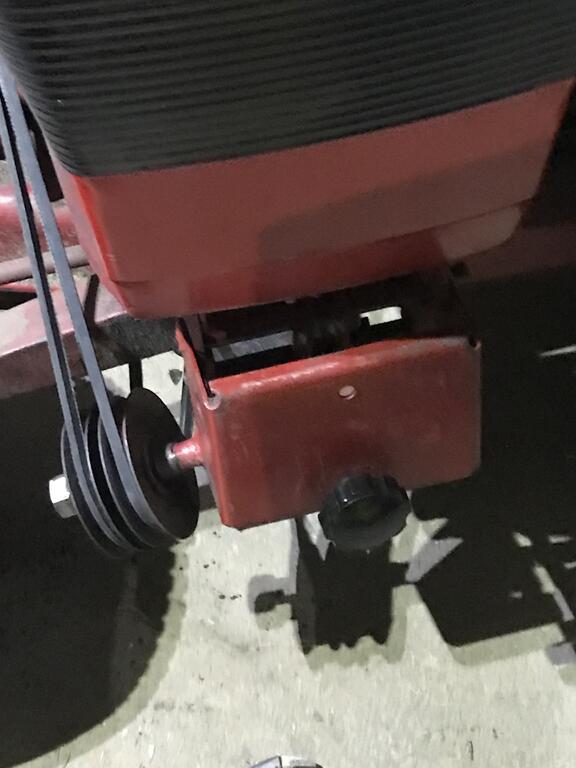

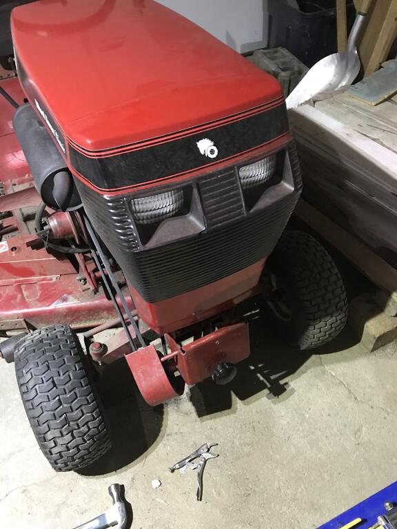

MainelyWheelhorse 3,133 #5 Posted July 9 @rmaynard it’s a replacement for the knob on my mule drive for the 42” RD. The original was long gone and was tightened by using a vice grip. I’m going to have to pin it but it’s supposed to be already tapped 3/8 -16 which was the same as the stock one from the info on here. I have access to a drill press so it shouldn’t be too bad. I figured I’d find something as close as I could get. @ri702bill That’s what I’m using it for. it looks promising and at roughly 5 bucks a knob before shipping the price wasn’t too bad as well. The ordering process takes some getting used to but I have it figured out now. Good to know about the quality. I figured it being industrial it should be pretty sturdy. We’ll see how it goes. It’s not an exact match but close enough to be usable. 3 1 Share this post Link to post Share on other sites
sqrlgtr 3,930 #6 Posted July 10 4 hours ago, MainelyWheelhorse said: already tapped 3/8 -16 All the mule drive adjusting knobs I have are splined and pinned on. Share this post Link to post Share on other sites
MainelyWheelhorse 3,133 #7 Posted July 10 1 hour ago, sqrlgtr said: All the mule drive adjusting knobs I have are splined and pinned on. I assumed they were threaded. There isn’t any splines inside the old brass insert on mine. I thought of tapping the end of the shaft 3/8-16, locktighting, and pinning it if need be. Share this post Link to post Share on other sites
Bar Nuthin 3,230 #8 Posted July 10 1 hour ago, sqrlgtr said: All the mule drive adjusting knobs I have are splined and pinned on. I need to pull this one off and see what kind of handy work went into making it. Share this post Link to post Share on other sites
MainelyWheelhorse 3,133 #9 Posted July 10 2 minutes ago, Bar Nuthin said: I need to pull this one off and see what kind of handy work went into making it. From what I’ve seen on mine, keeping with Wheel Horses philosophy of simplicity. There’s not much to them, the knob is pinned on(at least with mine) to what looks like a fine thread bolt with the head cut off. Simple direct stuff. Easy to fix. If someone had one to take measurements from and the knowledge and access to a machine shop they wouldn’t be super difficult to reproduce. Share this post Link to post Share on other sites
sqrlgtr 3,930 #10 Posted July 10 2 hours ago, MainelyWheelhorse said: I assumed they were threaded. There isn’t any splines inside the old brass insert on mine. I thought of tapping the end of the shaft 3/8-16, locktighting, and pinning it if need be. The brass? insert that is inside the plastic knob, has a splined outside diameter. The brass or whatever its made out off insert inside bore is smooth and pinned on to the mule drive adj. bolt. I should have been more clear in my description. Still don't know how clear this description is and hope I haven't confused you . Bottom line is Ive never seen one that has threads in knob. Share this post Link to post Share on other sites
MainelyWheelhorse 3,133 #11 Posted July 10 Ok, now that you phrased it that way I remember seeing the knurling/splines. Once it gets here I’ll look it over and see if I need to adapt it to work. 1 Share this post Link to post Share on other sites

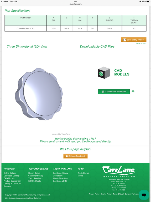

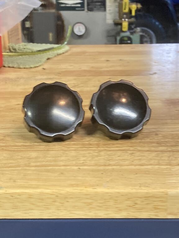

MainelyWheelhorse 3,133 #19 Posted July 14 I got the gold plated parts today. They are very, very, close to the original. If memory serves they are supposed to be an 1/8 smaller diameter but you can’t feel a difference. The 3/8-16 thread seems a bit small though. I’d assume they are pressed and pinned on as there are no threads on the adjustment shaft. Share this post Link to post Share on other sites
sqrlgtr 3,930 #20 Posted July 14 Yeah the original just slip on then a roll pin goes through it and the Mule Drive shaft/adjustment screw. You will have to do some careful ciphering to get the hole in the right place on the knob so it will line up with the shaft part. 1 Share this post Link to post Share on other sites
MainelyWheelhorse 3,133 #21 Posted July 16 (edited) I got it on, it’s blue locktited and the shaft is threaded 3/8-16. So far so good, it seems to be working like it should and able to spin to tighten down to hold tension. Edited July 16 by MainelyWheelhorse Share this post Link to post Share on other sites
