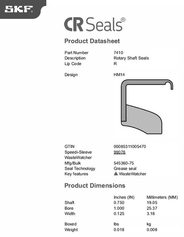

Thegearhead0324 1,902 #1 Posted June 30 I have a quick question, looking through the forum I think I found the answer, but on my 1257, the brake drum shaft seal, would part number SKF 7410 be the correct seal? I see rock auto has one and wanted to make sure. Thank you. Share this post Link to post Share on other sites
gwest_ca-(File Mod) 12,557 #2 Posted June 30 Best to compare the specs against what you want to replace. Notice the CR/SKF seal numbers closely represent the shaft size. 3/4" shaft or .750" is close to the 7410 seal number. Share this post Link to post Share on other sites

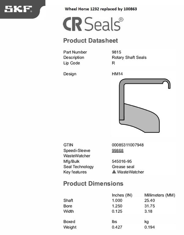

702854boy 1,245 #3 Posted June 30 SKF seal #9815 is the seal that you need for the brake drum, it is the same as the axle seals on 1 inch axles. 1 Share this post Link to post Share on other sites
gwest_ca-(File Mod) 12,557 #4 Posted June 30 WH 1232 replaced by 100863 Share this post Link to post Share on other sites
ri702bill 13,391 #5 Posted June 30 Best to stay away from the off-brand not-made-around-here cheap knockoffs. Unless you want to do the job over... Note the CR ad gives a Speedi-Sleeve P/N too. Great to fix a gouged up shaft. Share this post Link to post Share on other sites

squonk 48,427 #10 Posted June 30 7410 is the seal # and is also the Napa # 2 1 Share this post Link to post Share on other sites
gwest_ca-(File Mod) 12,557 #11 Posted July 1 Is the original seal not #1232? Share this post Link to post Share on other sites
