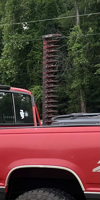

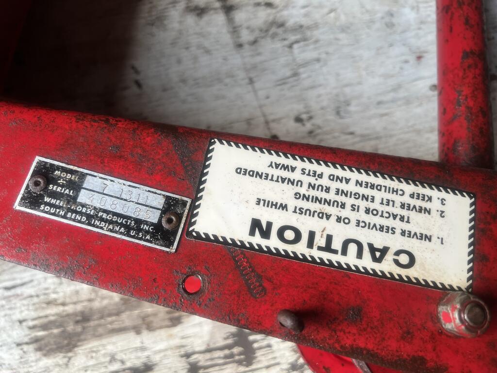

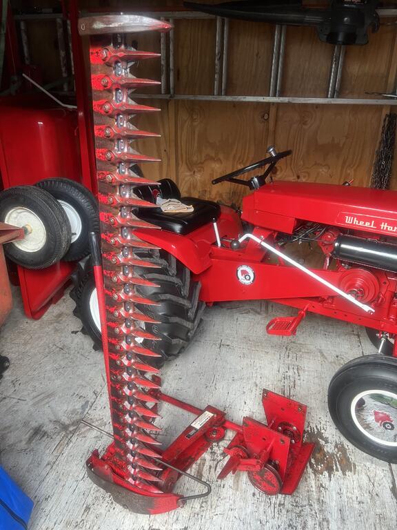

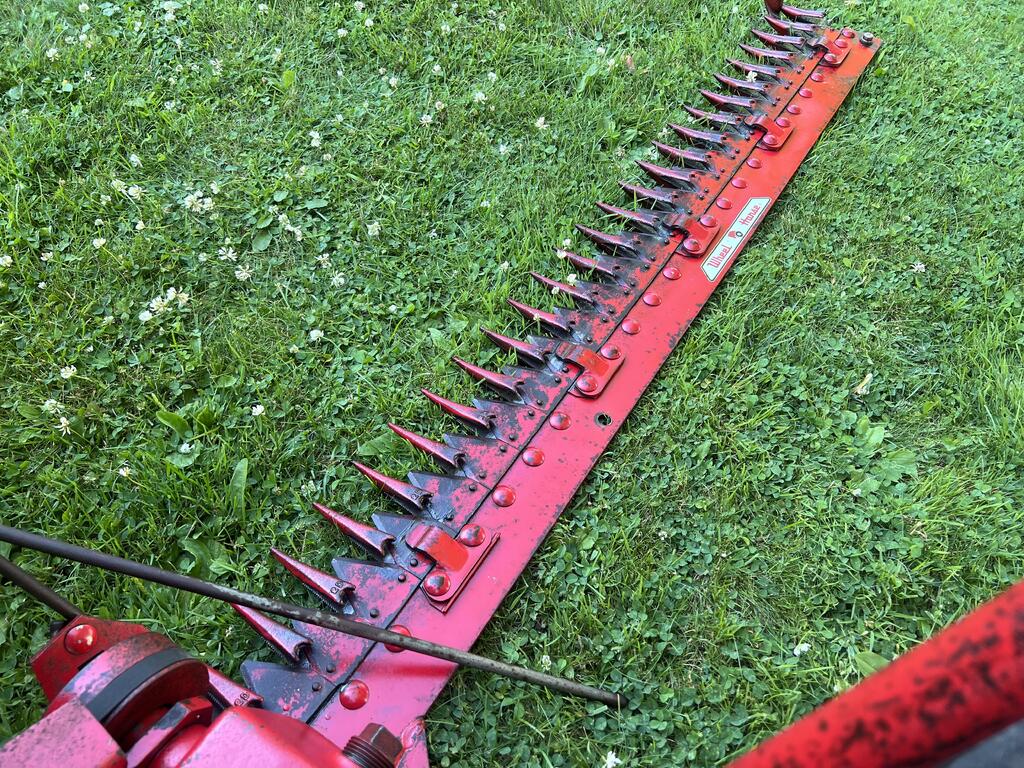

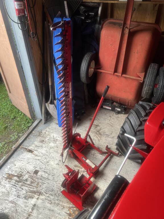

Thegearhead0324 1,842 #1 Posted June 26 Finally, after missing my other one I sold a few years ago, I bought one at the big show today. Looking forward to gettin it in top shape. 3 7 Share this post Link to post Share on other sites

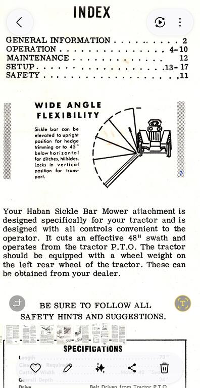

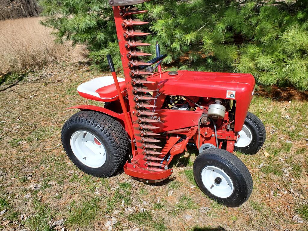

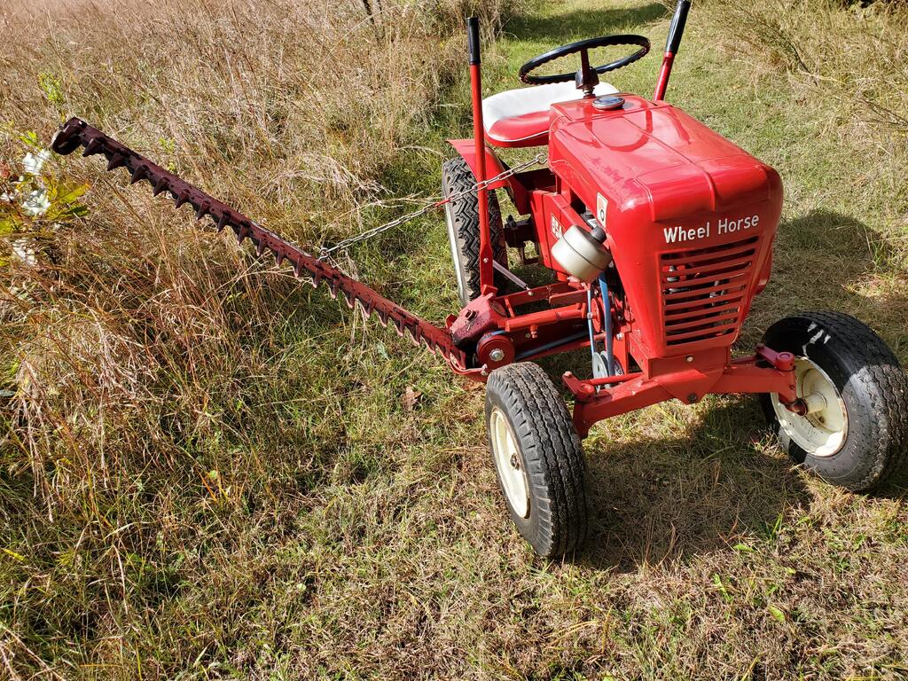

Racinbob 13,187 #7 Posted June 27 I had one for 20-25 years before the move to Florida in 2000 when it was sold in the auction. After coming back up here in 2017 I started looking for another one. Finally, after running an ad, I found one less than 15 miles from here. A guy bought it in an auction and after realizing seeing that it was so rusted solid he must have figured it was unsavable. I didn't see it that way. Here's the thread. Sickle Bar Finally - Implements and Attachments - RedSquare Wheel Horse Forum 8 hours ago, adsm08 said: I don't even know what they are good for. If ya need one you'll know. Mine runs at about a 45° angle about 90% of the time. I keep the briars that intrude on the paths out back clear. 7 hours ago, 8ntruck said: I've got a ditch on my Ky. property where a sickle mower that could angle down would be really handy - except for the rocks that are in the ditch..... The Wheel Horse model doesn't angle down but a very few degrees. I've heard the Haban will go more but I can't verify. 2 2 Share this post Link to post Share on other sites
gt14rider 1,278 #8 Posted June 27 Haban 414 for GT14. 3 1 Share this post Link to post Share on other sites

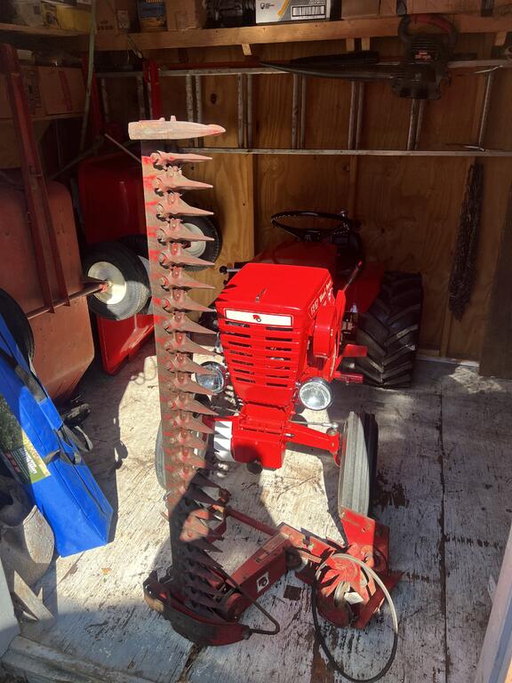

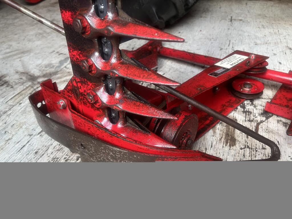

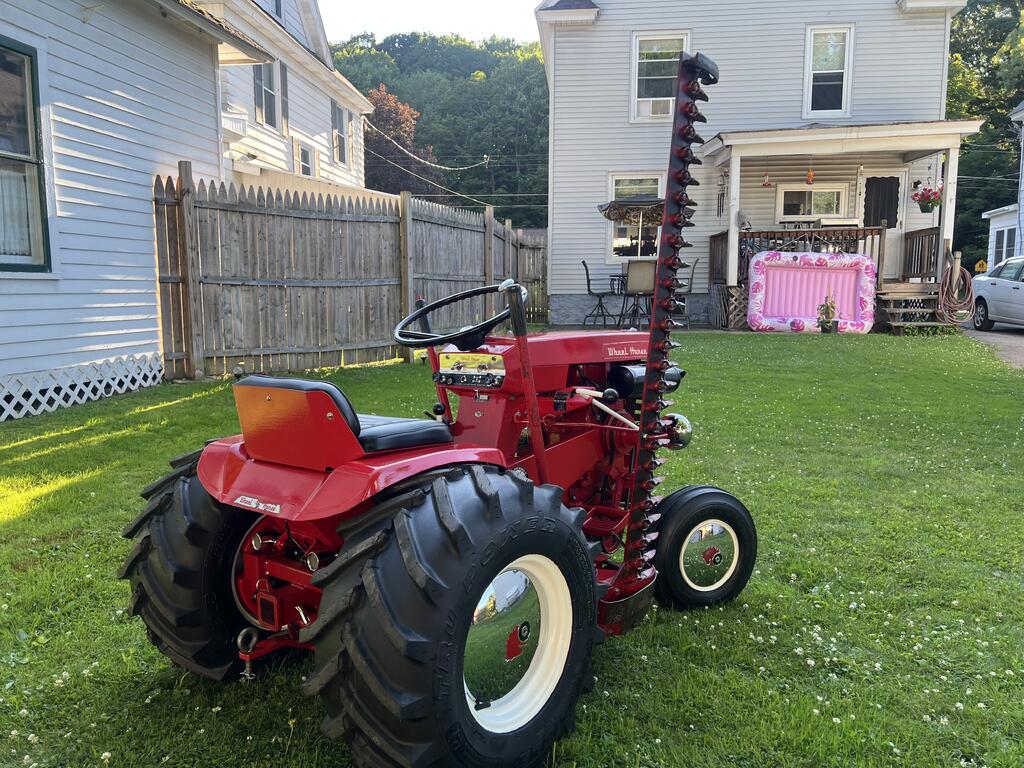

Thegearhead0324 1,842 #10 Posted June 27 Here’s a better pic of it, when I get time I’ll be starting on it. 2 1 Share this post Link to post Share on other sites

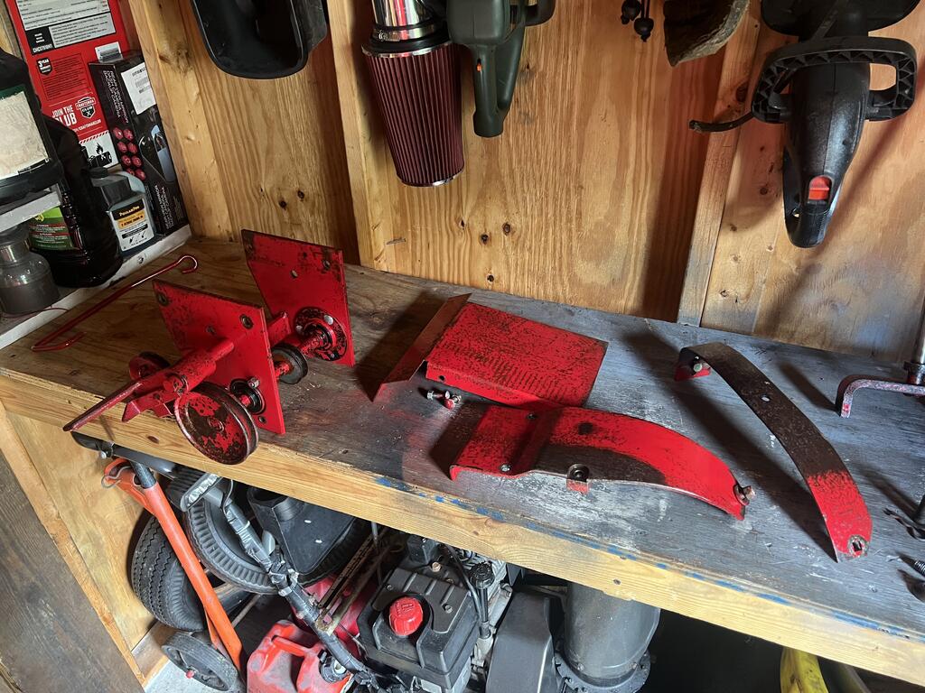

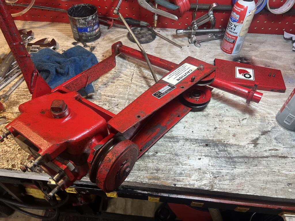

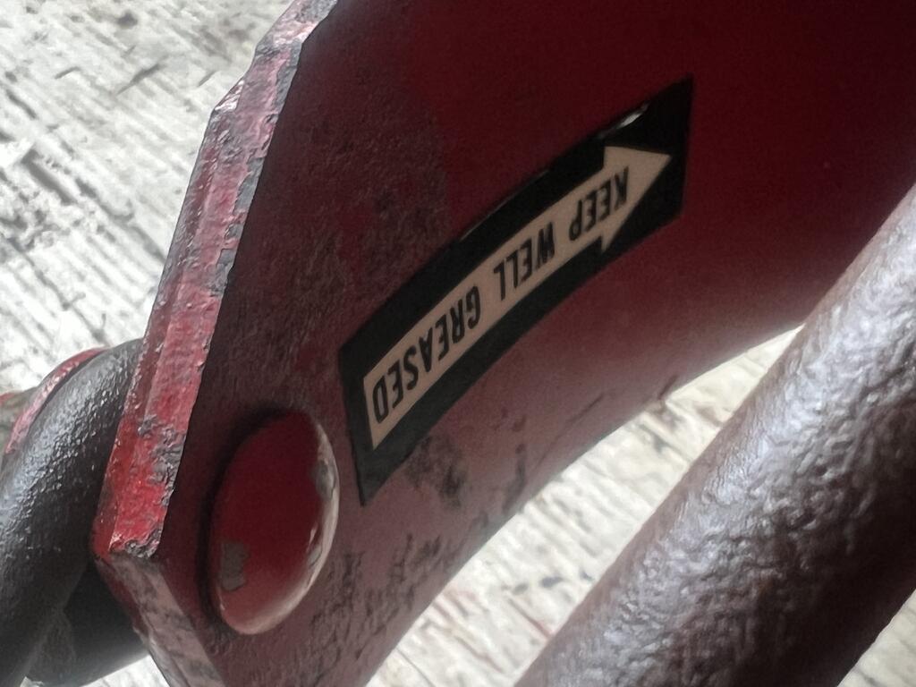

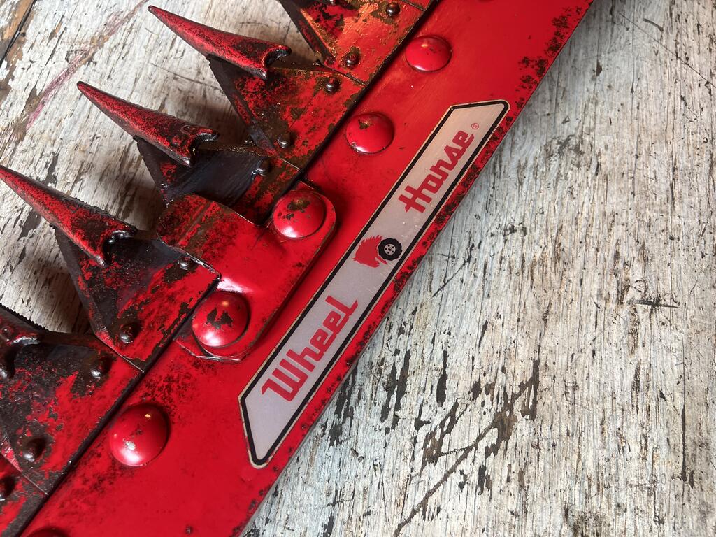

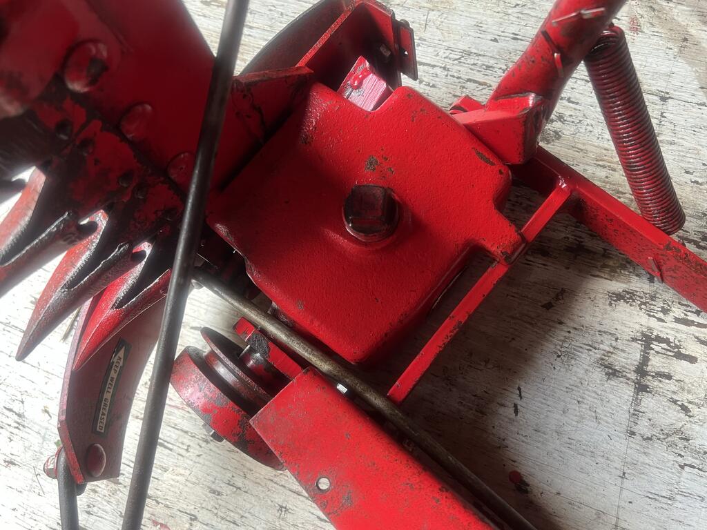

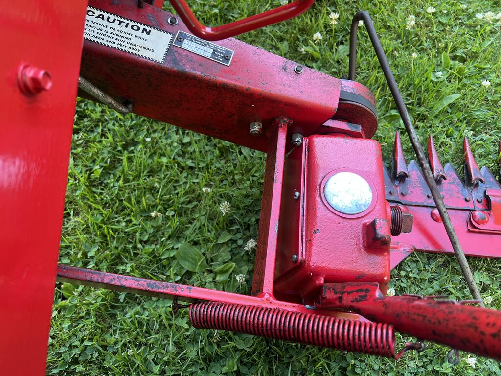

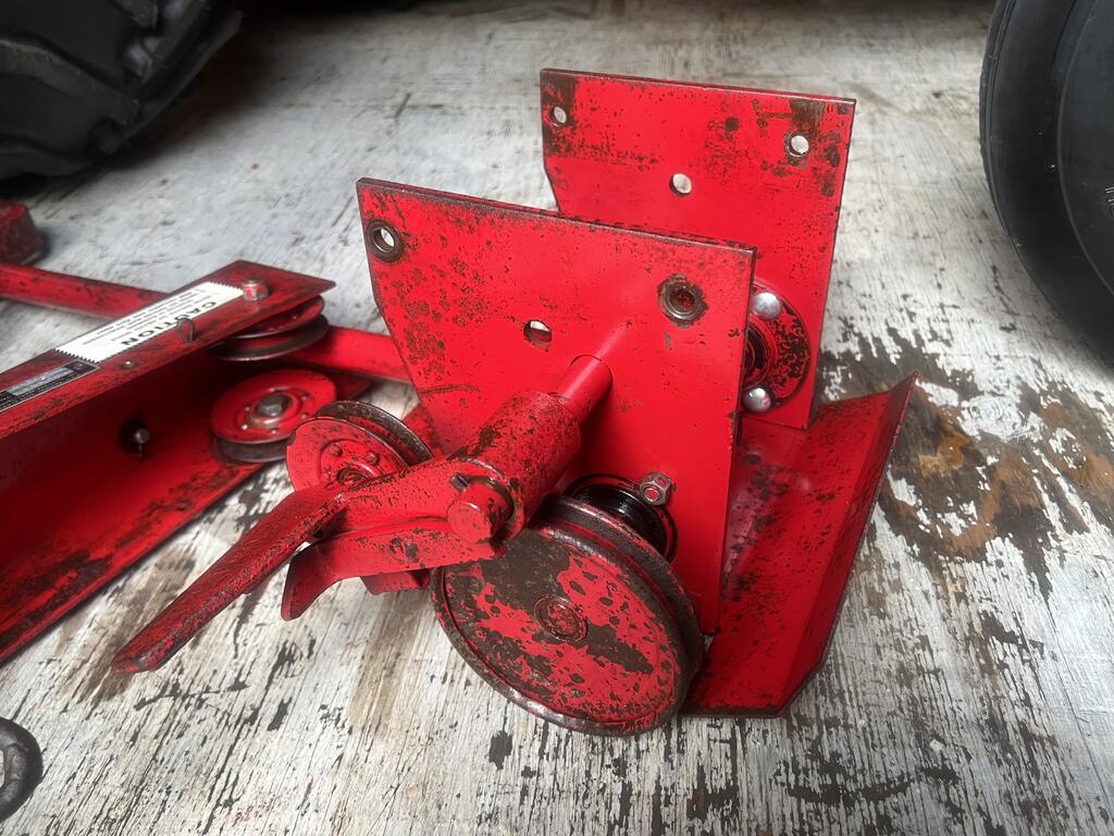

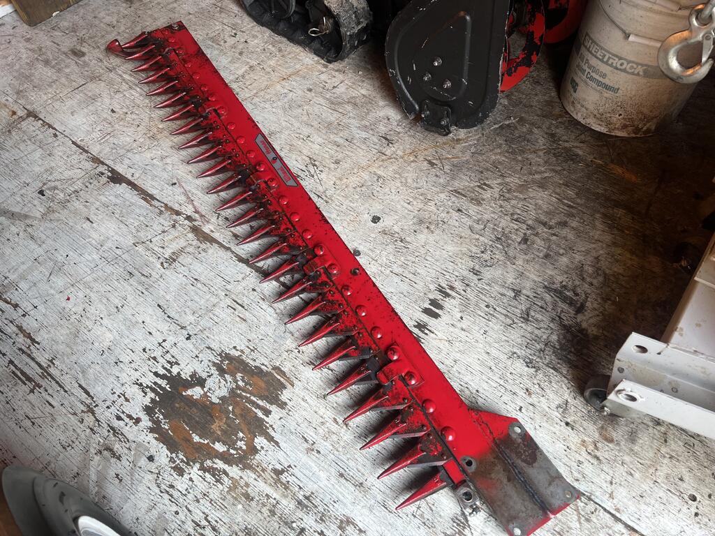

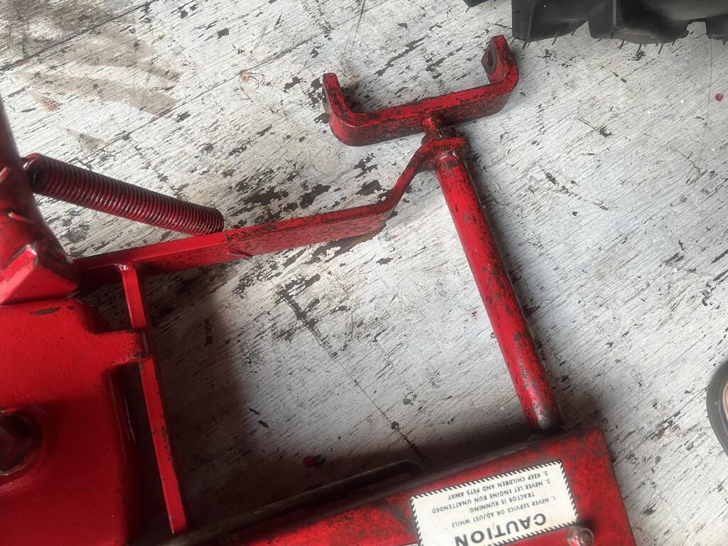

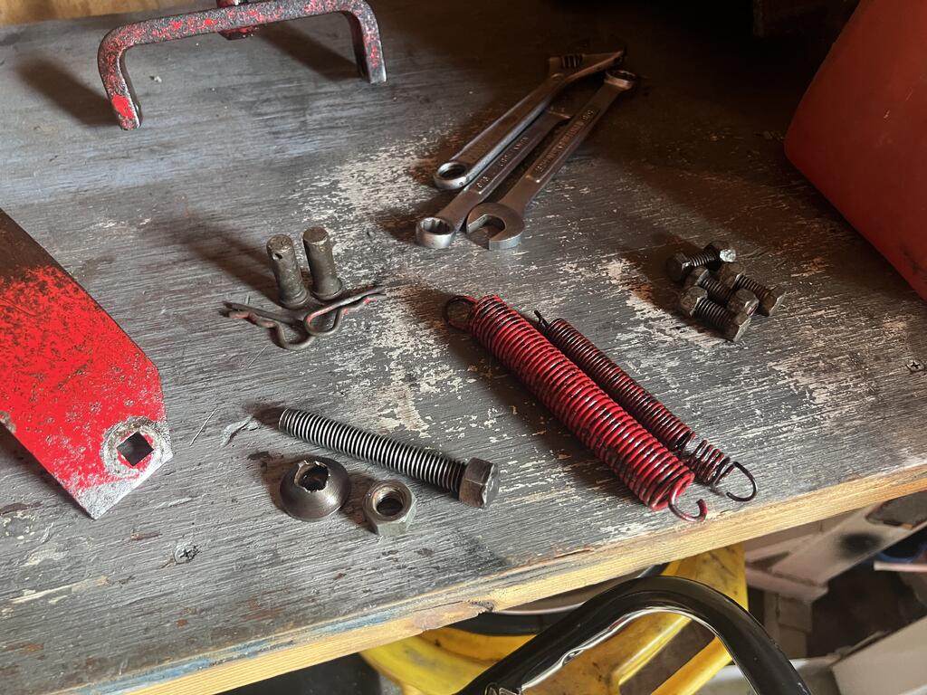

Thegearhead0324 1,842 #14 Posted July 1 While the warden took an overnight trip to Buffalo, I made a bit of progress on the unit. I took it apart, gently washed all the pieces with soap and water, then rubbed in my favorite juice and keeping its “patina.” Greased and lubed what was needed, and started putting it back together. It has all the original decals in good shape. 2 Share this post Link to post Share on other sites

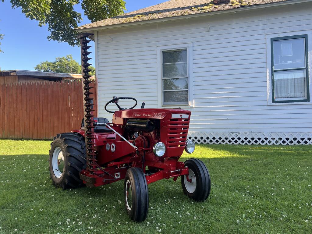

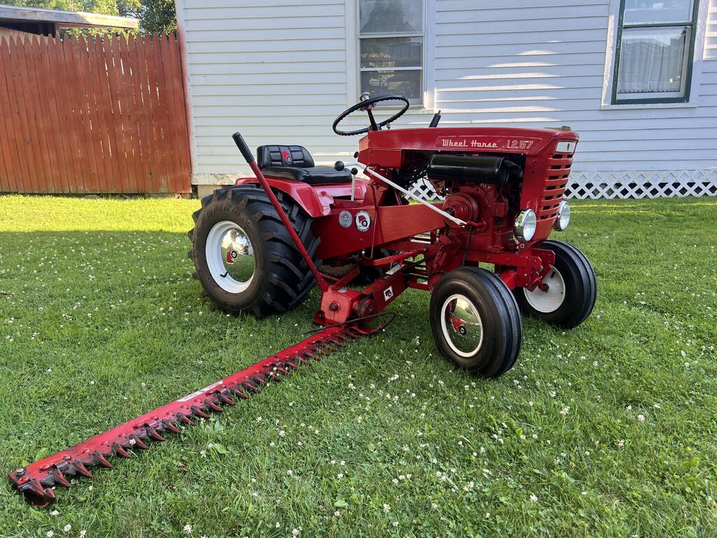

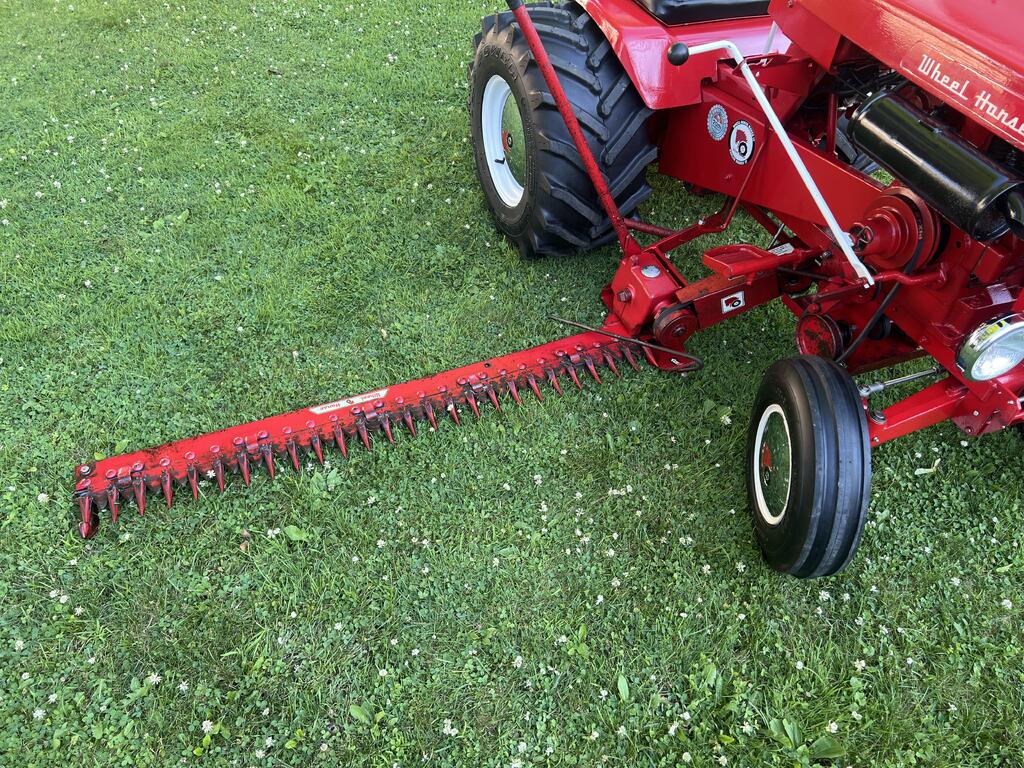

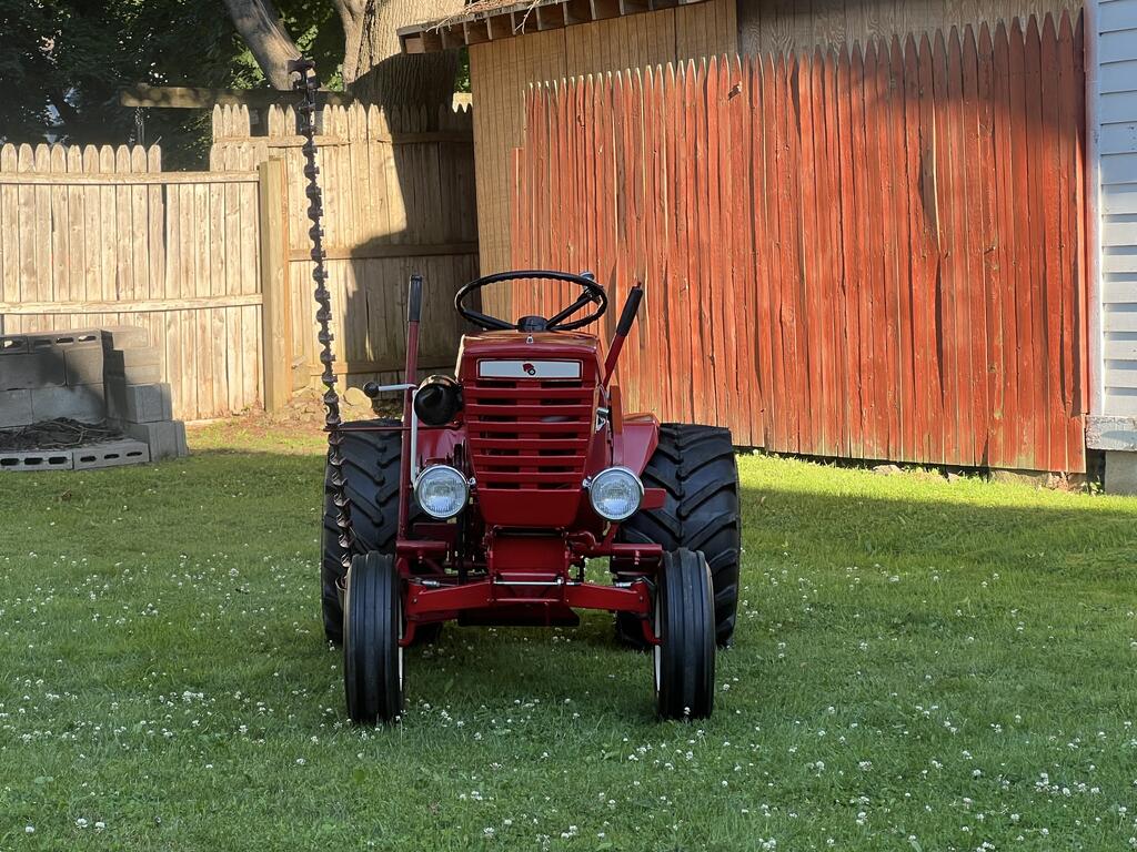

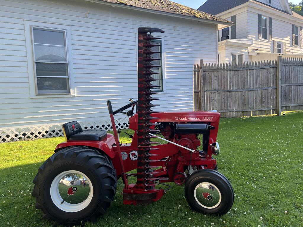

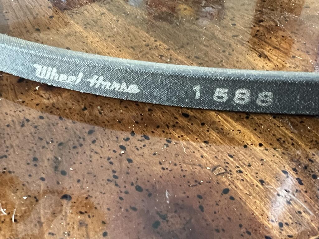

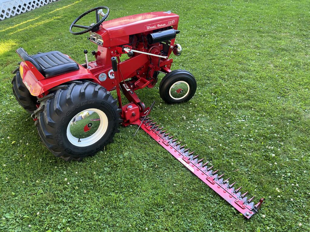

Thegearhead0324 1,842 #16 Posted July 8 Here’s the ol 1257 with the 1311 50” sickle bar. The assembly has original decals and original “patina” paint. Works as it should. It has a “new old stock” wheel horse belt I put on it. Everything’s lubed, 30 weight oil in the wobble box, etc. 4 Share this post Link to post Share on other sites

Thegearhead0324 1,842 #21 Posted July 8 @c-series don Same for me, I have no need for one right now. I had one prior and sold it, regretted it. Couple years later I saw this one for sale and picked it up at the big show couple weeks ago. My old one was beat up so had to repaint it and replace parts. This one I just stripped apart, cleaned, wiped down and greased up with new belts. 1 Share this post Link to post Share on other sites
