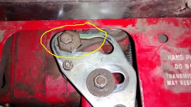

Strokerace2639 4 #1 Posted June 15 Hello all, I have a 1990 312-H in my possession that I have used for SEVERAL years. The trans has started to act up for a while. at first it would jump from forward to reverse on its own. even though it was very had to move the direction lever by hand. then it became "LURCHING" ( almost picking the front wheels off the ground) on movement. the only way I have found to stop it is put the mower in very low idle move the direction lever to the forward and then increase throttle to get up to speed. What are the suspect issues and are there parts still out there to fix any issues? Feel free to ask any question you have have. Thank You, AS Share this post Link to post Share on other sites
gwest_ca-(File Mod) 12,557 #2 Posted June 15 Sounds like you may have linkage/control problems. Have you removed the seat pan to clean the top and front of the transmission? 1 1 Share this post Link to post Share on other sites
Handy Don 17,735 #3 Posted June 15 Yep. One or maybe several places in the linkage are out of whack due to wear or debris. Share this post Link to post Share on other sites
squonk 48,427 #4 Posted June 15 Cam and guide plate wear out 3 Share this post Link to post Share on other sites
953 nut 70,649 #5 Posted June 15 Sounds like a bit of deferred maintenance issues. The cam and plat as Mike @squonk mentioned are the prime suspects. Read through the manual Gary @gwest_ca provided and be sure your linkage is not binding someplace. If you need the cam and plate K&B has new ones. 1 Share this post Link to post Share on other sites
Strokerace2639 4 #6 Posted June 15 4 hours ago, gwest_ca said: Sounds like you may have linkage/control problems. Have you removed the seat pan to clean the top and front of the transmission? THANK YOU. that will be helpfull. 1 Share this post Link to post Share on other sites
Lee1977 7,813 #7 Posted June 16 My 520-H was almost imposible to get out of reverse when I got it,. would have to hit the brake to get it to release. Found the cam had a groove worn in the and the cam plate worn. Replaced both and new heavy duty 1/4" heims joints on the control shaft... Lee1977 4 Share this post Link to post Share on other sites
