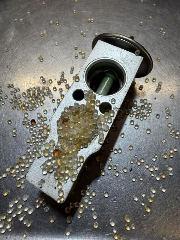

Blaine 276 #20 Posted July 16 (edited) If the compressor parts are tiny enough to pass through the expansion valve, it would be smooth sailing on the way out of the evaporator, don’t ya think? Sounds like the new expansion valve trapped more compressor trash. I’ve never seen a clogged evaporator, just leaky ones. The condenser includes the receiver/dryer, so i’d replace the condenser because it’s probably full of compressor trash, flush the lines, replace the compressor and throw another expansion valve on it. 2 oz’s of pag46 oil in the condenser and most compressors are prefilled with oil now so you’d be good there. kinda hard to believe a trashed compressor would be capable of 300psi though. Chances are it’s just a junk expansion valve right out of the box. Quality parts are getting rare these days. edit: i’d blow air through that evaporator to see the clog for myself. Wouldn’t be the first time something came in to our shop from another shop with an enormous estimate because they didn’t know what was wrong and priced it sky high to get out of it. Edited July 16 by Blaine 1 Share this post Link to post Share on other sites

adsm08 5,247 #23 Posted July 16 1 hour ago, squonk said: If the Evap was "clogged" it was clogged with compressor innards or somebody put sealer in it. Since it's a Chrysler/ Stellantis product, I suspect both! As I have said before, based on seeing it often enough, his desiccant bag failed and allowed the silica to get free in the system. Those particles are plenty big enough to clog an evap core internally. And since when is a Ford Edge a Stellantis product? 1 Share this post Link to post Share on other sites
Blaine 276 #24 Posted July 16 I’m still struggling to understand how anything would get inside the evaporator to clog it. I just threw about 813 silica beads at this expansion valve and not one of them made it through. Share this post Link to post Share on other sites
squonk 48,427 #25 Posted July 16 1 hour ago, adsm08 said: As I have said before, based on seeing it often enough, his desiccant bag failed and allowed the silica to get free in the system. Those particles are plenty big enough to clog an evap core internally. And since when is a Ford Edge a Stellantis product? Forgot. Thought he had a Jeep. Share this post Link to post Share on other sites
