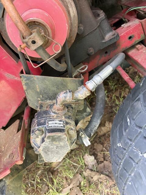

AHS 1,698 #1 Posted June 7 New to me. 314-H FEL. The loader works great, but some housekeeping to do to it. 1; the belt 32”? 2; the bottom suction hose 3/4” x 40’ 3; Hydraulic fluid The belt is cracked and way too tight. The slide bolts are at their tightest position and the belt is already tight! I hear it’s supposed to be 32”. (Must have had a 30” belt on there?) the bottom suction hose is cracked, and i want to replace it. It doesn’t look like too high a pressure hose with the two band clamps? Hydraulic fluid…. Which kind do i use? 1 Share this post Link to post Share on other sites

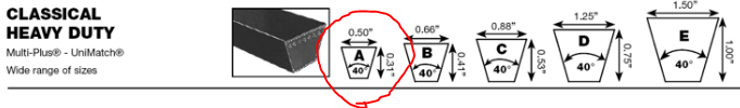

JoeM 10,142 #5 Posted June 7 (edited) You can get a 31" belt, you have to measure the outer circumference. It is an 1/2" or A belt width. The 31" is called A29, the 32" is a A30 Should use suction hose for the pump input Hydraulic Fluid is AW32 Works good in all weather conditions. Not sure if yours has a suction filter or it may have a screen in the tank on the output, might pay to check. Edited June 7 by JoeM 4 Share this post Link to post Share on other sites

wallfish 20,504 #7 Posted June 7 1 hour ago, AHS said: The belt is cracked and way too tight. The slide bolts are at their tightest position and the belt is already tight! I hear it’s supposed to be 32”. (Must have had a 30” belt on there?) It also appears like it's rubbing the PTO hoop. I think a 1/2" belt will slip on the PTO pulleys because they are designed for a wider 5/8 belt and not variable like many aftermarket pulleys are designed. Maybe that's why it's so tight but IDK. If the pump pulley will handle a wider belt then go with a wider belt. The suction hose doesn't have any pressure on it. But use a stiff hose because stronger suction pressure could collapse a flimsy hose. The reason for asking about the color is to see if it's ATF or motor oil. It possible it could've been changed to hydraulic fluid too. 5 1 Share this post Link to post Share on other sites

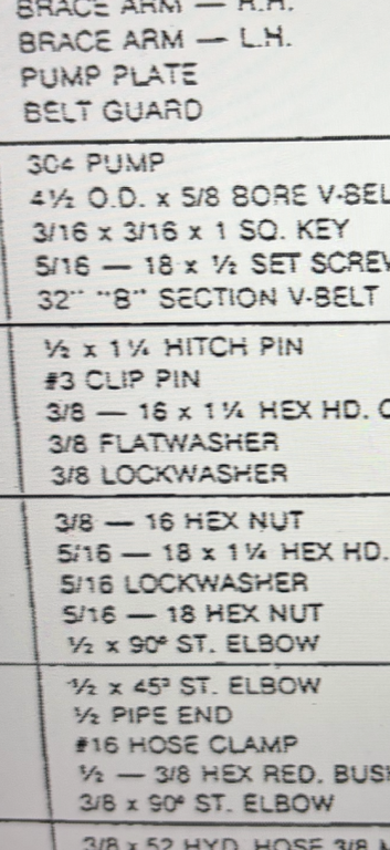

AHS 1,698 #9 Posted June 7 @JoeM Ok. Ive never heard of a ‘8’ belt before? 1 Share this post Link to post Share on other sites
JoeM 10,142 #10 Posted June 7 I am sure it is a typo. It is an A or 1/2" belt. The best way is to take it off and measure it or better yet take it to the store and get a slightly longer one. 5 minutes ago, wallfish said: I think a 1/2" belt will slip on the PTO pulleys because they are designed for a wider 5/8 belt Your thinking of the transmission drive belt the deck belts are 1/2" 3 Share this post Link to post Share on other sites

squonk 47,885 #17 Posted June 7 2 hours ago, AHS said: @JoeM Ok. Ive never heard of a ‘8’ belt before? That was probably supposed to be a "B". A 32" B Belt is #B29 or 5L320W (Gates) 4 Share this post Link to post Share on other sites

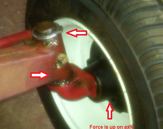

ri702bill 12,788 #18 Posted June 7 You MAY need to trim the axle boss height to allow room for the thrust washer & upper snap ring... When I redo an axle, I take the material off the bottom of the axle bosses to make the surface flat and perpendicular to the spindle bore... and will want to try out that thrust washers on the bottom of the spindle trick! 2 Share this post Link to post Share on other sites

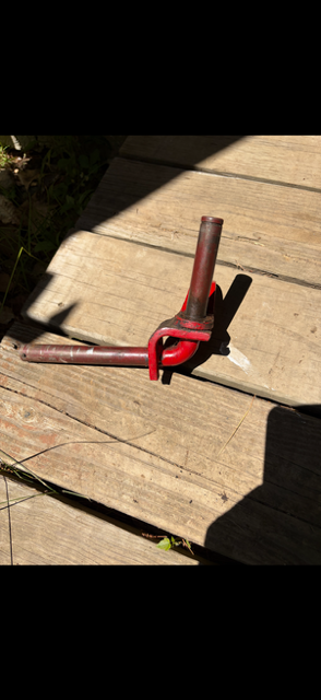

Handy Don 17,304 #20 Posted June 7 2 hours ago, ri702bill said: You MAY need to trim the axle boss height to allow room for the thrust washer & upper snap ring... When I redo an axle, I take the material off the bottom of the axle bosses to make the surface flat and perpendicular to the spindle bore... and will want to try out that thrust washers on the bottom of the spindle trick! Bill gave this treatment to our non-FEL 312-H and it radically reduced steering effort. While examining steering bits, look closely for bent spindles, too. This spindle shows the HD bracing--also an important strengthening. 4 Share this post Link to post Share on other sites

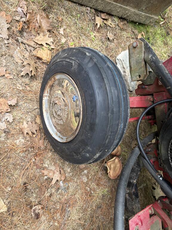

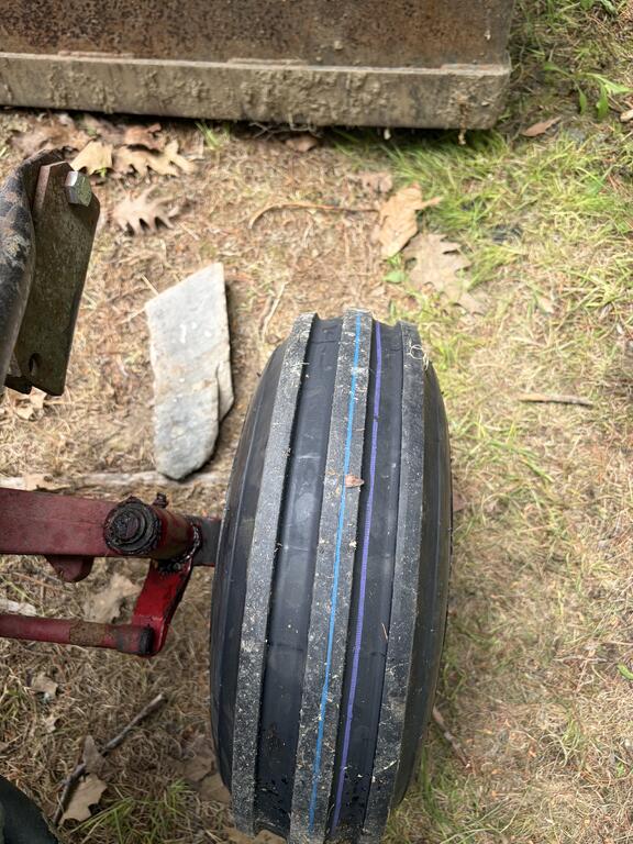

AHS 1,698 #25 Posted June 21 The biggest improvement that Ive made…. Bought myself a pair of tri rib 4x8 tires, tube type, slapped those on!! WOW!!! What a difference in steering!!! Biggest improvement yet!! 2 Share this post Link to post Share on other sites
