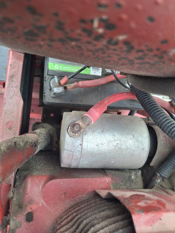

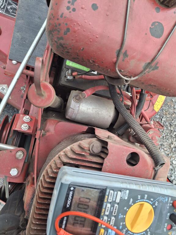

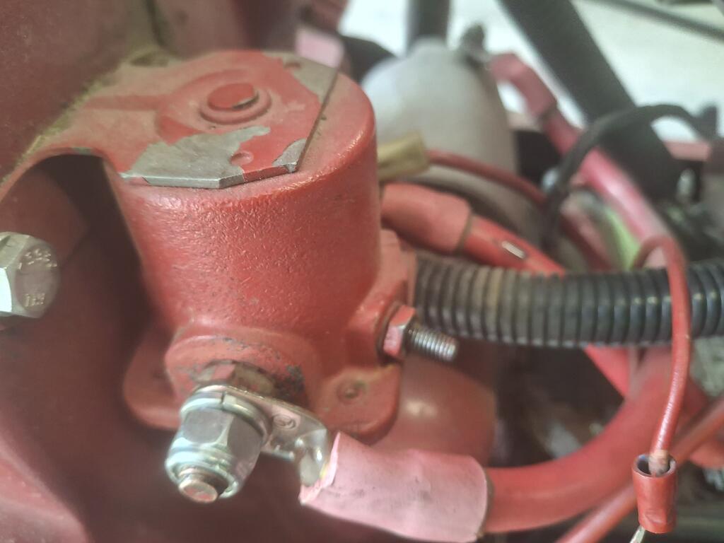

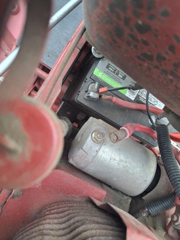

squonk 47,381 #1 Posted June 6 @953 nut and I both preach " CHECK ALL CONNECTIONS!!!! " I put a starter in my C160 about 4 years ago. It was used. Always fires right up and isn't overly noisy. I mowed this AM and shut it off. Mowed this afternoon and parked it in the driveway so I could blow the grass off of it like I always try to do. Tractor sat for about 4 hrs and when I went to start it the dreaded " Solenoid clicks but it doesn't crank." Everything looked pretty good and testing at the starter terminal revealed 12.9 volts with the key in the start position. Here is a picture of the starter and cable. Really doesn't look bad at all: I put my hand on the terminal with the key in crank and a spark!!! So I yanked off the terminal and inspected it. Looked fairly clean but I got some sand paper out and polished things a tad and she fires up so I don't have to push it! Just goes to show you what a little "fuzz" on a connection can do. 9 3 Share this post Link to post Share on other sites

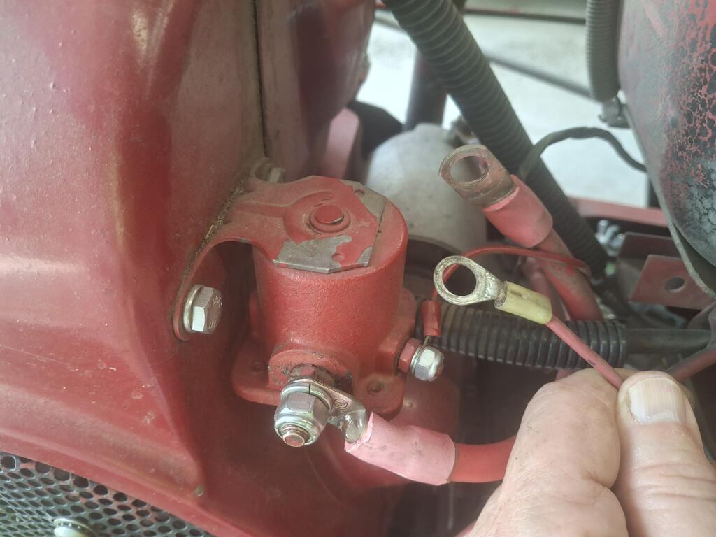

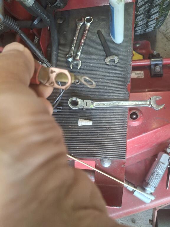

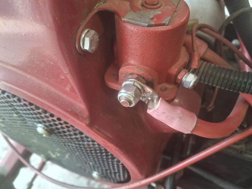

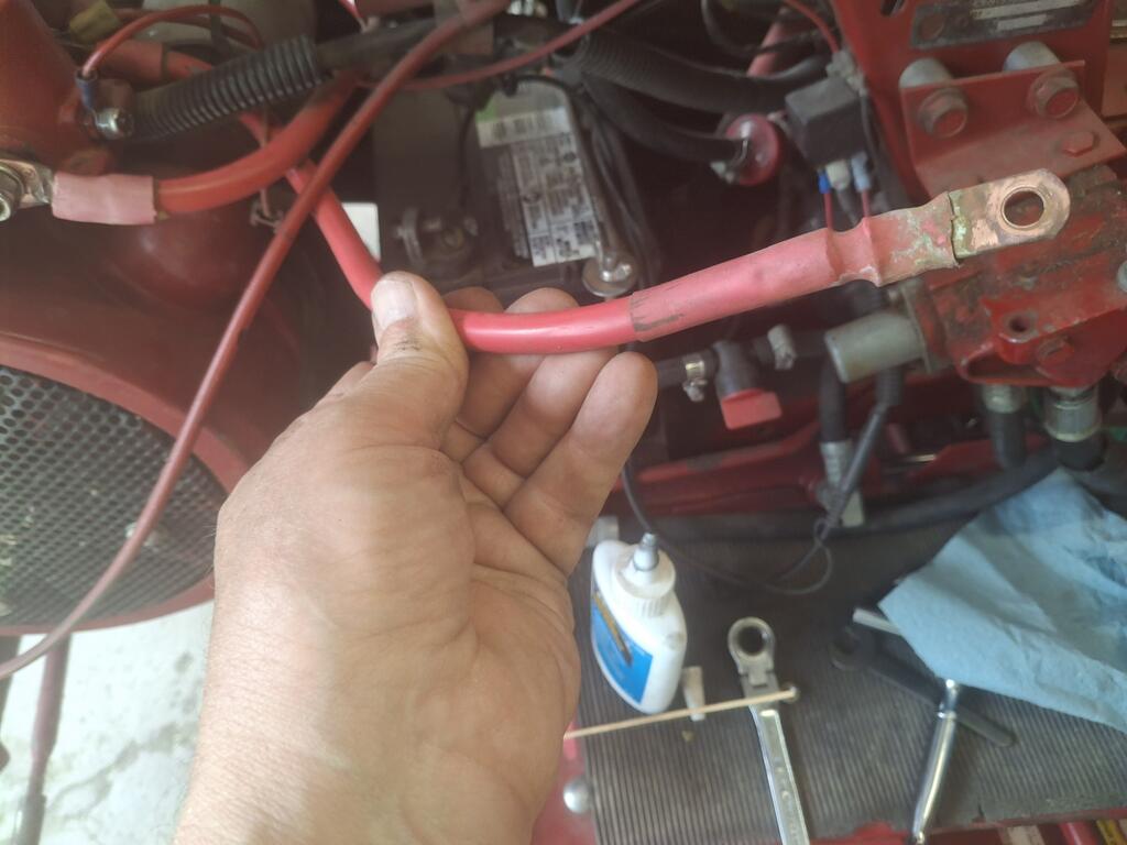

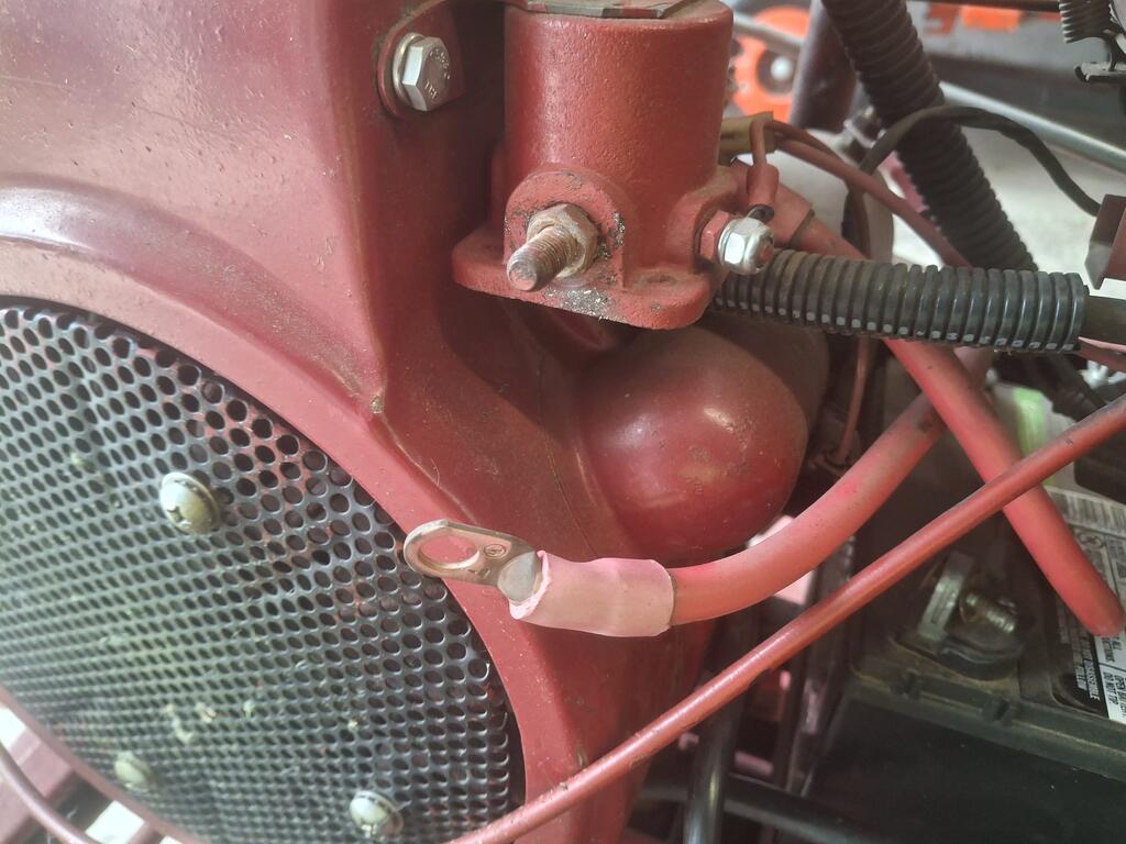

squonk 47,381 #16 Posted June 6 Took all of the connections apart that had anything to do with the starter circuit. Buffed the solenoid terminals, new nut on the starter, cleaned all the lugs and added Noalox to all of them. 1 5 Share this post Link to post Share on other sites
