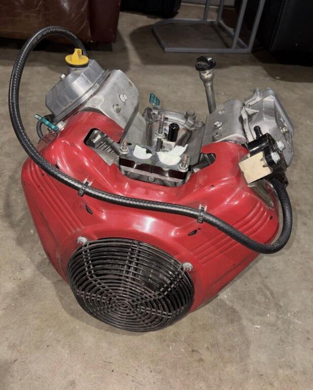

Wayne0 1,634 #18 Posted August 6 (edited) Bringing back an older thread. The motor is blowing out the carb and crank case vents big time. I'm sure it's toast. IF i DO get it started, it dies as soon as I put it under load. I have a line on a v-twin kinda local for reasonable $. Looks like a Vanguard, but with out the name. Edited August 6 by Wayne0 2 Share this post Link to post Share on other sites
ebinmaine 80,657 #19 Posted August 6 5 minutes ago, Wayne0 said: I have a line on a v-twin kinda local for reasonable $. Looks like a Vanguard, but with out the name. Interesting. What's it outta? Share this post Link to post Share on other sites
Wayne0 1,634 #20 Posted August 6 1 hour ago, ebinmaine said: Interesting. What's it outta? He said it was a Vanguard. @Echosoul has it. Connecticut, so it's not far. 1 Share this post Link to post Share on other sites
Handy Don 17,467 #21 Posted August 6 1 hour ago, Wayne0 said: Definitely a clone. You’ll want to confirm the maker and availability of parts, Share this post Link to post Share on other sites
Bill D 3,144 #22 Posted August 7 17 hours ago, Wayne0 said: Bringing back an older thread. The motor is blowing out the carb and crank case vents big time. I'm sure it's toast. IF i DO get it started, it dies as soon as I put it under load. I have a line on a v-twin kinda local for reasonable $. Looks like a Vanguard, but with out the name. If you want to stick with the boxer twin I have one I could let go of. PM me if interested. There's also one in Bristol CT on Marketplace and NOS ones on ebay. Personally I like the Briggs opposed twins. 1 Share this post Link to post Share on other sites

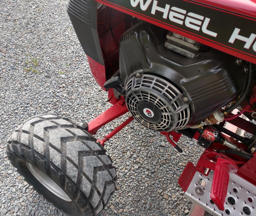

kpinnc 18,940 #23 Posted August 8 On 8/6/2026 at 6:43 PM, Handy Don said: Definitely a clone. You’ll want to confirm the maker and availability of parts, Look right to me. That's a big Vanguard, likely 21 or 23hp. The tins and double barrel intake manifold are just like my 23hp. I swapped the same flywheel screen for a recoil starter. Then I found out how hard it is to pull start a 23hp engine... The carb on mine cost more than the engine. Finding one that isn't for a vertical configuration is difficult. But they are still out there. 2 1 Share this post Link to post Share on other sites
953 nut 69,175 #24 Posted August 8 8 hours ago, kpinnc said: Finding one that isn't for a vertical configuration is difficult. Time to design an adaptor and have them 3-D printed, you could corner the market and get rich! Well, maybe cover expenses. 2 Share this post Link to post Share on other sites
